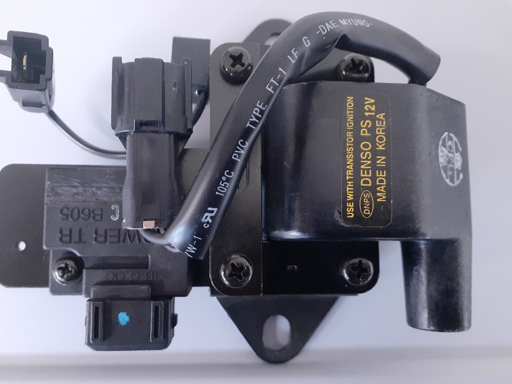

The configuration is not typical and information is limited at best. Running a single HEI coil to a hall effect (reference and sync single) sequential distributor (cap and rotor, plug wires to SP). No coil pack (waste) or COP set-up. See coil pic.

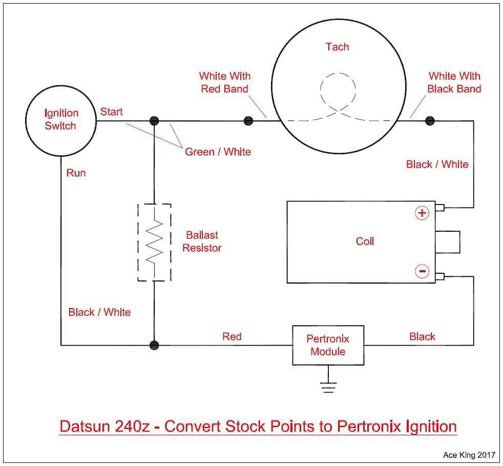

The diagrams never show the colors from the device, only the colors in the main harness.  So you'll have to use the plug to convert from device harness to main harness.

In the START position, the G/W wire goes through the tachometer and comes out B/W. The B/W wire goes to the positive on the coil.
In the ON position, the B/W wire goes to the ballast resistor and comes out G/W. The G/W wire goes through the tachometer and comes out B/W (different B/W wire than at the switch). The B/W wire goes to the positive on the coil.
The B/W wire from the ignition switch (ON position) branches off to a few different functions. The most important one is going to the fuse box. Downstream of the 20A fuse it powers the turn signals, tachometer, brake warning light, and switched source for the alternator/voltage regulator. (Note: for some of these circuits, the wire is Green, but it came from the same source.) Before the fuse box, there is also a branch off the B/W wire that is Green. It goes through an inline fuse and comes out Green. That is for the electric fuel pump. It might have been re-routed for the Nissan modification that actually installed an electric fuel pump in the North American 240Zs. (Long story...) The B/W wire also provides power for a couple of emissions related circuits, but I'm guessing you or a previous owner have defeated and/or removed most of that.
For the 240Z, the black wire off the coil is grounded by the points when they collapse.

Not concerned with the existing tach wires, will try the ECU/tach conversion provided by Duffy using the existing stock 240z tach internals
Splitting the white wires and running white/red through the ECU and white black to coil +. Sounds the solution to the old Z tach internal.
Still concerned with what to do with the coil wires / connections. The HEI coil has a external suppressor (see pic), single pin connector. Does a coil suppressor function the same as a ballast resistor?

Did the Haltech come with wiring instructions? If so, post them. It's hard to guess what you are trying to do. It would probably be easier for me to draw it up correctly for you. For the right price, I could even make a junction harness for you to plug in between the dash harness and ignition switch. Why hack into the wiring if you don't need to?
The drawing you posted on the Pertronix has a flaw that could lead to hard starting. Having a couple of diodes in the right place would give the Pertronix the correct voltage when the car is starting without trying to power the ignition circuit.

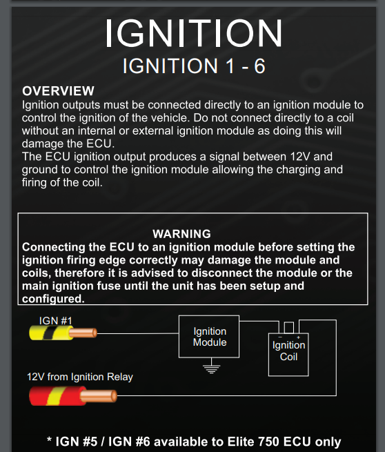

Not really clear how Haltech does their ignition.  Might want to dig in to that a little more.
https://www.haltech.com/wp-admin/admin-ajax.php?action=ht_get_file&id=5d227b76506c252c8b7fb0d1&op=1
https://www.haltech.com/wp-admin/admin-ajax.php?action=ht_get_file&id=5d351552506c25377c49fae6&op=1

Correct, ignition module required. The HEI coil pic in this post has a 3 pin igniter/ ING module (blue dot on top) integrated. All of this is straight forward, wires coming from the ECU and neg from coil.
My concern is eliminating a connection from the existing harness at the coil and ballast resistor.
