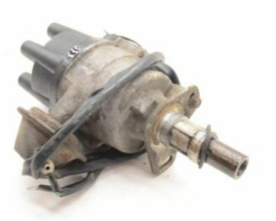

Get the #1 piston all the way up and timing marks on 0. Camshaft lobes on #1 up. Then take a picture of the camshaft spindle with the dizzy removed

Then observe the tang on the distributor drive spindle to confirm if it is in the proper position.

Thanks racer.  About the distributor drive spindle being “ in the proper position” why did someone say there really is no proper position as all it will do is change where the #1 spark plug goes. ? If by some chance someone put the spindle in wrong or off a few teeth it should still work? I don’t want to mess with oil pump. So most say it should be at 11:25 position. Is it ever anything else? By aligning my crank shaft pulley at 0 the spindle was at like 1:35. Then I rotated crank shaft pulley one revolution and marked at 0 again. Abs looked at spindle again and it was at 1:35 again.  Can the pully timing mark be different then if I take valve cover off abs try to find tdc using the timing chain mark ??

Ok zed. I will also get photos of dizzy.  Maybe it was replaced with wrong mounting  bracket or mounting bracket put on upside down or backwards.  That’s possible as well.
I still don’t get one thing. As seen in photo attached  crankshaft pully clearly seen at 0 and spindle is 1:35. I did one full rotation and marked at 0 abs pully at 0. So one of those was compression stroke right? And on both of those the spindle showed 1;35.  Why is it doing that and not 11:25?? What could be going on?
