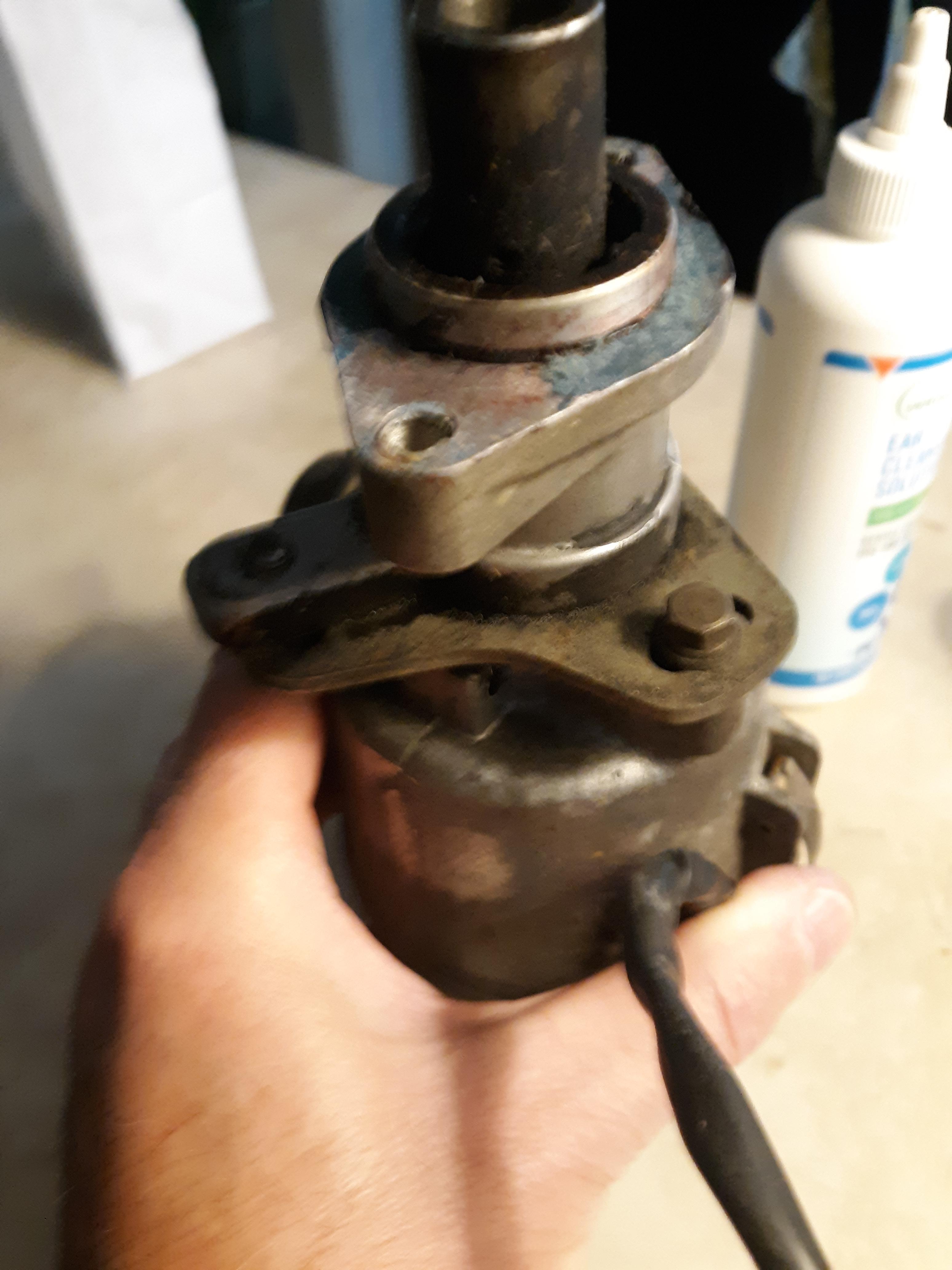

June 9, 20214 yr comment_623109 One side is smaller. That's why the distributor shaft can only install one way. Link to comment https://www.classiczcars.com/forums/topic/65481-74-260z-distributor-on-wrong/?&page=4#findComment-623109 Share on other sites More sharing options...
June 9, 20214 yr Author comment_623111 Yes zed. I know. So when I rotate engine one revolution the smaller half is on other side. But still at 1:35 position. Link to comment https://www.classiczcars.com/forums/topic/65481-74-260z-distributor-on-wrong/?&page=4#findComment-623111 Share on other sites More sharing options...

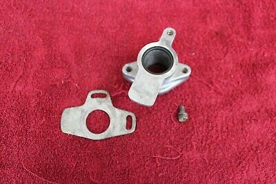

June 9, 20214 yr comment_623112 You have a 240/260 pedistal and a 280 distributor. I wonder is that compatible components? Here's what you have. Heres a 280 distributor . The timing plate and pedestal are different. Link to comment https://www.classiczcars.com/forums/topic/65481-74-260z-distributor-on-wrong/?&page=4#findComment-623112 Share on other sites More sharing options...

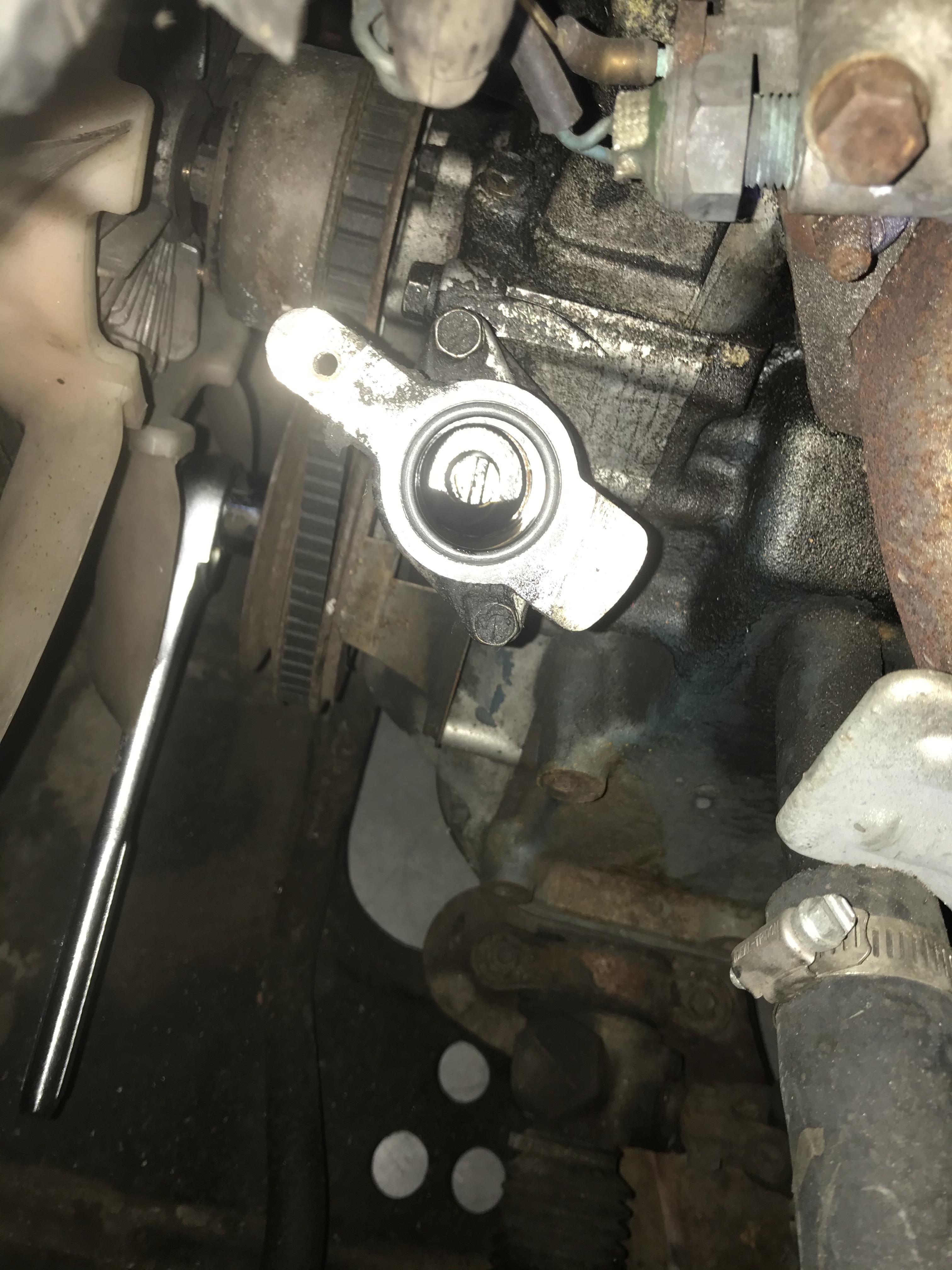

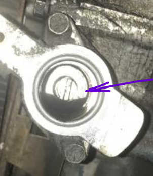

June 9, 20214 yr comment_623116 25 minutes ago, Shawninvancouver said: Yes zed. I know. So when I rotate engine one revolution the smaller half is on other side. But still at 1:35 position. Before you rotated the engine one revolution, was it at top dead center? Link to comment https://www.classiczcars.com/forums/topic/65481-74-260z-distributor-on-wrong/?&page=4#findComment-623116 Share on other sites More sharing options...
June 9, 20214 yr comment_623117 21 minutes ago, Shawninvancouver said: Yes zed. I know. So when I rotate engine one revolution the smaller half is on other side. But still at 1:35 position. One rotation puts the engine on the opposite cycle or stroke. It's a four cycle engine. Compression (up), combustion (down), exhaust (up), intake (down). There are two cycles per revolution. The reason the small side needs to point a certain way is so that you can get the rotor in the distributor to point at the #1 cylinder on the compression stroke so that the spark will light the fire. If it's pointed the other way the spark happens during the exhaust stroke, where nothing will happen. https://en.wikipedia.org/wiki/Four-stroke_engine Link to comment https://www.classiczcars.com/forums/topic/65481-74-260z-distributor-on-wrong/?&page=4#findComment-623117 Share on other sites More sharing options...
June 9, 20214 yr comment_623118 34 minutes ago, Shawninvancouver said: In this picture, is the piston at #1 top dead center on the compression stroke? Oh, and one picture is enough. We don’t need to see 4 pictures of the same thing. Edited June 9, 20214 yr by Racer X Link to comment https://www.classiczcars.com/forums/topic/65481-74-260z-distributor-on-wrong/?&page=4#findComment-623118 Share on other sites More sharing options...
June 9, 20214 yr Author comment_623124 19 minutes ago, Zed Head said: One rotation puts the engine on the opposite cycle or stroke. It's a four cycle engine. Compression (up), combustion (down), exhaust (up), intake (down). There are two cycles per revolution. The reason the small side needs to point a certain way is so that you can get the rotor in the distributor to point at the #1 cylinder on the compression stroke so that the spark will light the fire. If it's pointed the other way the spark happens during the exhaust stroke, where nothing will happen. https://en.wikipedia.org/wiki/Four-stroke_engine Ohhhh shoot. That I did not know. I just assumed there were two strokes. Up and down. So I tried once. Then did one revolution and tried again. I need to do this with valve cover off. That helped me out a bunch. Thanks for being patient. Link to comment https://www.classiczcars.com/forums/topic/65481-74-260z-distributor-on-wrong/?&page=4#findComment-623124 Share on other sites More sharing options...
June 9, 20214 yr Author comment_623126 20 minutes ago, Racer X said: In this picture, is the piston at #1 top dead center on the compression stroke? Oh, and one picture is enough. We don’t need to see 4 pictures of the same thing. That I don’t know. I need to do it with valve cover off. Abs I look for piston up and cam lobes pointing up. ?? That’s all I need to see for tdc? Or do I also need to look at valves. ?? Link to comment https://www.classiczcars.com/forums/topic/65481-74-260z-distributor-on-wrong/?&page=4#findComment-623126 Share on other sites More sharing options...
June 9, 20214 yr comment_623127 2 minutes ago, Shawninvancouver said: Ohhhh shoot. That I did not know. I just assumed there were two strokes. Up and down. So I tried once. Then did one revolution and tried again. I need to do this with valve cover off. That helped me out a bunch. Thanks for being patient. Suck, squeeze, bang, blow. Four events. Four strokes. Read the stuff at the link. https://en.m.wikipedia.org/wiki/Four-stroke_engine Link to comment https://www.classiczcars.com/forums/topic/65481-74-260z-distributor-on-wrong/?&page=4#findComment-623127 Share on other sites More sharing options...
June 9, 20214 yr comment_623128 3 minutes ago, Shawninvancouver said: That I don’t know. I need to do it with valve cover off. Abs I look for piston up and cam lobes pointing up. ?? That’s all I need to see for tdc? Or do I also need to look at valves. ?? You can see the cam lobes through the oil fill hole. Link to comment https://www.classiczcars.com/forums/topic/65481-74-260z-distributor-on-wrong/?&page=4#findComment-623128 Share on other sites More sharing options...
June 9, 20214 yr Author comment_623129 Ya. But can’t see piston up. I’m just gonna take cover off. I need to get to the bottom of this. Link to comment https://www.classiczcars.com/forums/topic/65481-74-260z-distributor-on-wrong/?&page=4#findComment-623129 Share on other sites More sharing options...
June 9, 20214 yr comment_623132 You need to remove the spark plug to check if the piston is all the way up Link to comment https://www.classiczcars.com/forums/topic/65481-74-260z-distributor-on-wrong/?&page=4#findComment-623132 Share on other sites More sharing options...
