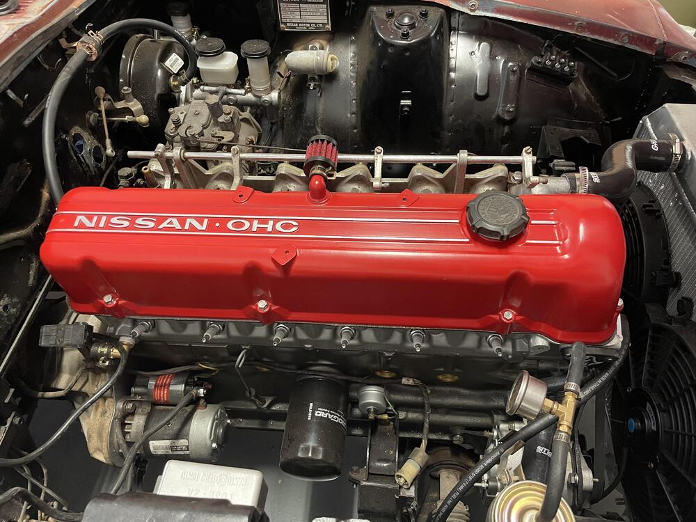

I know I said I wasn’t going to do work on the Z because of the holidays, but maybe this counts as holiday decorticating?😅
I felt the bay needed a splash of color

I’ve been able to find the studs needed to mount the mikuni manifold. Cleaned and painted it as well. Can’t wait to clean up the carbs next.

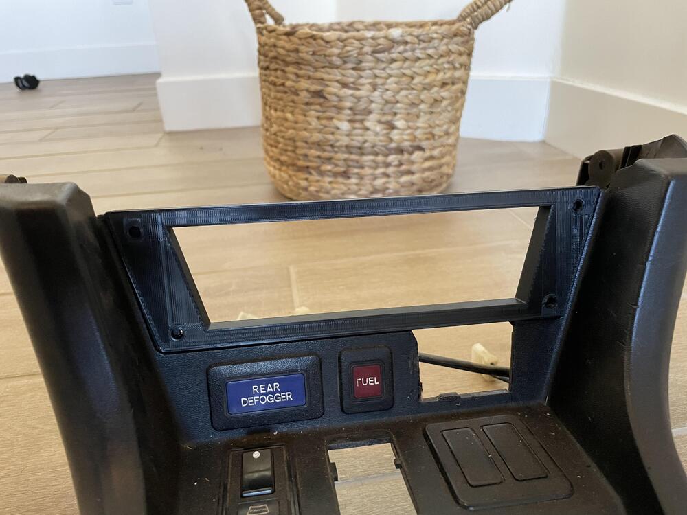

I’ve been playing around a lot with the 3D printer. I created a faceplate adapter for my switch panel. Slides into my center console and I will be able to screw on the actual switch panel to this adapter via the four screw holes. Looking at original center consoles online, it looks like mine was hacked up for an aftermarket radio at one point so it was missing the upper material. This new adapter should add back in some rigidity. 6986A937-D1AC-4F15-B36A-37F85562A7FA.jpeg

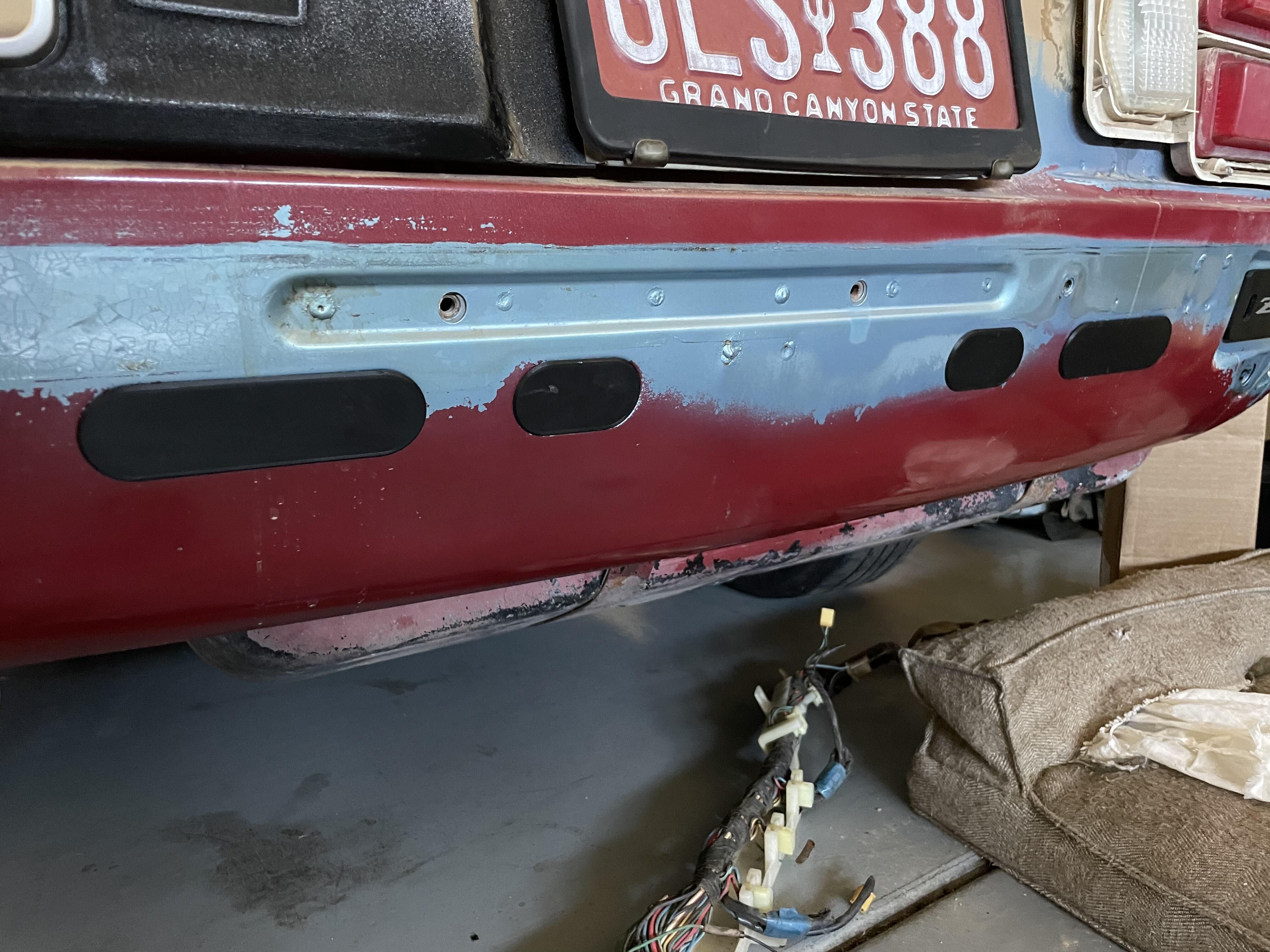

I also toyed around with some filler plates for the rear bumper. I know the proper way is to weld in blanks, but this was just a fun side project 🙂 they clip in and are fit very nicely!

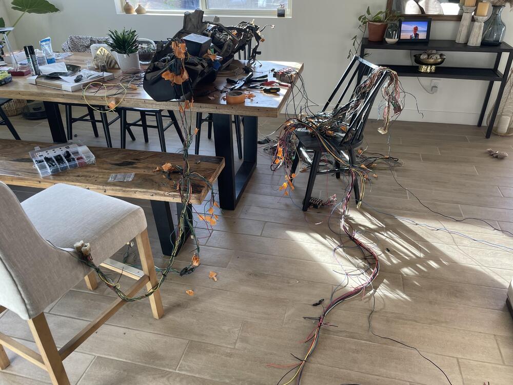

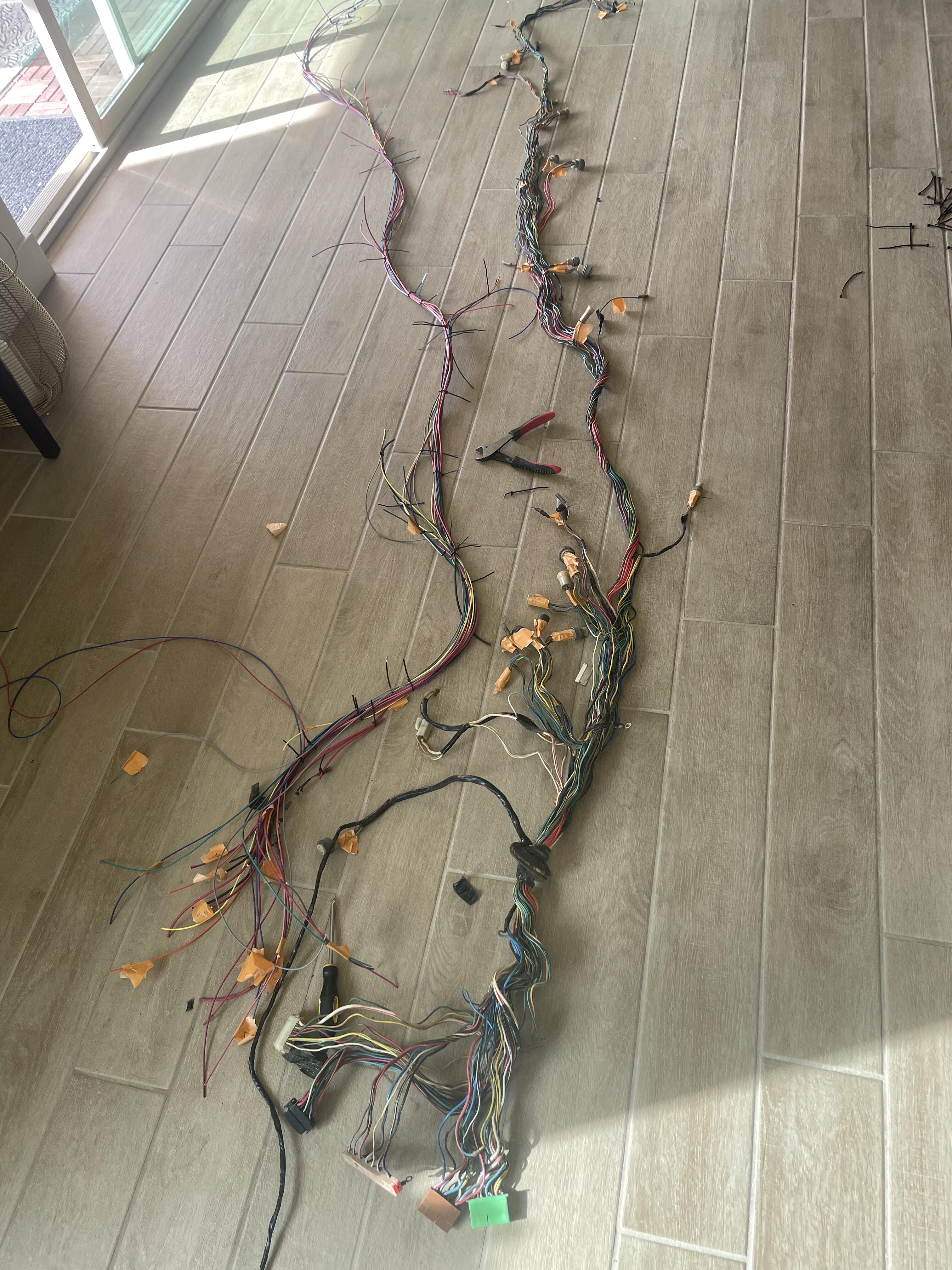

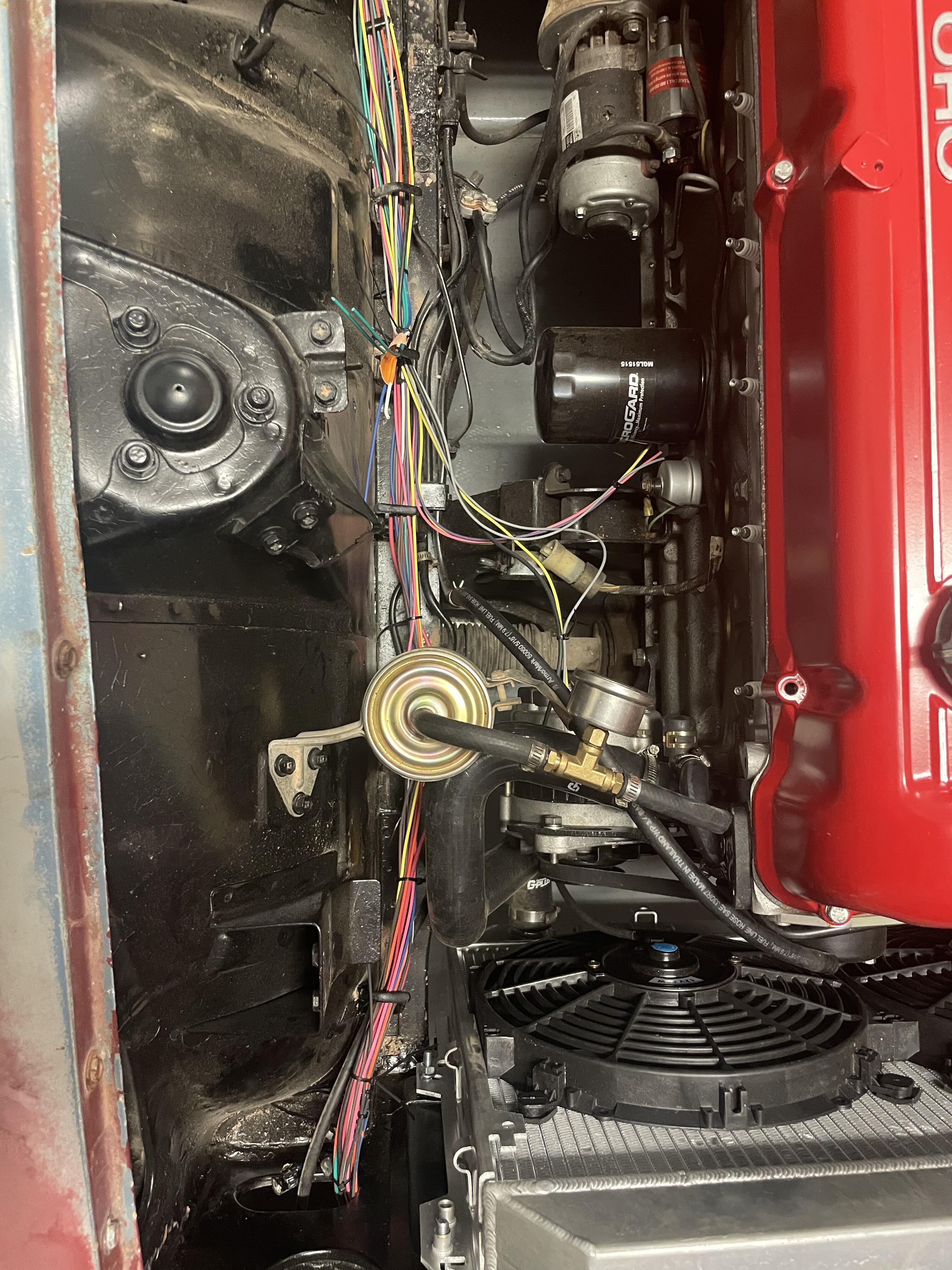

And then the big project of wiring has started. The engine bay is getting a full new harness, then I am creating adapters to plug into the dash and body harness. Originally I wanted to redo the full body harness as well but all of the connectors inside were fine.
Laying out the harness side by side for lengths.
Organized chaos! Luckily, my wife is out of town this week so I’m taking advantage of making the dining room a workshop for a bit.
Test fitting in the bay before I start adding plugs! So satisfying to see it come together.

Im about 80% done with the fuse box side of the harness. A few small fused items left to run and then I can start working on connecting the engine bay side. During this I deviated from my original schematics so I will be needing to update that for future reference. I removed my shunt, externally regulated alternator, and all original relays/flashers. I won’t be running my amp meter, instead going for a volt meter. All relays are now modern bosch style, albeit the micro 280 series size to fit within my distribution block. I have a main 125amp circuit breaker in place, continuous duty relay  as a main power trigger, and all new weather pack connectors with GXL wire.
There a few circuits I’m slightly confused on so I’ll need to finish those up in car to trace all of my leads accordingly. Surprisingly I barely used my schematic I made. I used the OEM wiring diagram more often. Maybe I need to trust myself more 😉

Any chance you’d be willing to print up a set of rear bumper plates. Something I thought about but don’t have a printer.
Thanks @Av8ferg! I will totally print up a set of the bumper plates. One thing I am wondering is, are all bumper cut outs the same size? I only have my '75 to measure. If you get a chance, can you let me know the dimensions of one larger and one of the smaller cutouts? Just want to make sure before I send something that doesnt fit 🙂

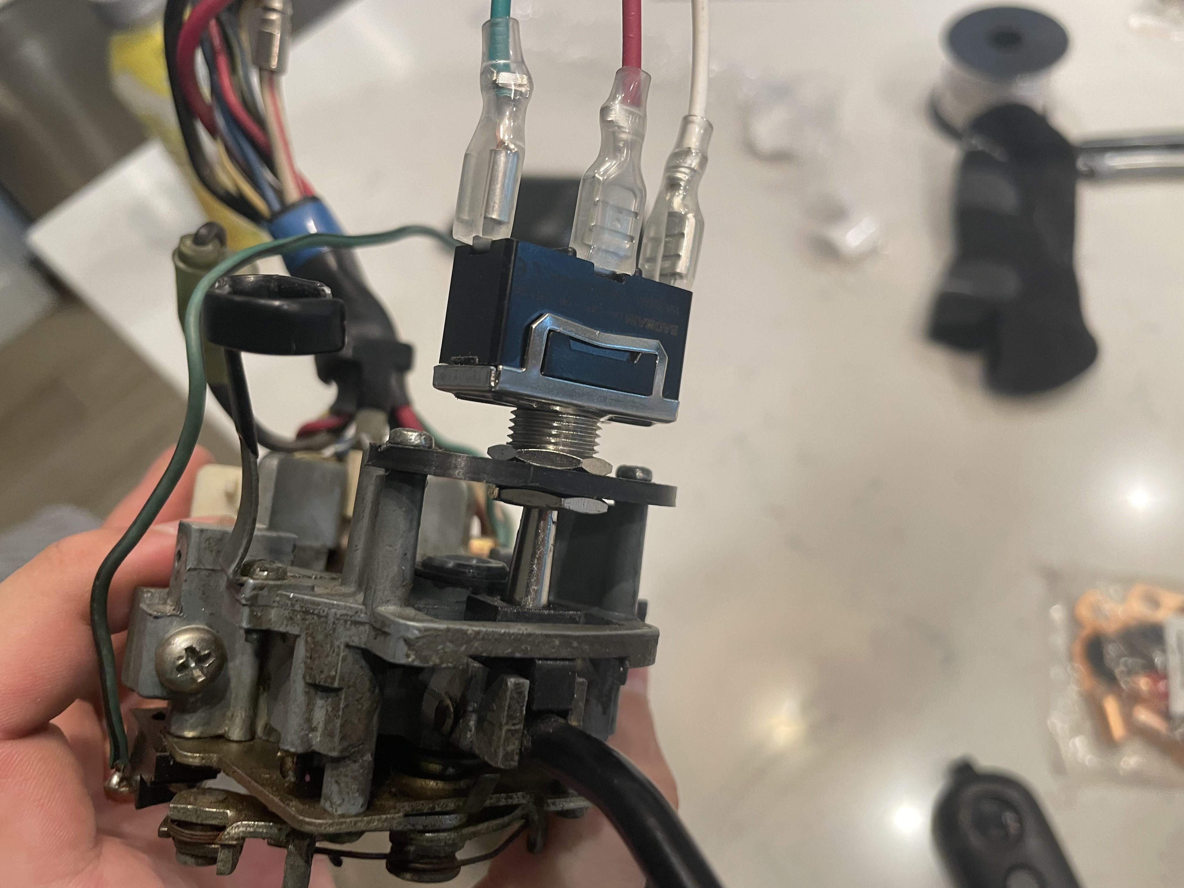

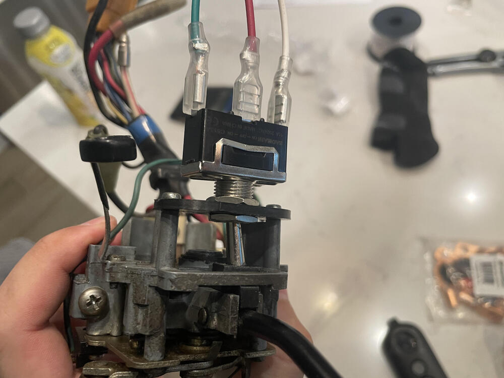

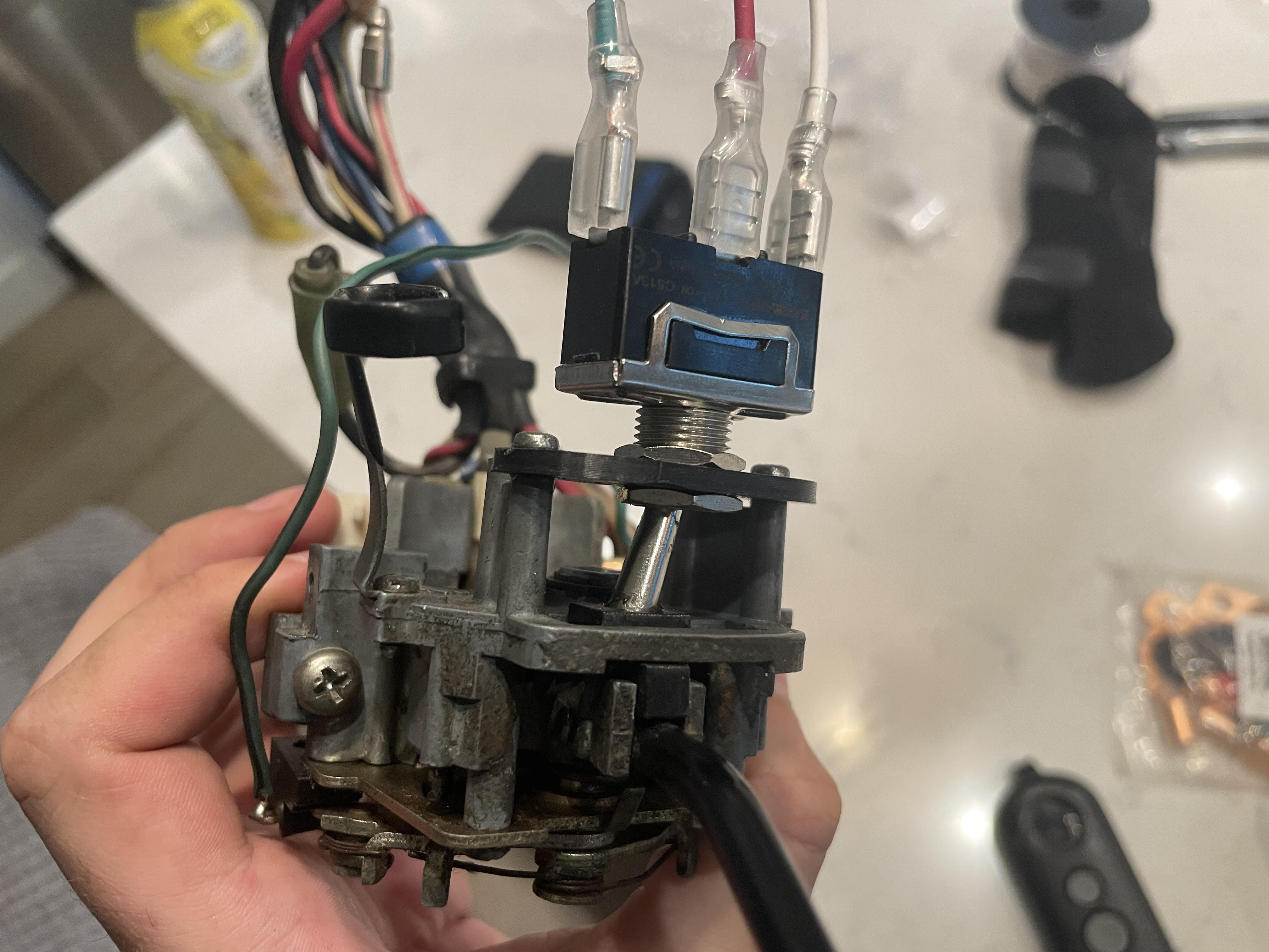

So many lessons learned and I cant wait to share them all with you when I am finished. But for now I was working on fixing my turn signal stalk. The PCB board was so brittle that when I disassembled to clean the contacts, it was just falling apart. I was a bit upset that it came apart and I started to look into replacements. I really wanted to keep the OEM stalk and not go aftermarket. Everything was fairly pricey though, so I looked into fixing myself. I found this thread on HybridZ where a toggle switch accomplishes the same function of the OEM switch. A quick print for a bracket and new slider and boom, we're back in business!
The switch in the Off position:
Then each direction works flawlessly. It retains the nice CLICK as well.
Dan, you are clearing the trail for me.  My turn signals don’t work either, I haven’t tried to diagnose the problem yet.  I have bigger fish frying right now and the back burner is smoking.  I have too many Z task I’m working on….I’m trying to focus 🧘 .

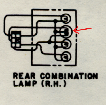

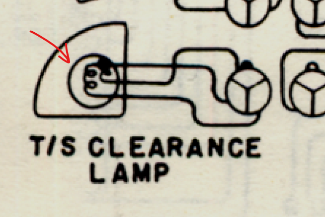

The front lights have dual filament bulbs. One filament has a lower light level than the other. If you look in the BE section, you'll see the original bulb spec. It's 1034. I was just looking at some original dual filament bulbs last night.
When you look at the wiring diagrams, you'll see two loops in the bulb where you have a dual filament.
There's also a dual filament bulb on each side of the rear panel.
