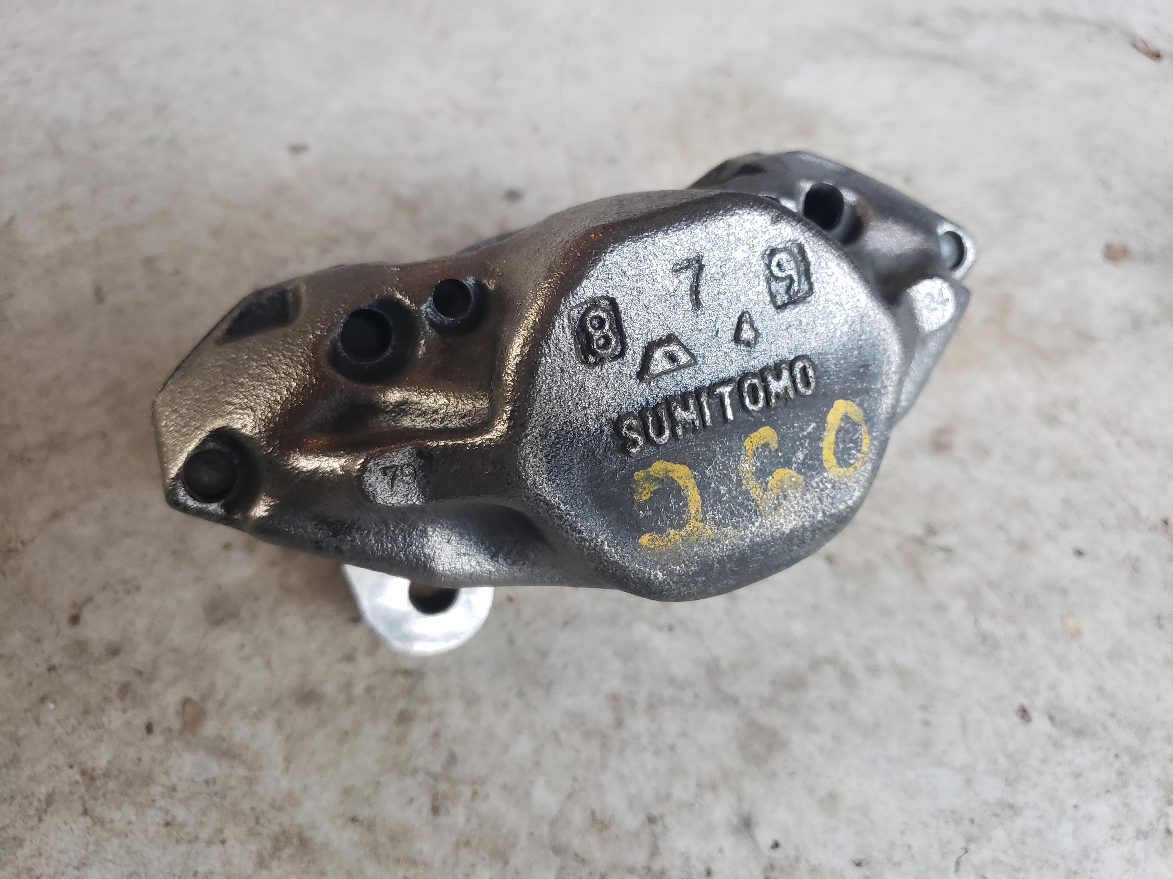

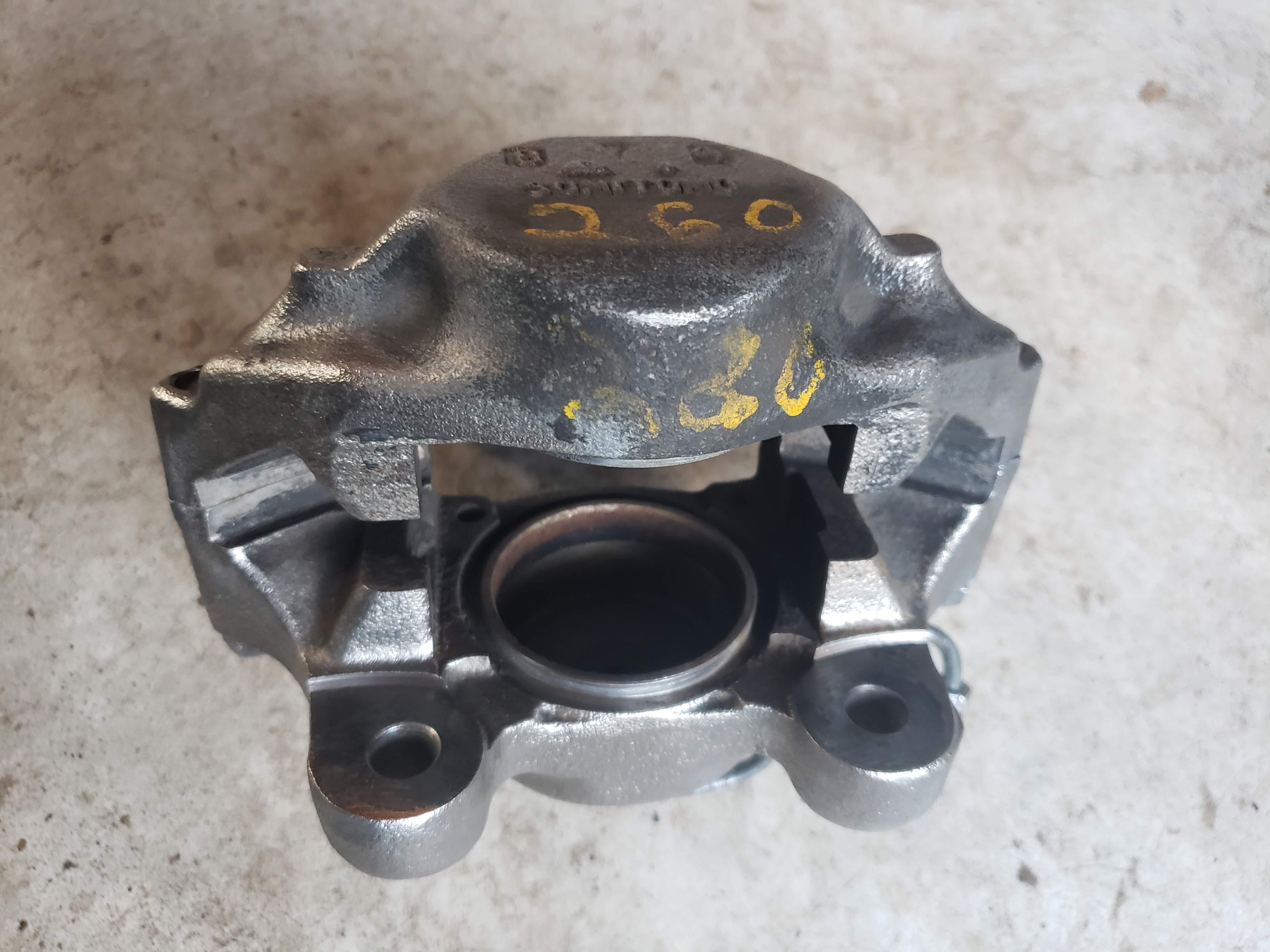

15 hours ago, Mark Maras said:
 I'd guess it's a used replacement.
Makes some sense. The caliper from the other side was much more rusted, but I'd noticed that all the suspension parts from one side are in worse shape than the other. There was a very noticeable difference between the calipers, though, so I think this one was a replacement. Hopefully I'll never have to separate the two sides of it. Looks like someone once tried to do it and made a real mess of one of the bolts. All the parts I ordered from Rock Auto have now made it to the cross border shipping location, so hopefully I'll receive them next week and get on with this!
I think there are some minor casting differences between the 240Z and the 260Z/280Z calipers, but they all use the same revision sets, brake pads and the pistons are the same.
With the pistons and brake pads being the same, you should not have any issues using any combination of calipers. Aftermarket kits have the sealing ring between the halfs, but Nissan does not supply them.
Same for the chewed up bolt holding the two halves together. If you want to rellace it you will be in the aftermarket parts. Nissan reccomends replacing the complete caliper if you need split then apart for any reason.
Thanks @EuroDat. I noticed that the Haynes manual says the same thing about replacing the caliper. I don't see any reason to split it, anyway, fortunately!
