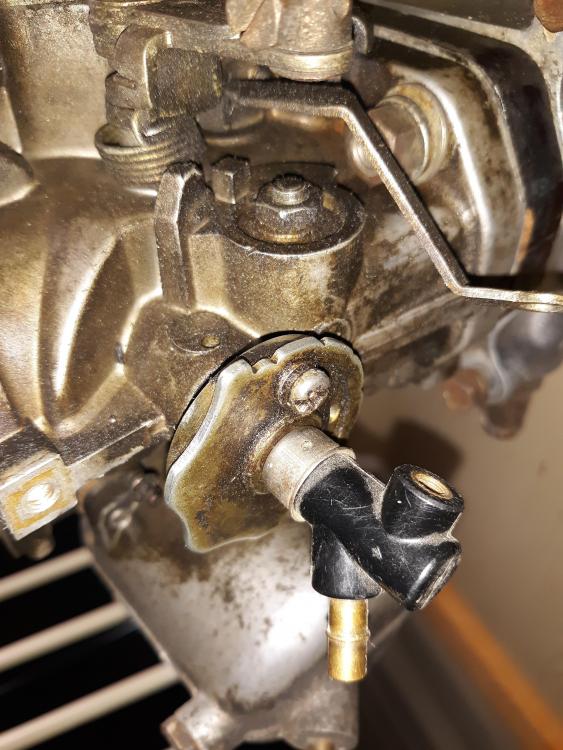

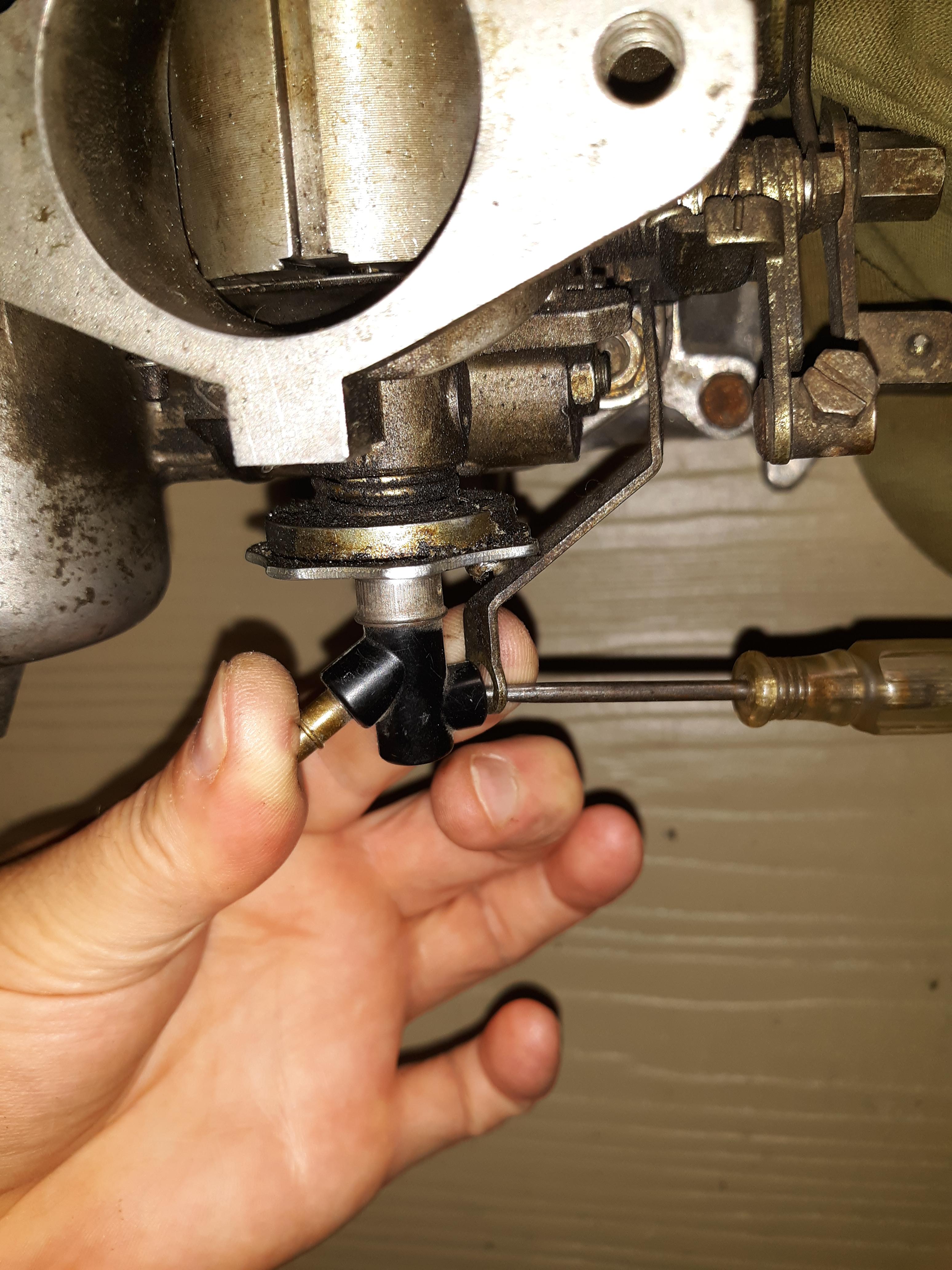

17 hours ago, Alex240z said:
Only issue with that method I found is I have a plate under the locking nut that stop it’s from going lower. I don’t know if it was set wrong or what because it’s adjustable. But if I try to do 10 full turns (not sure if it’s half or full) it just stops around 4 1/2. After a search of 4 screw carbs I couldn’t find one with the stopping plate.
Just guessing. I'm bored, maybe you can only go 4.5 down is the linkage is stopping it. In this photo where the scribe is in the hole one the nozzle and through the hole on the connecting flat bar. If you take that screw out it'll go down 10 with ease. If the screws in you'll have resistance from the linkage springs and what not.
And that plate I think Mark is talking about has a screw in it to keep it in place.
The reason for this screw from all I've read is to turn the knob all the way up untill snug then use that screw to adjust dead center up.
Edit. It has something to do with the makers on the knob. I used a Sharpie on mine.

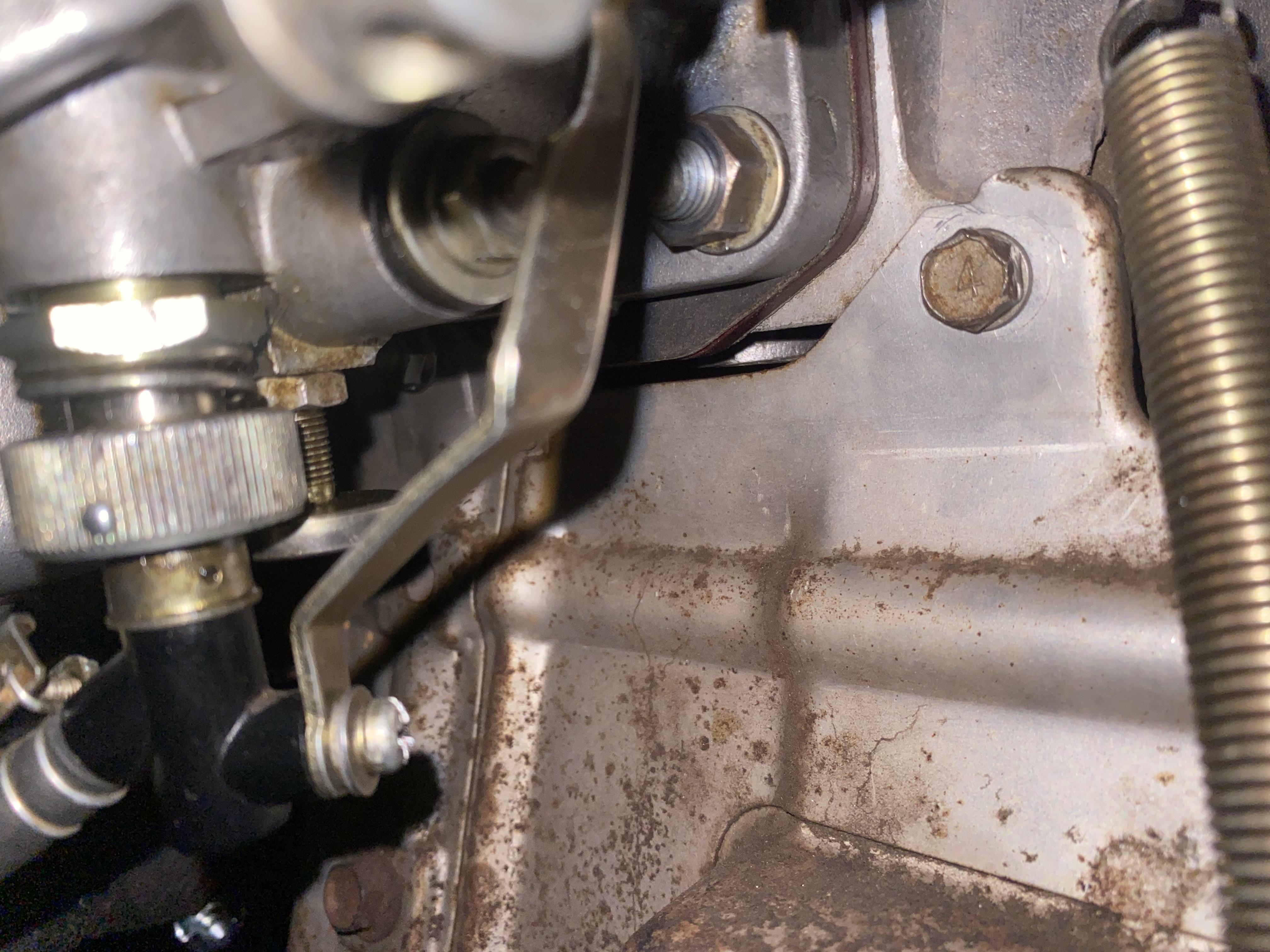

I believe those limiter bolts are just an attempt by Nissan to keep you from turning the knobs "too much". Kinda like the limiting caps on carburetor adjustments where they don't want you messing with them "too much".
And in 72, they took that idea even further limiting the adjustment even more. Those are the funky large knobs on the underside of fhe 3-screw round tops.
Here’s a photo
