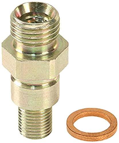

Thanks Chas.  I appreciate the offer, but I agree that we don't have time.  Do you have a part number by any chance and a picture of yours?  Maybe I can find one locally or on Amazon.  I know there used to be a Volvo one, but those seem to be NLA as of 10+ years ago just like the Nissan OE one.
EDIT:  I found something on Amazon that is interesting.  It's a Bosch fuel pump check valve https://www.amazon.com/Bosch-1587010539-Fuel-Check-Valve/dp/B001CO2MYK and one of the reviews said that it was a direct fit for his 1975 Datsun 280Z.  The picture shows a threaded inlet though.  Isn't the OE check valve only threaded on the pump side and barbed on the inlet side?
I don't think it would arrive in time anyways even if it's the right one.  Amazon shows it arriving around the time the car ships.

The original check valve is screwed into the outlet side of the pump. So in "circuit" it's installed between the pump and the rail, not between the tank and the pump.
That said, for a quick fix, I think you could put something right before or after the filter. Putting something up in the engine compartment would certainly be faster and easier than dealing with anything underneath the car back by the tank.
