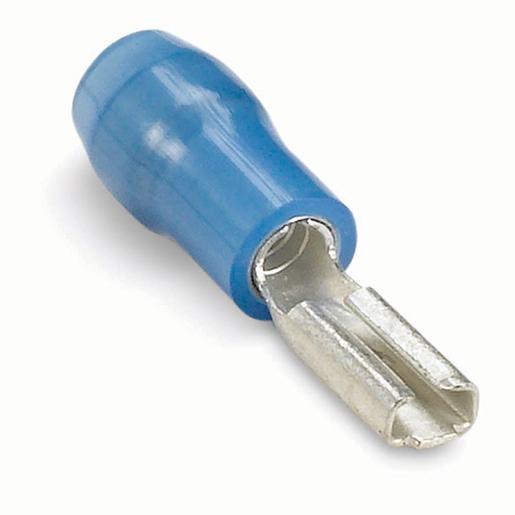

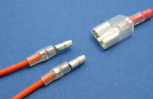

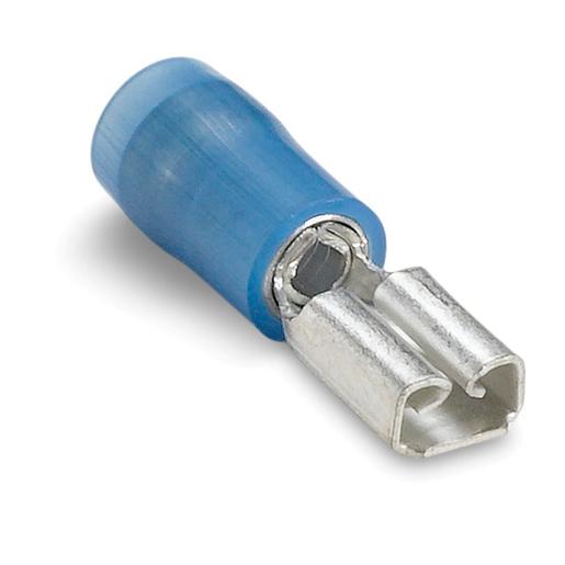

This can join them... some pliers and patience may allow you to bend a north american sta-kon connector to do the tick.
https://www.polevolt.co.uk/acatalog/1083-195.jpg
North America Types:
THOMAS & BETTS RBD14-182 | RBD14-182 T&B STA-KON FEMALE DISCONNECT |  Westburne
THOMAS & BETTS RB14-110F | RB14-110F T&B STA-KON FEMALE DISCONNECT |  Westburne

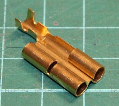

New female/female bullet connectors are one of those difficult things to find,  Vintage Connections is a great source but you could also try,  http://www.easternbeaver.com/Main/Elec__Products/Connectors/connectors.html
He has some great old style connectors and is a good seller to deal with.
Although not Nissan looking these are still retro looking,  scroll halfway down the page. http://www.easternbeaver.com/Main/Elec__Products/Connectors/Bullet_Connectors/bullet_connectors.html
