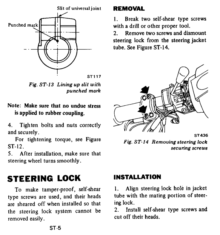

Here's some stuff on the steering lock.  Can't remember exactly how it works but you will need this anyway if you don't have the key code.  You'll need some tools to shave off the head of the tiny screw that holds the ignition cylinder on.

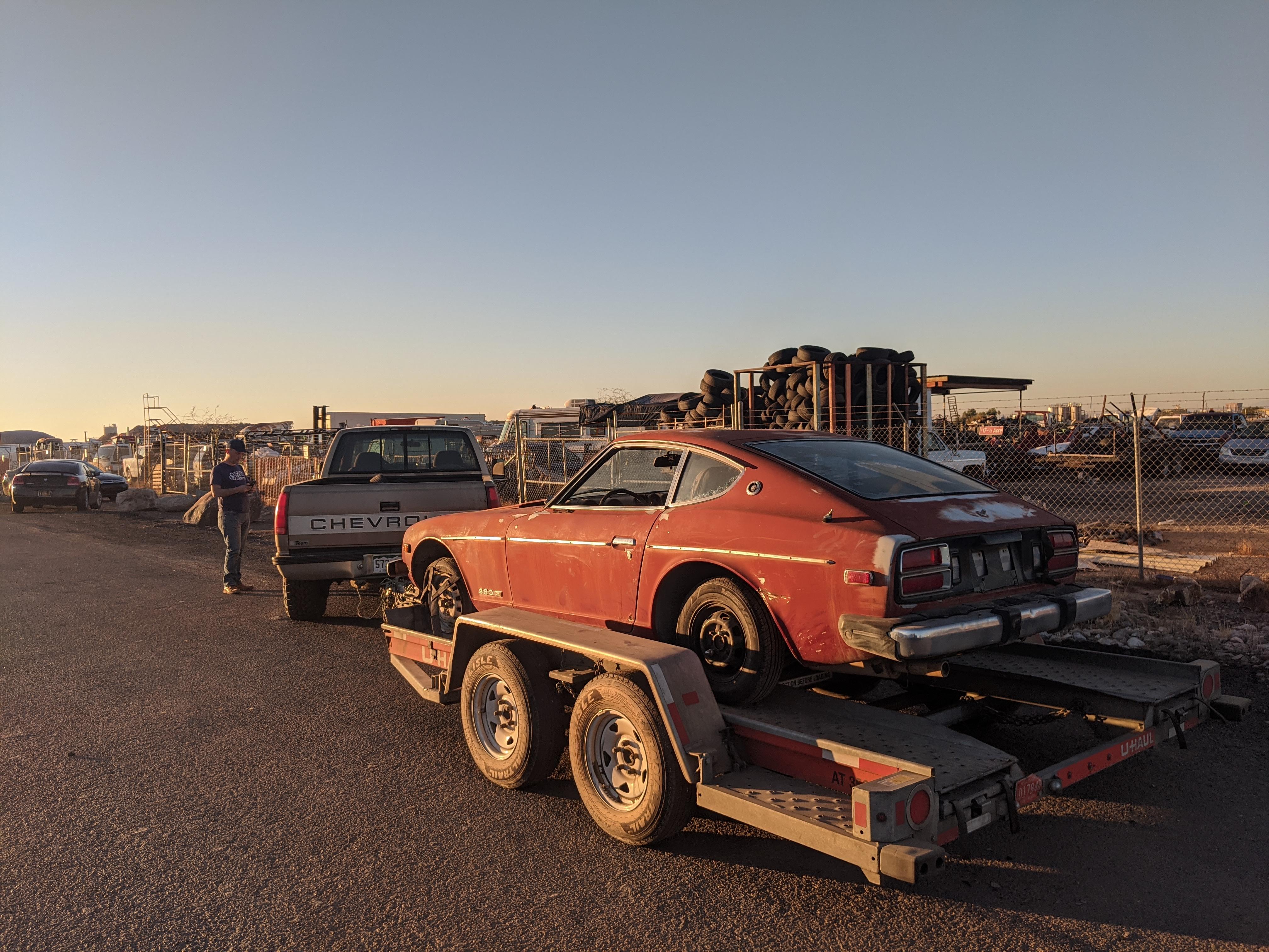

Made it onto the trailer thanks all for the tips gonna be getting a locksmith to make the key when I get home thanks all for the help I am sure I will need more when I start this project. Excited for my first z
