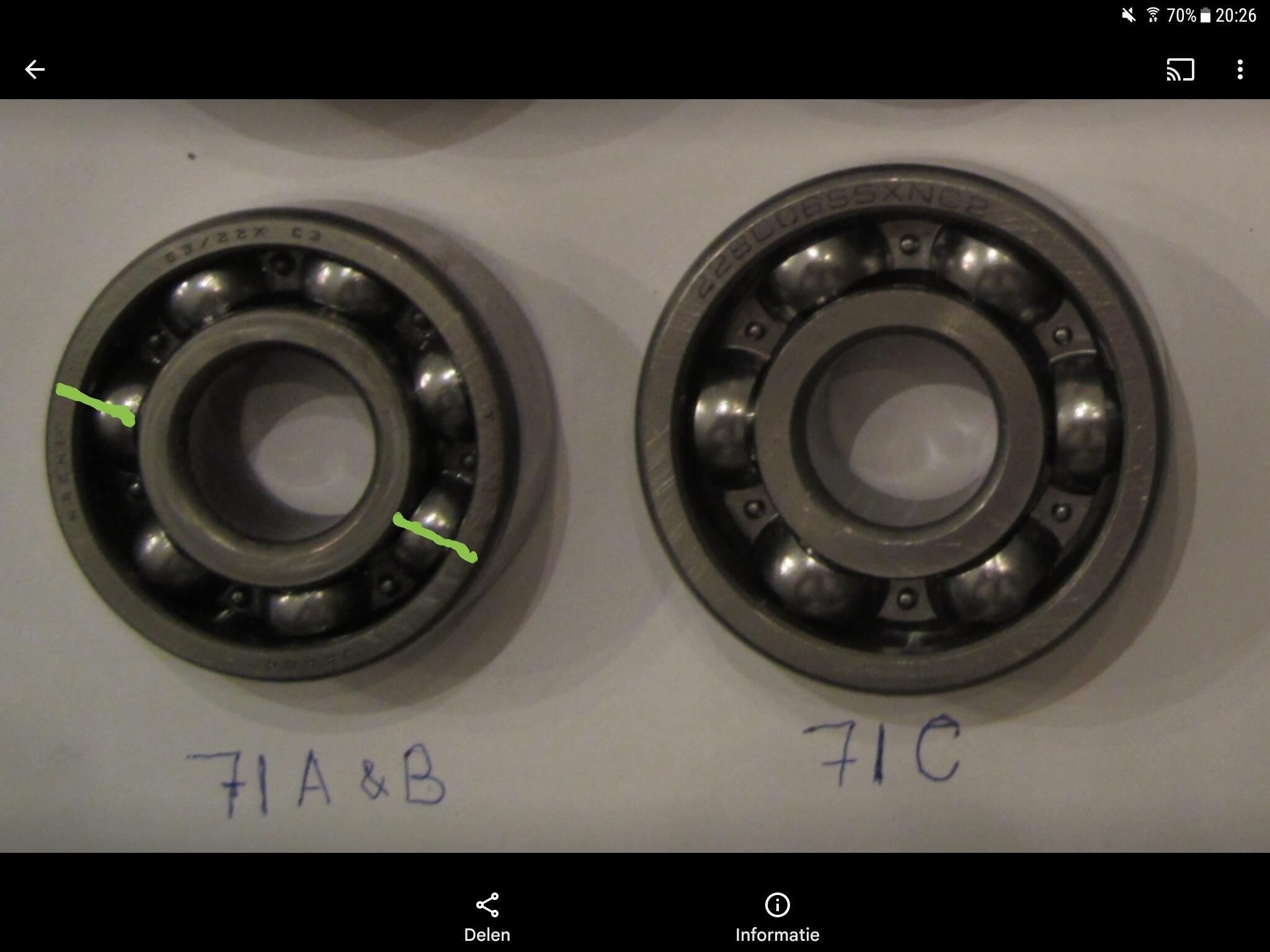

The picture seems to show that it rides on both races but I thought it only contacted the outer.  Could be wrong, can't remember.

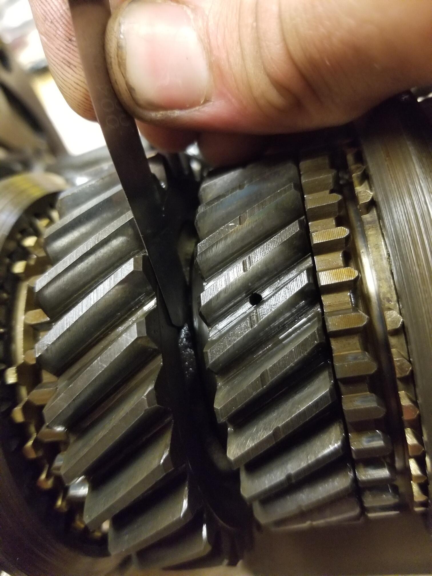

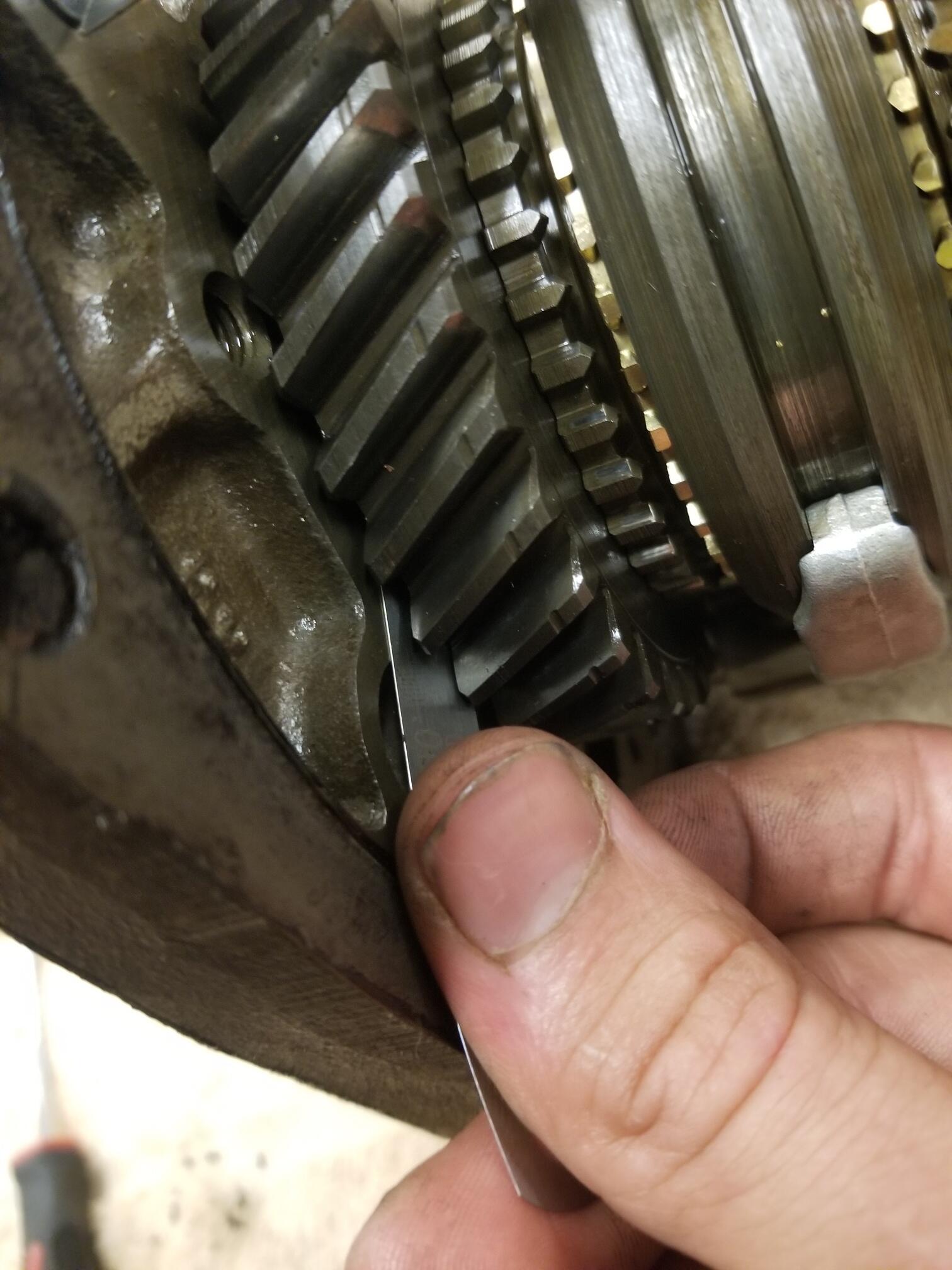

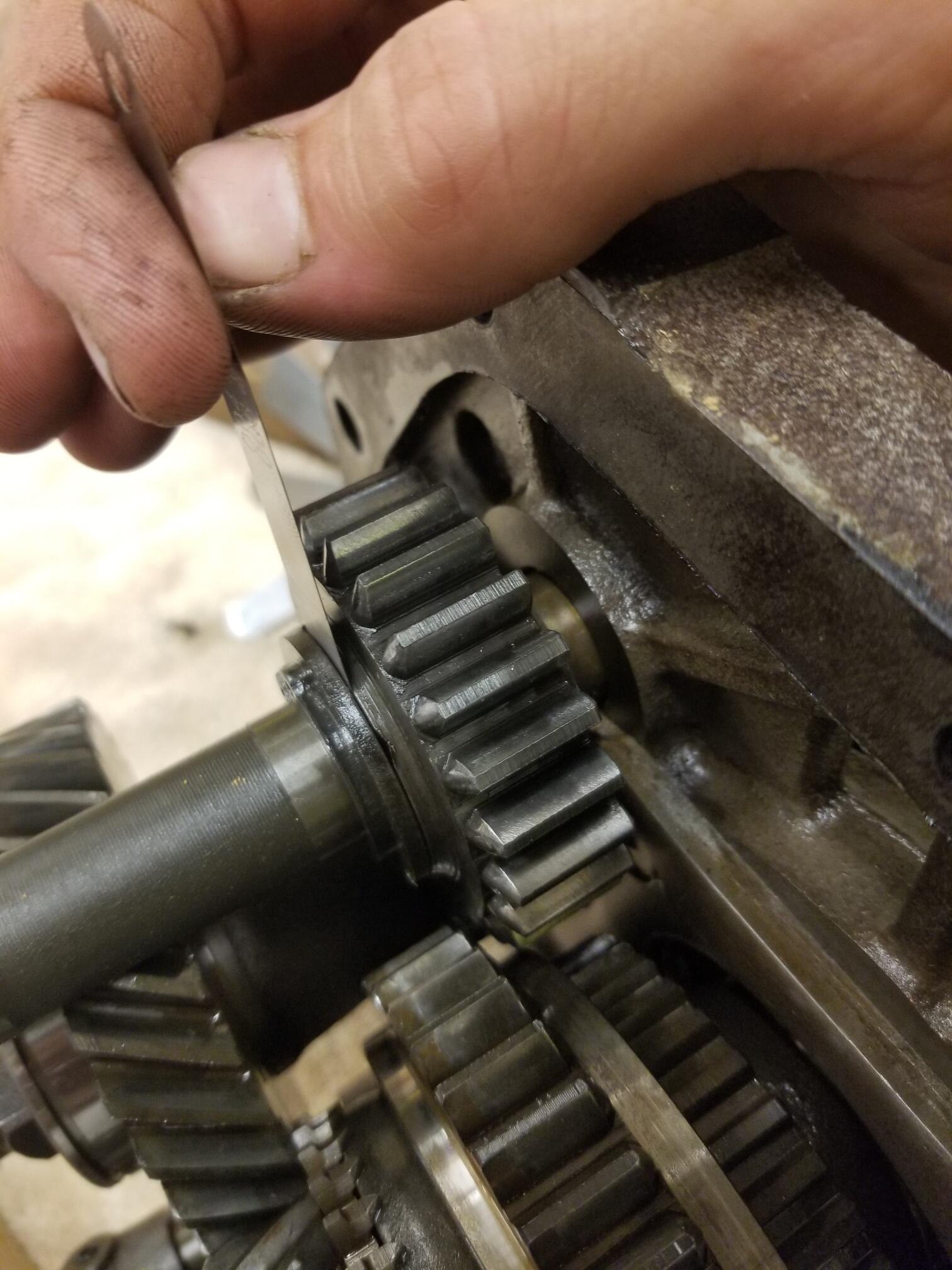

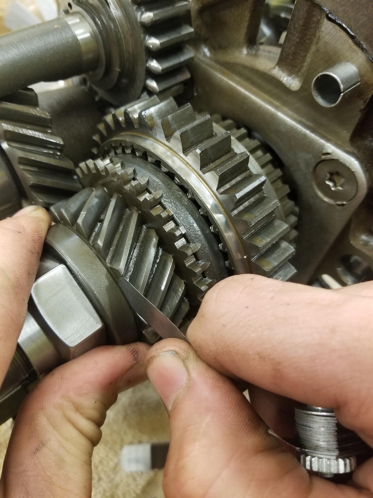

So can somebody confirm that I am checking these in the correct spots?
1st gear
2nd gear
3rd gear
We don't have enough clearance on this side of the gear but there is extra on the front side between the bearing and clip
5th gear
We do not have enough clearance at this location. We only have 0.0025" versus min .0122"

The clearance on 5th gear is very tight and will probably cause lubricating issues

Also how do you adjust the rear clearance. You torque the nut to spec but then I don't have enough clearance. Do you then back it off?
Are the other locations the proper places to check?
Do we need to move the large bearing forward to get the clearance on the backside?

Easiest way to gain the right clearance on the rear gear is to add a shim between the large washer (in your photo you are holding it with your finger and thumb). If you buy the thin brass shim stock you can cut a washer with a good pair of scissors. Add the shim stock to the gear side of the washer to add clearance.

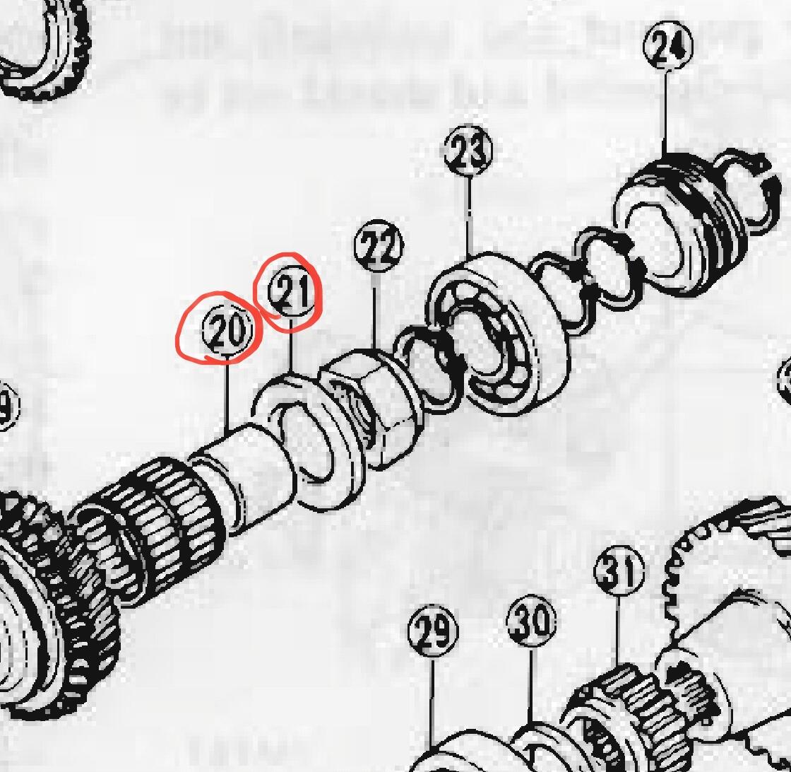

The fifth gear clearance can be corrdcted by adding shim stock between the washer (pos 21) and overdrive gear bushing (pos 20).
Shim stock thickness 0.01 (0.25mm) is easy to cut with tin cutters.
You could try to find shim washers the right size. Google "shim washers din 988". Go for the right inner diameter if you can't find one with the right dimensions. Trimming the outer diameter is easier than the inner diameter.
