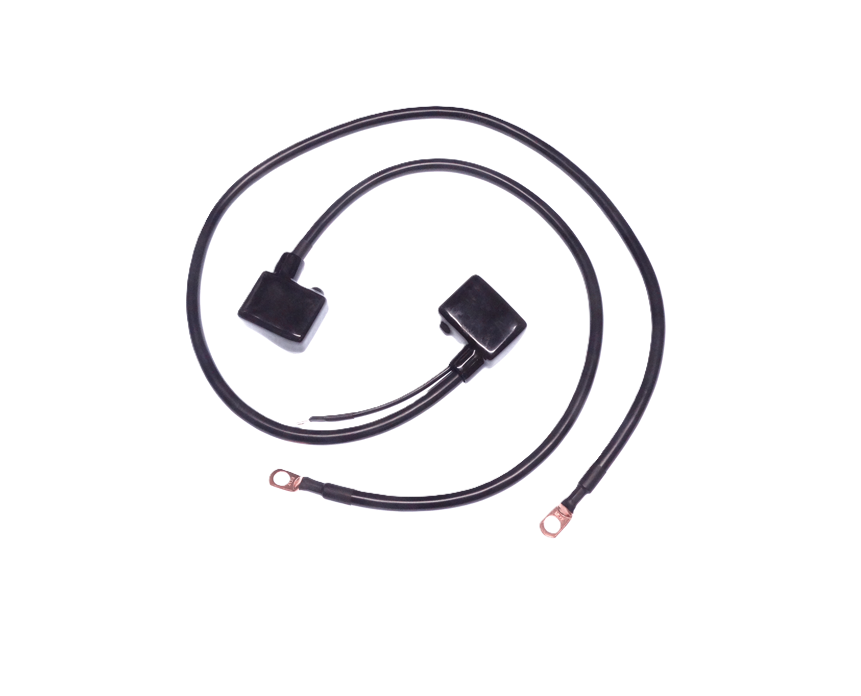

Steve at '240zRubberparts' shows a reproduction cable set as out of stock but they are available on the bay for the same price Steve was asking. I bought a set a long time ago and they are perfect.
I don't think they are quite perfect @26th-Z there was no protective cover on the negative terminal on the early 240Z, just on the positive side to stop a short with the inspection cover.
Here are the original Nissan parts fresh out of their bags. Note the negative side only has the protective rubber cover. Yazaki was the supplier and their name is screen printed on the cables, just like on original spark plug wires.

On 8/4/2025 at 10:07 AM, SpeedRoo said:
I don't think they are quite perfect...
Yea, well take the cover off. They don't have the Yazaki labels either.
I know you are a stickler for details @26th-Z so happy to help.
I'm loosening up in my old age
