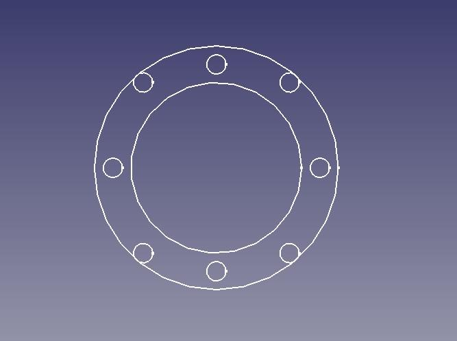

And here's what I was talking about maybe not having enough meat with a 100mm OD. Here's a quick sketch I threw together...
100mm OD, 70mm ID and two sets of bolt holes. One on a 60mm square and the other on a 60x70mm rectangle. All with the centers concentric. It looks to me like you might have some troubles with some of the holes being to close to the edge:
So I don't know if the bolt pattern for the 350Z throttle body is 60x70, but I just used what I could discern from your ruler pics earlier. It looks like trouble.

When I get home, I'll draw the bolt holes for spacer to manifold and eThrottle to spacer...
It’s 130mm around and 40mm wide. The bore is 70mm. I have modeled the holes but haven’t gotten it to the point I can post it here. My son knows someone in the UNR Engineering Prototype Lab so we may go make it tomorrow...
one thing is for sure, it would be a lot less complicated if the eThrottle had a square bolt pattern!
