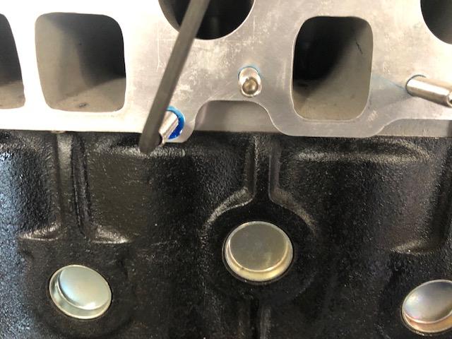

Today, I did something really boring but necessary. I chased threads in the cylinder head. It is an E31 head that was ported and polished in the '70's by BC Gerolomy. Those of you who know your Datsun history will know who that is as he did the heads for the first cars that raced in the country. It already had big valves so I saved some money at Rebello because all they had to do was clean it up.

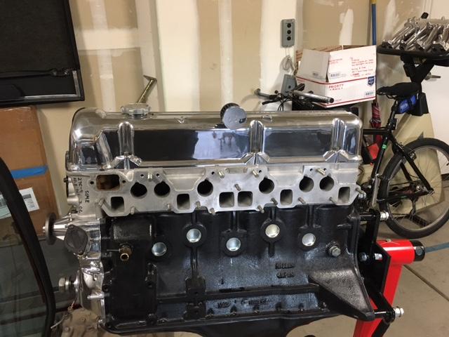

Here is the engine. As I said above, Rebello 3.0. The cam is 27C-9, which I don’t know what that means in terms of lift and duration but I had asked Dave for a EFI street motor with some grunt. The compression is 10.2:1 so that cam will have to bleed off some compression for pump gas. The car will use a Haltech Elite 2500 for brains so you know I follow Duffy Mahoney every time he posts!

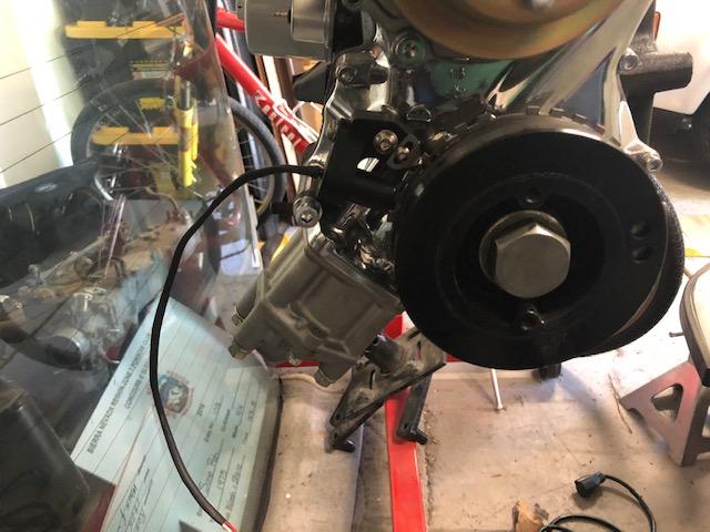

Here is the trigger wheel that will tell the coils what to do... It's an Austin Hoke product.
On the suggestion of others, I got the ZCarDepot exhaust kit which has stainless steel studs with 4mm allen head in the end so I can seat them positively. I also used Threadlocker Blue Gel to hold them without a death grip.
It occurs to me that I may have trouble getting the intake or header on with the thermostat housing in place. Anyone know?
Sometimes they do interfere with one another, I've had to grind a little off the Tstat housing in the past.
If you don't mind measuring, what is the length of those studs, and the protrusion from the head?
Well, I'm not going to uninstall one to check that but I'll try to get a measurement on the exposed thread for you. They average just on the short side of 1 1/4".

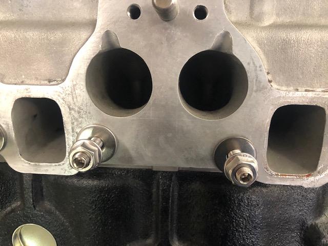

I'm not sure anyone has noticed this yet, but the head had to be modified for injectors. Unlike Duffy, I am using a stock(ish) '75 intake manifold that has been extrudehoned. Otherwise, the only way to use EFI would  be to do as Duffy did and use ITB's. I know there is more power to be had with the ITB's and someday, if Duffy can make them work really politely, I might take that leap. I want my wife to ride in the car and maybe even drive it. It is the only car I own that I have found her sitting in and 'fake driving.' She said, "I want to drive this one!" That is high praise for the Datsun because I have owned perfect 911's, 914-6, Delorean, Ferrari 308GTB, and a 944 Turbo. Pricilla has a completely restored red factory interior and I attribute her fondness for this car to the newness of the cabin. (She did like the Delorean and Ferrari).
So given that I'm using a stockish set up, I had Rebello machine the head for injectors.

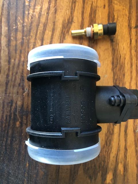

I had once planned on using Megasquirt and did tons of research on sensors on the forums. This is a Bosch MAF/IAT and a GM coolant temperature sensor. The MAF/IAT sensor comes off a European BMW and it's inlet/outlet is 70mm. If you're familiar with injector selection, this engine matches nicely to the Bosch 'Green Giant' injector which is what I will be using. Haltech Elite 2500 has an internal MAP and I am not sure if I will use something external or just run a line to the ECU. I have heard of people using both but I'm not sure why or what the benefit would be.
