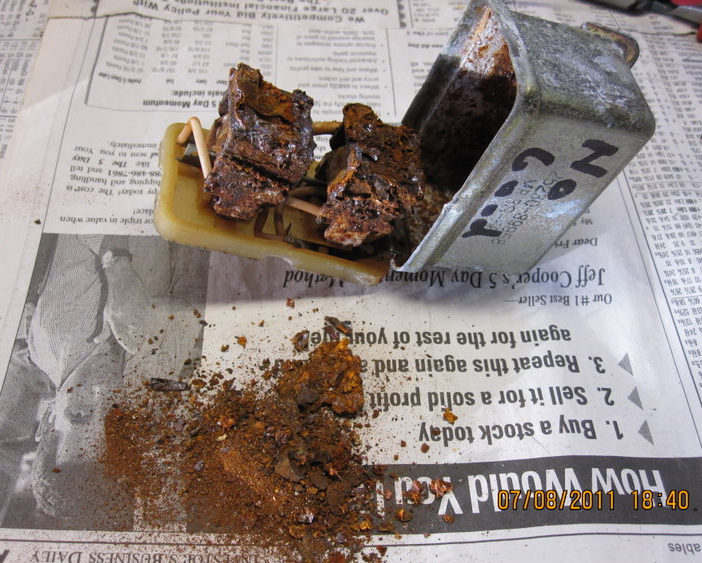

The ignition relays on the 280Z's were put in a spot that gets wet if there's a leak.  Same reason, different location.  Current heat.

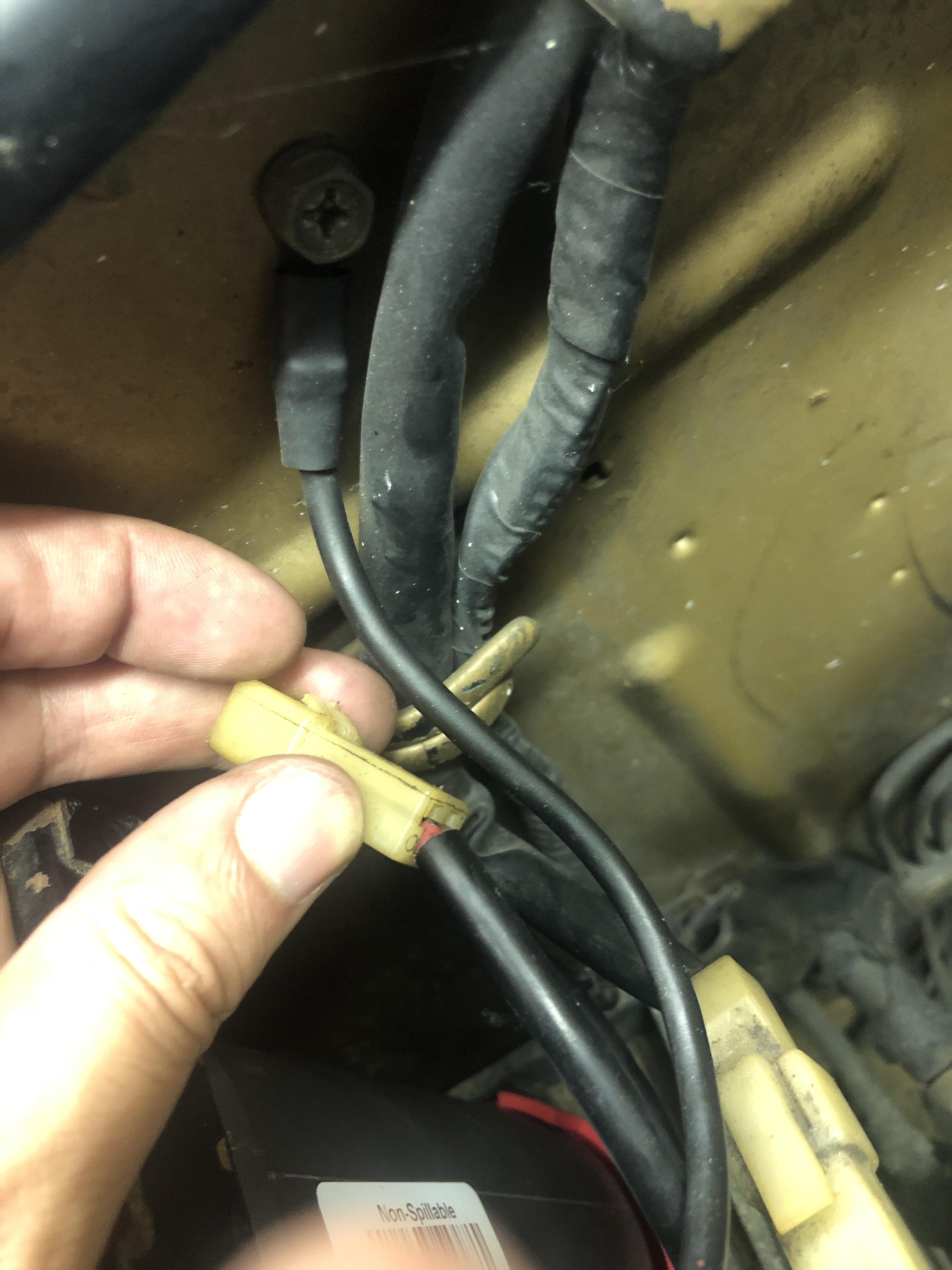

 The battery terminals were fine, but this spade connector on the positive side near the firewall was corroded. Problem solved.
Green wire? That may be the EFI fusible link.
That's a red wire?
Glad you're out of the woods for now but I'm not sure that was really the root cause.
I think the corroded connector you found is the fusible link for the EFI system (and only the EFI system). If that's the case, it could account for the car cranking fine but not starting. Corrosion there wouldn't account for the rest of the symptoms you had.
I'm thinking that while messing around up by the battery and cleaning that connector, you bumped whatever really WAS causing the issue. Hope not, but it might come back.
