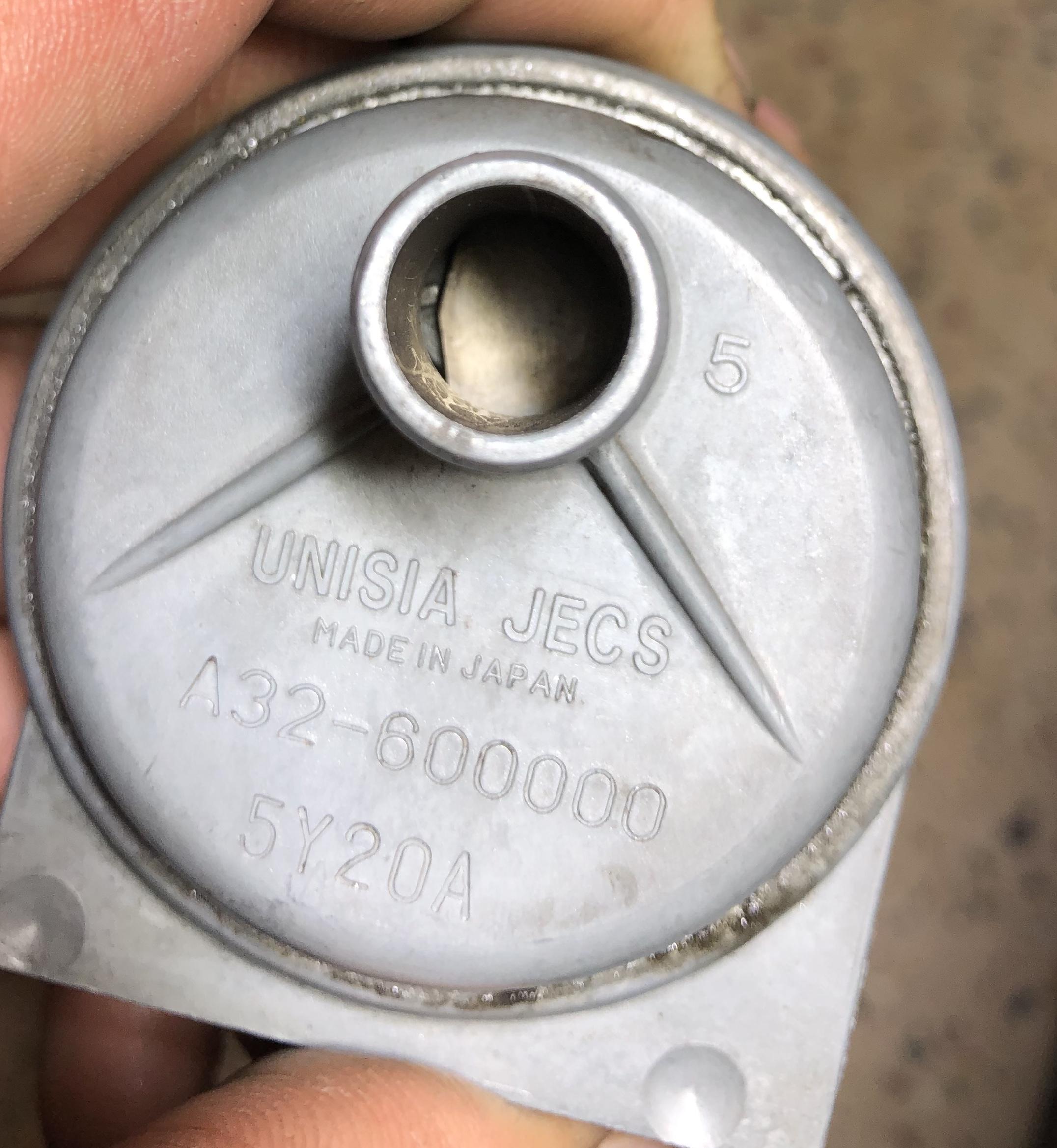

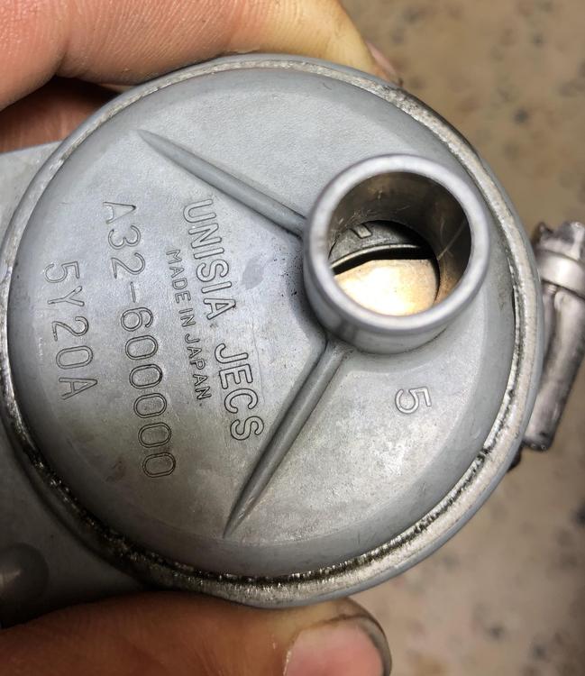

below are the photos close and open.  Though slightly but behind the door, the bimetallic probably do some awesome magic in there

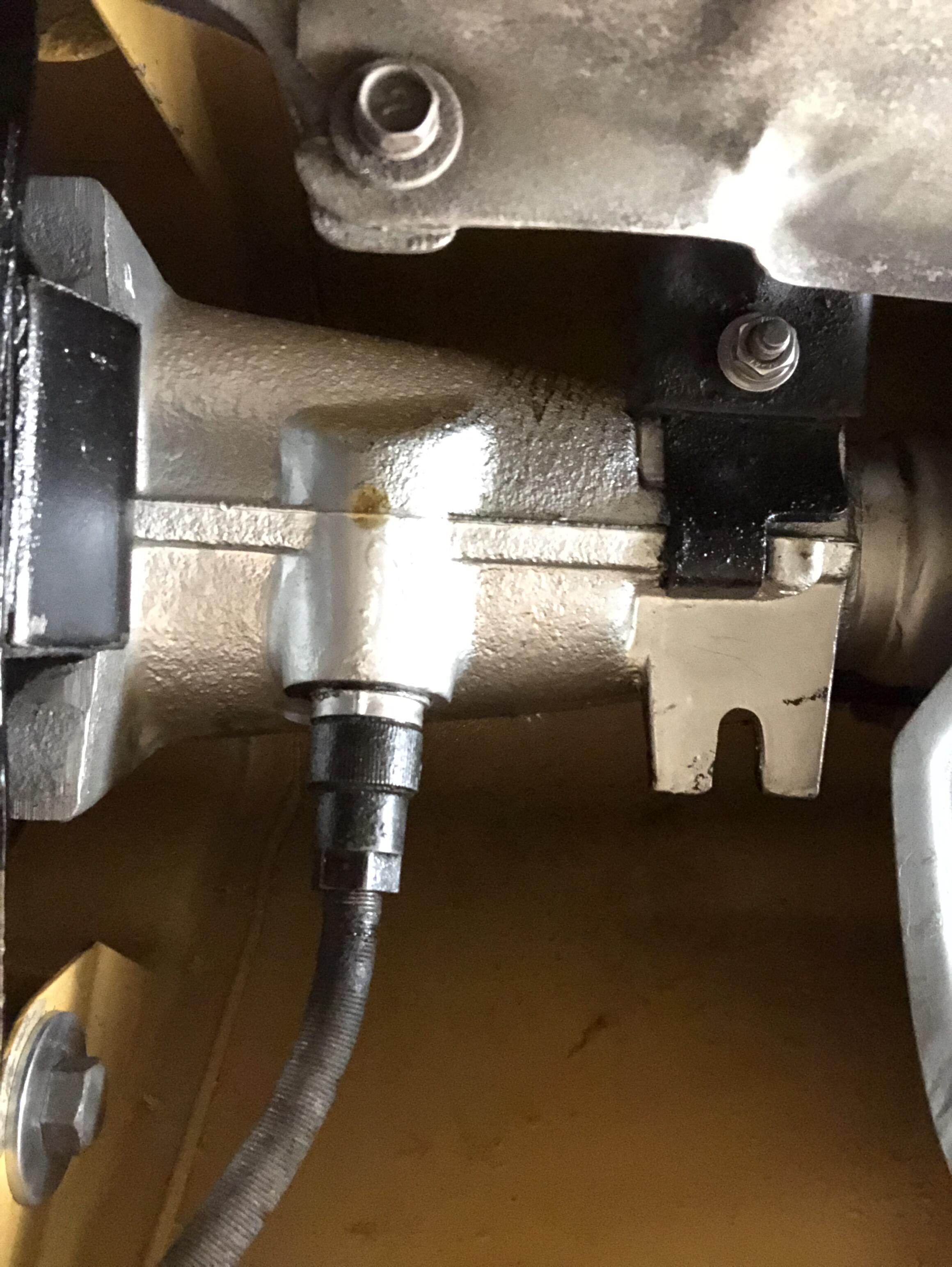

Got a chance to re-lubricate the speedometer cable and other things bother me as the mileage doesn’t seem match with the google map.  Got curious, drove different car with same route and my minivan milage agreed with what google map.  My Z is short a few miles.  On top of that, the speed, mph is ~5 miles slower.  I download the app from Apple store to measure….

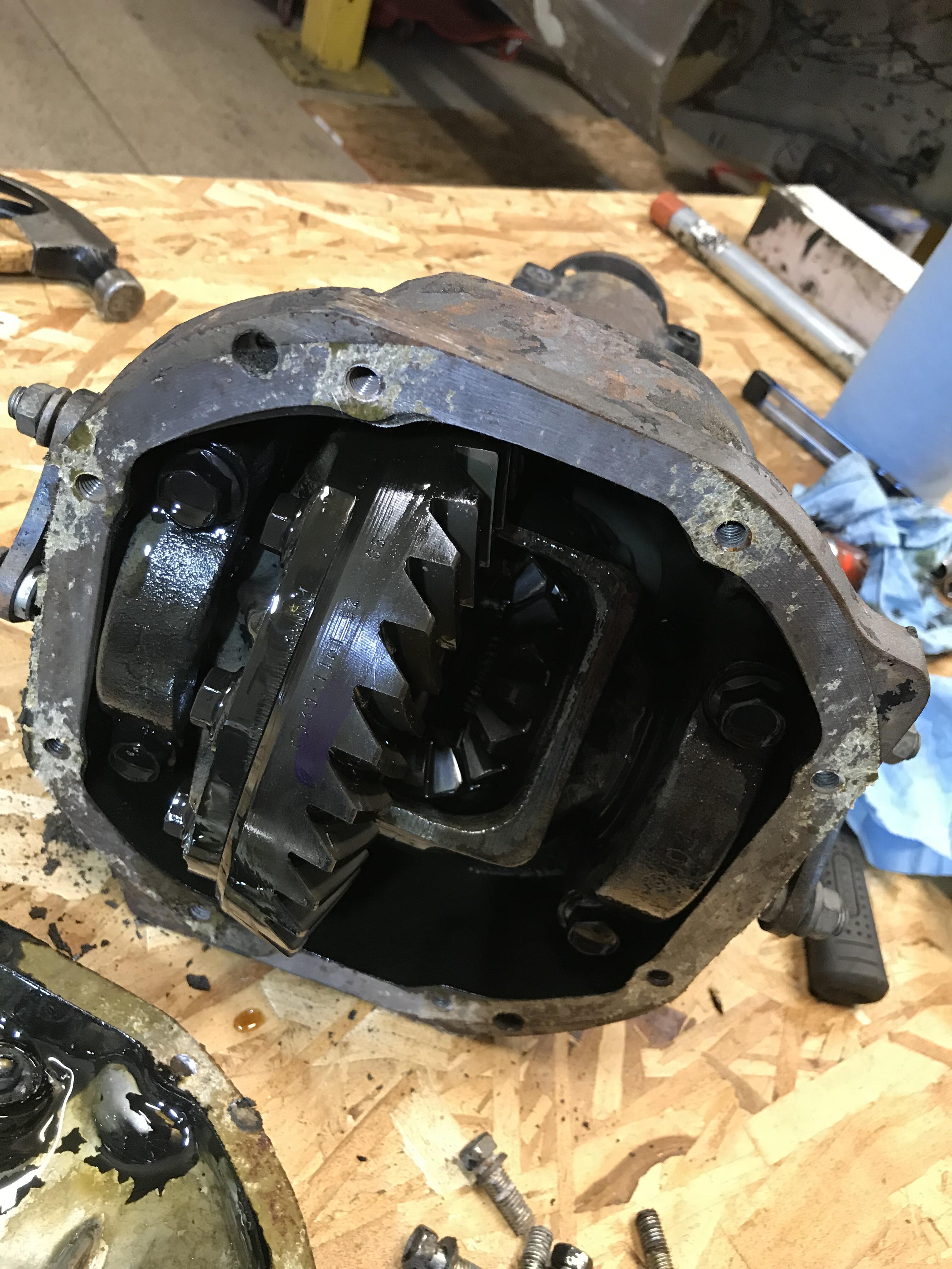

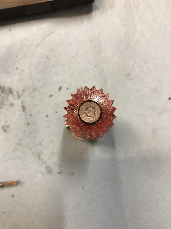

got curious, did the 10 tire rotations as well as the one complete rotation and see where the shaft pointed to… both agree to be shy of 17 revolution and 3 o’clock mark.  So the diff ratio is about 3.36.  However, the stamp on the r200 gear is 39-11 as shown in the photo.  Moreover, the speedometer pinion seem to be incorrect.  It is red and 20 teeth.
I would think my 5 speed and r200 with the info above should be a 17 teeth, black color pinion.  What do you think?

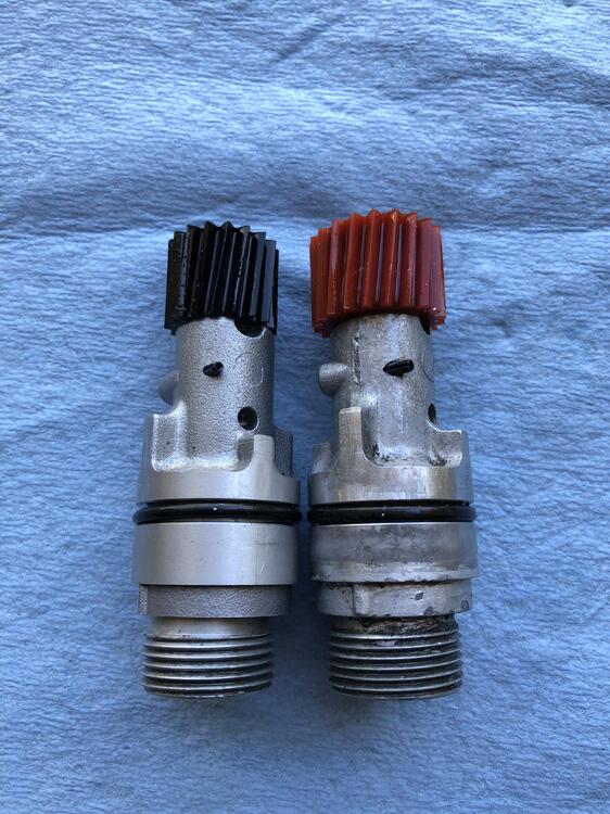

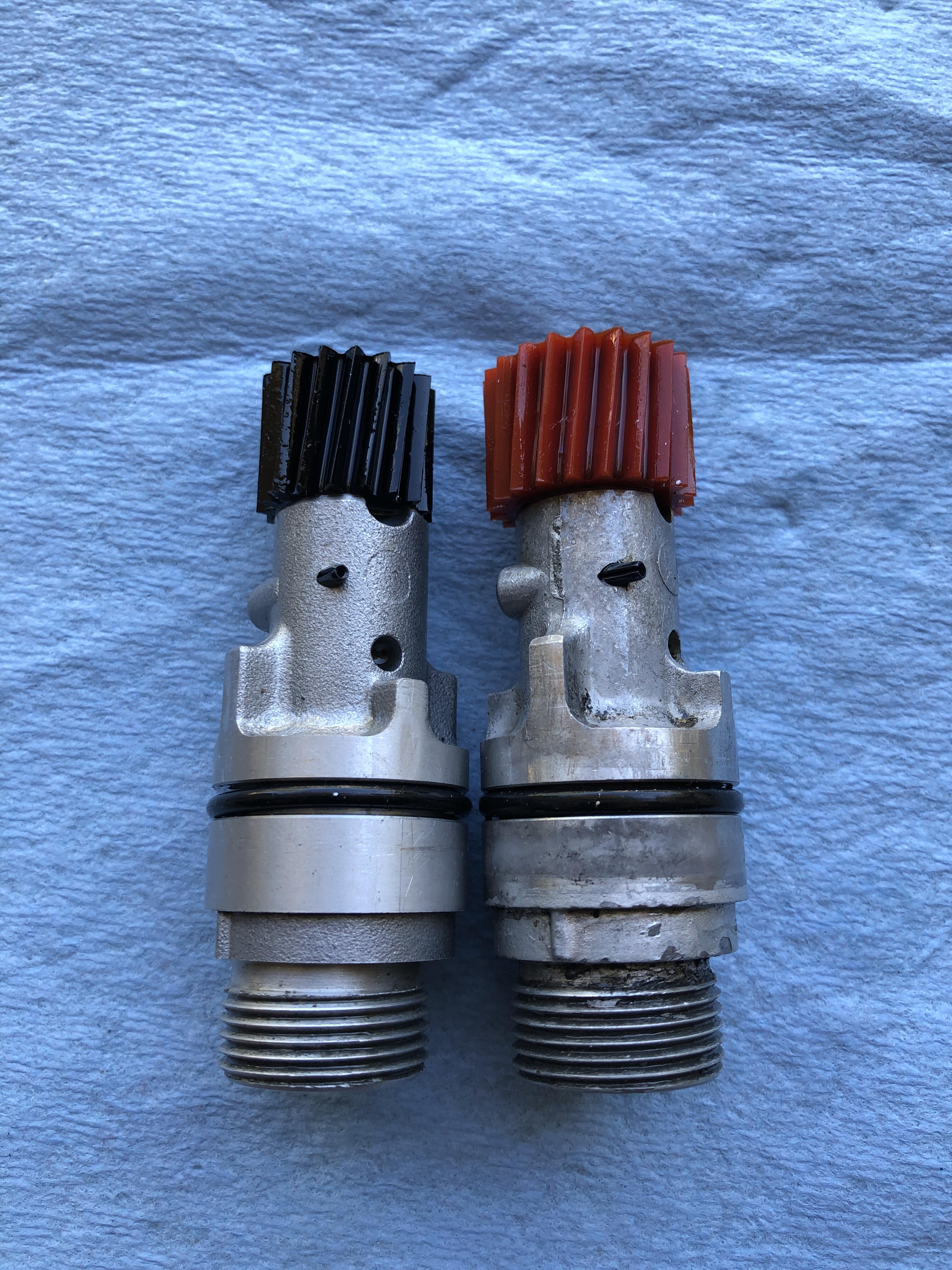

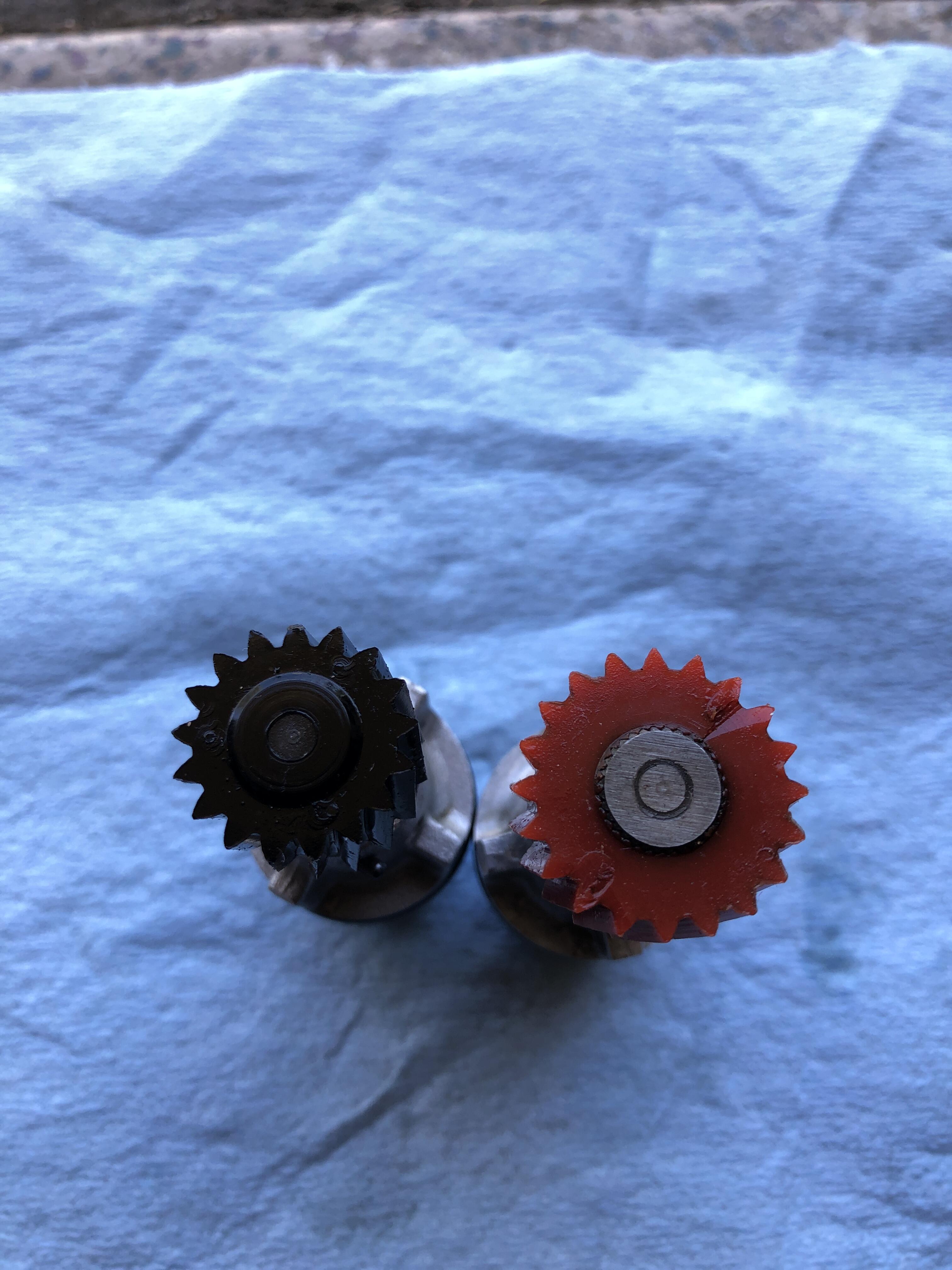

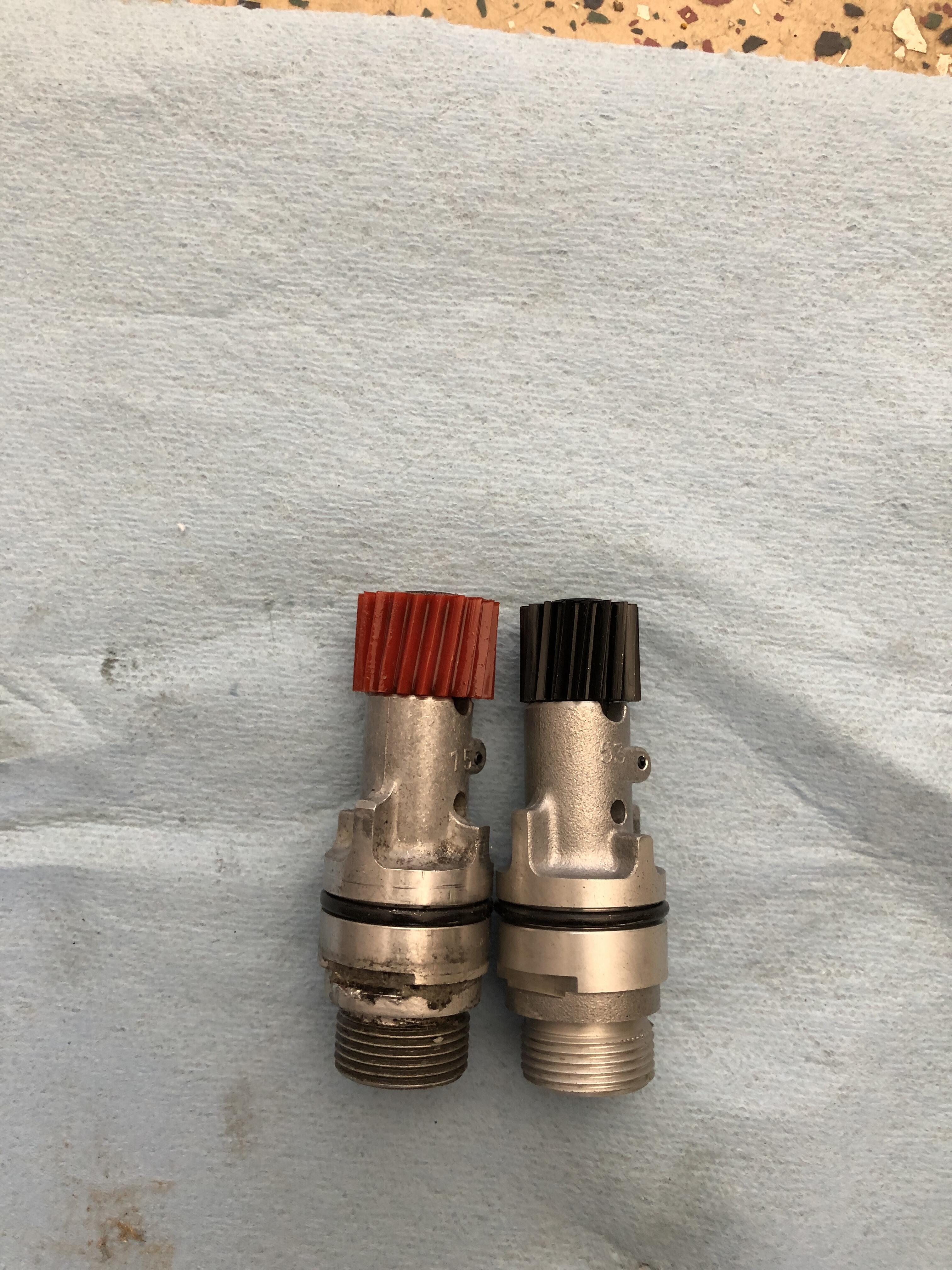

Well, I ordered a black version of 17 teeth and guess what? It is much smaller than the red one.  Take a look at the photos.  Is there more than one black 17 teeth?  The black I received is about 20mm vs 24mm wide for the red one.
please advice.

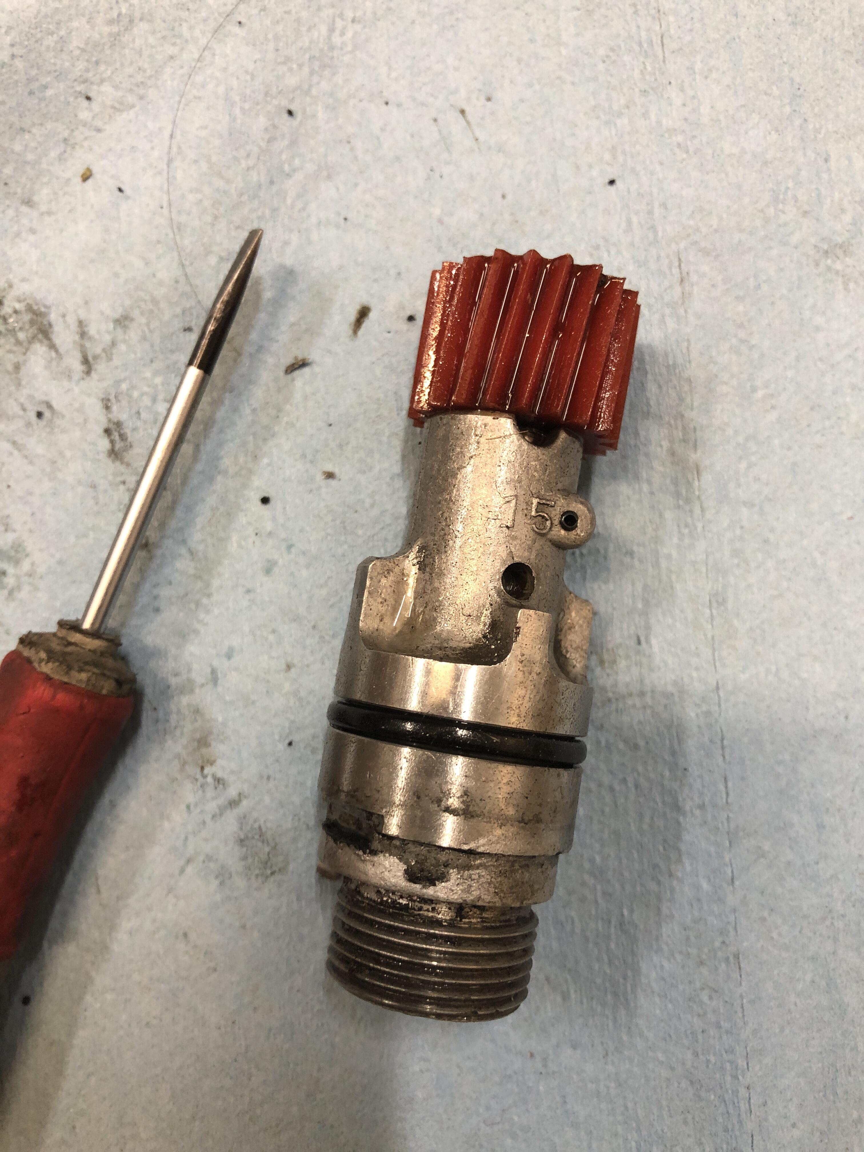

Seem like my 5 speed is from a transmission type “B”.  If I turn the pinion housing upside down, then the gear bites the internal worm gears.  For testing, I “manufacturing” a lock washer to hold it in.  The interesting thing is the speedometer is about 3-4 mph faster.  So, I’m having a dilemma.  The original pinion was 20 teeth and odometer is ~5mph slower.  The 17 teeth pinion is ~3-4mph faster.
I either need to get a blue, 18 or white, 19 teeth.
the numbers stamped on the r200 shoe that my ratio should be 3.54.
what do you guys think?  18 or 19? I’m leaning toward 19
