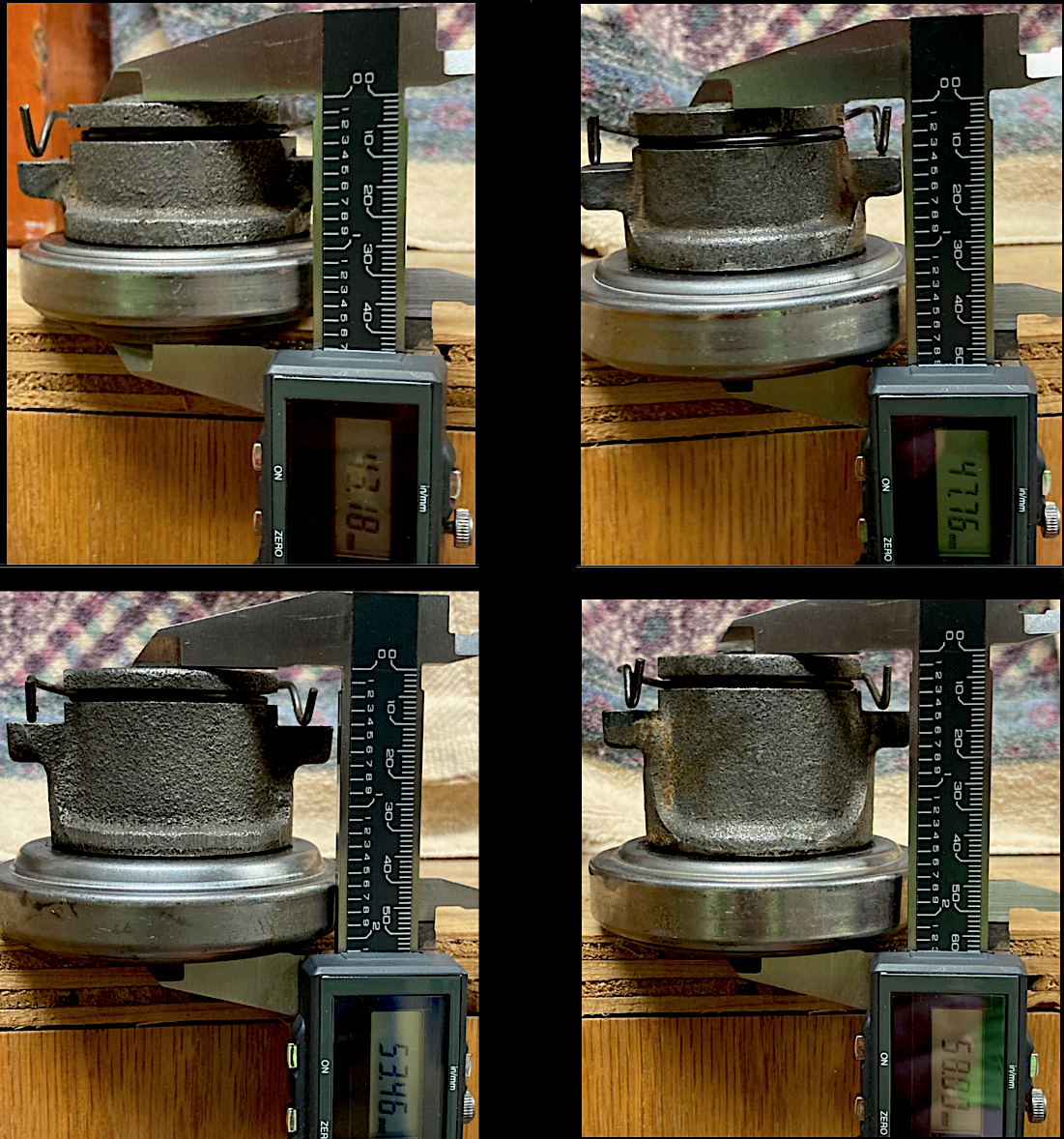

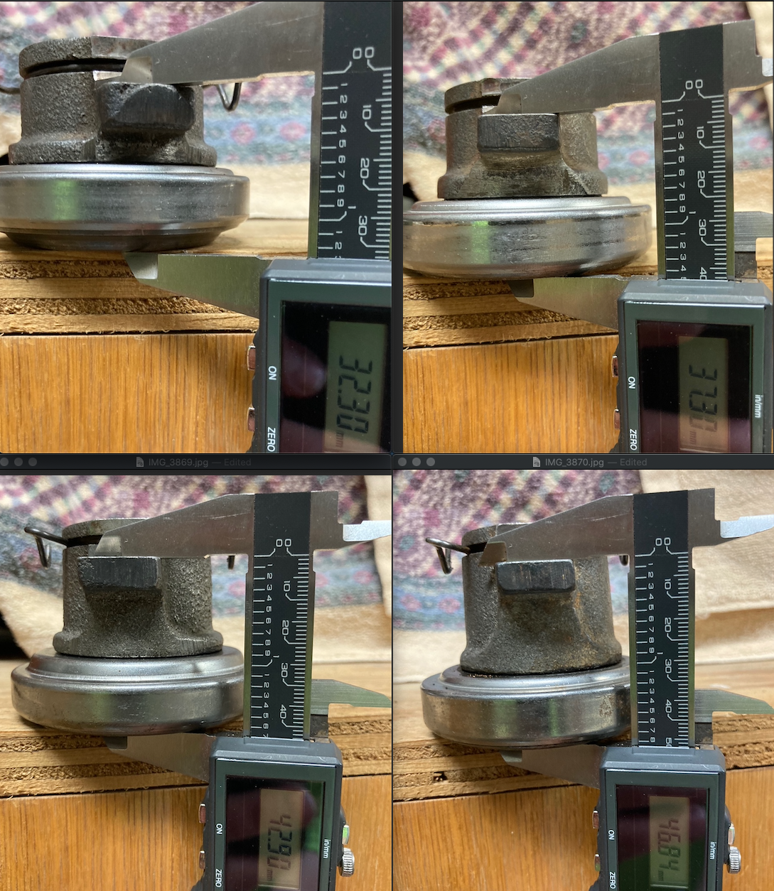

I finally pulled these out and cleaned them up a bit. Looks like I have all four with TOB's on them. The shortest ones bearing is a little different that the other three. I took measurements overall and to the ear. If anyone can suggest other measurements let me know ant I will update.
Nice, those mostly line up with the measurements in my image (repasted below for reference).  The only one I can't really match up is the bottom-right in your image with the 46.84mm ear to TO measurement.  Do you happen to know what vehicles each of these originally came out of? It would be helpful to label them if so.  Also, one more measurement you could take would be from the top of the throwout bearing to the top of the collar.  I'm pretty sure this is a functionally useless measurement, but it's what's provided in all of the other collar images I've seen (e.g. https://www.classiczcars.com/forums/topic/64212-clutch-fork-throw/?do=findComment&comment=602080&_rid=33357) and would help match your measurements to other images.  Thanks for doing the legwork here, I'm sure it will save someone a lot of headache down the road.

I pulled the numbers from Terrapin Z's measurements, from the ears to the bearing surface.  Wonder why there are four.  Doesn't really make sense.
32.3
37.3
42.9
46.8

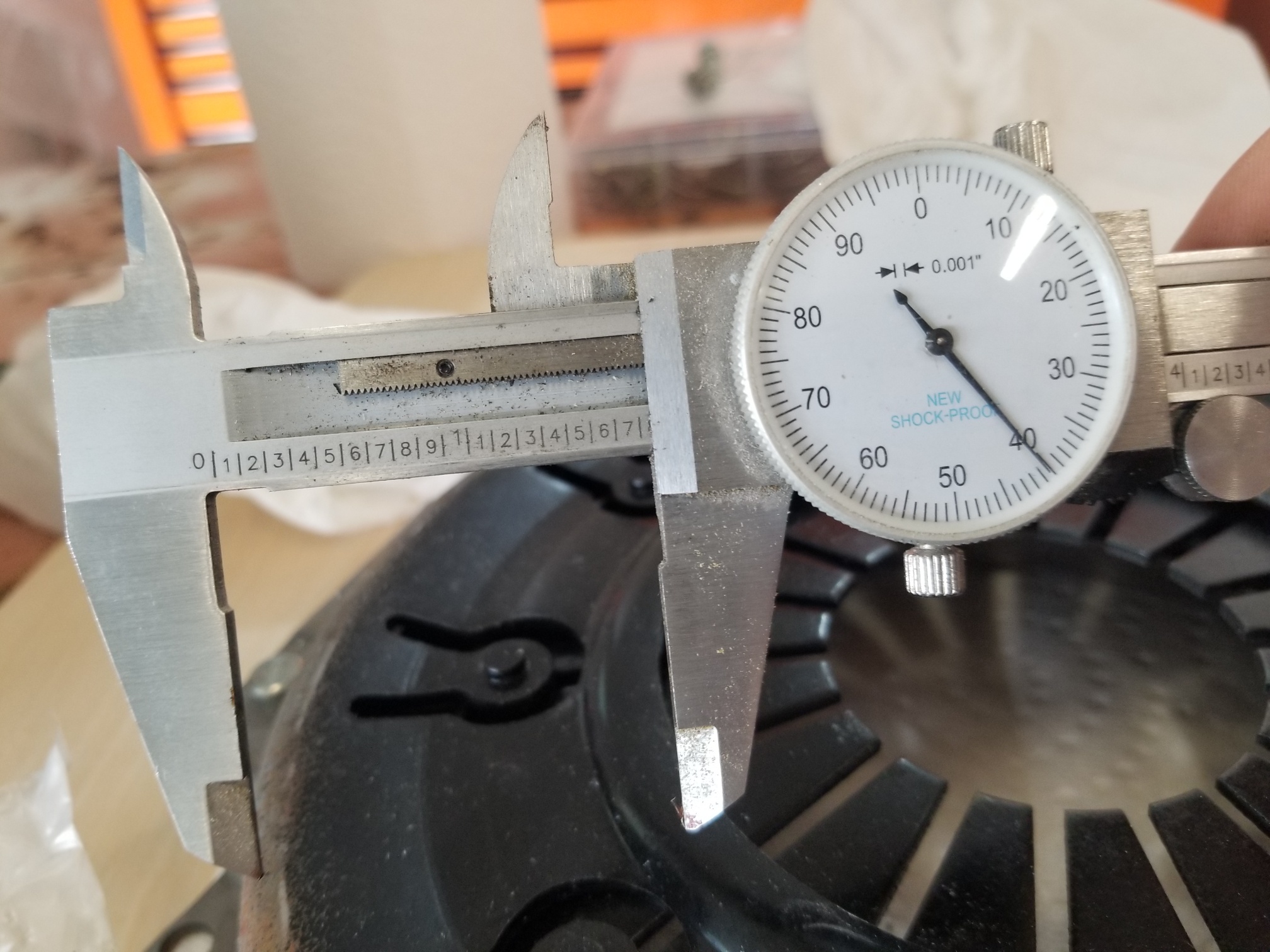

So I have a new issue with Cody's car
My clutch stack up is only 74mm with the current collar to the ears
I believe this is the measurement from the fingers to the flywheel. So about 44mm
Luk brand clutch kit
Now the throw out bearing fits down in to the clutch fingers some. So maybe it is installed backwards??
I thought I might have a smaller TOB collar but at this point I'm not sure.
Even if I have the smaller one, the difference over the 4 types looks to only be 10mm. That's not going to get me to 92mm??
