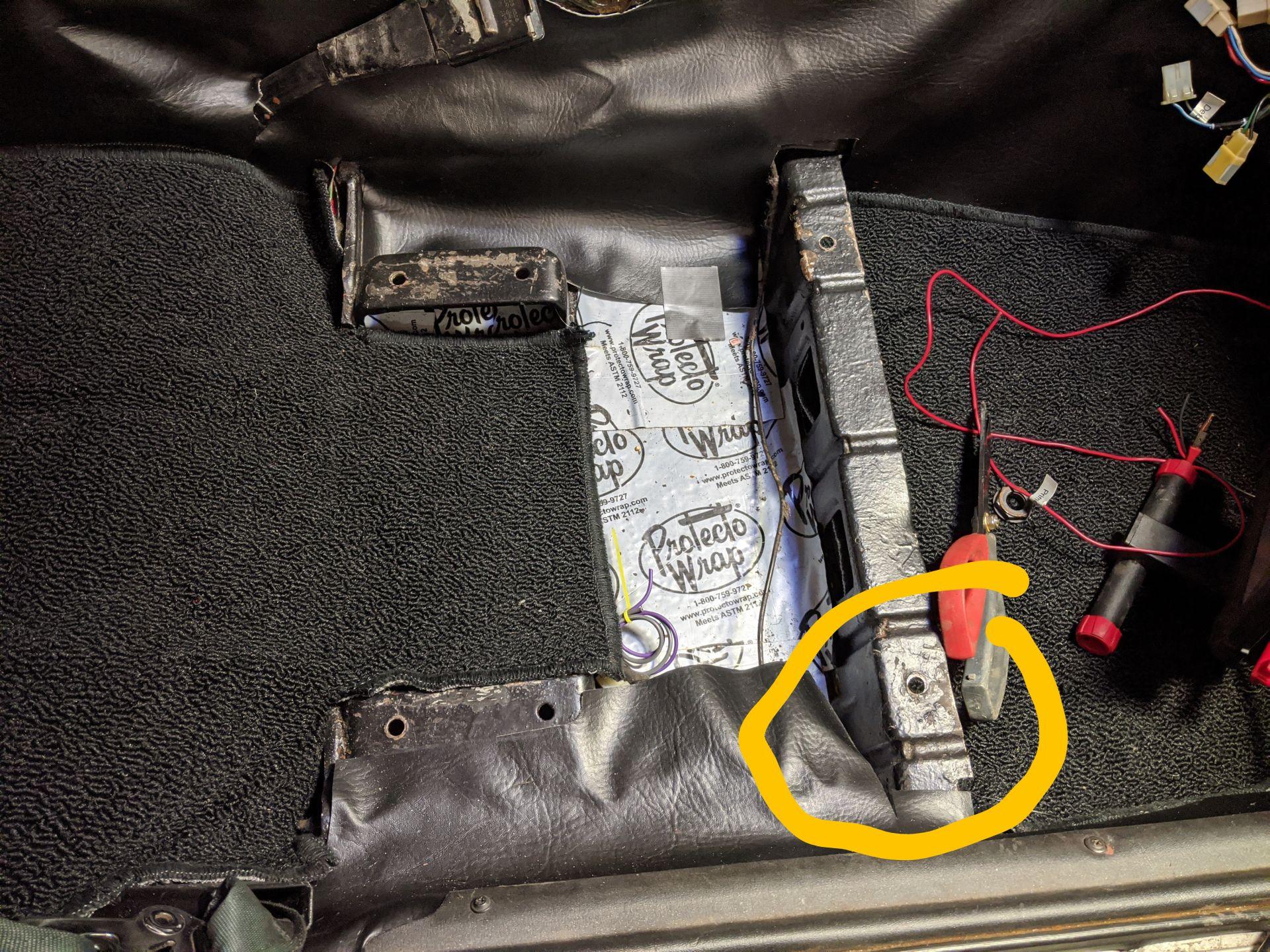

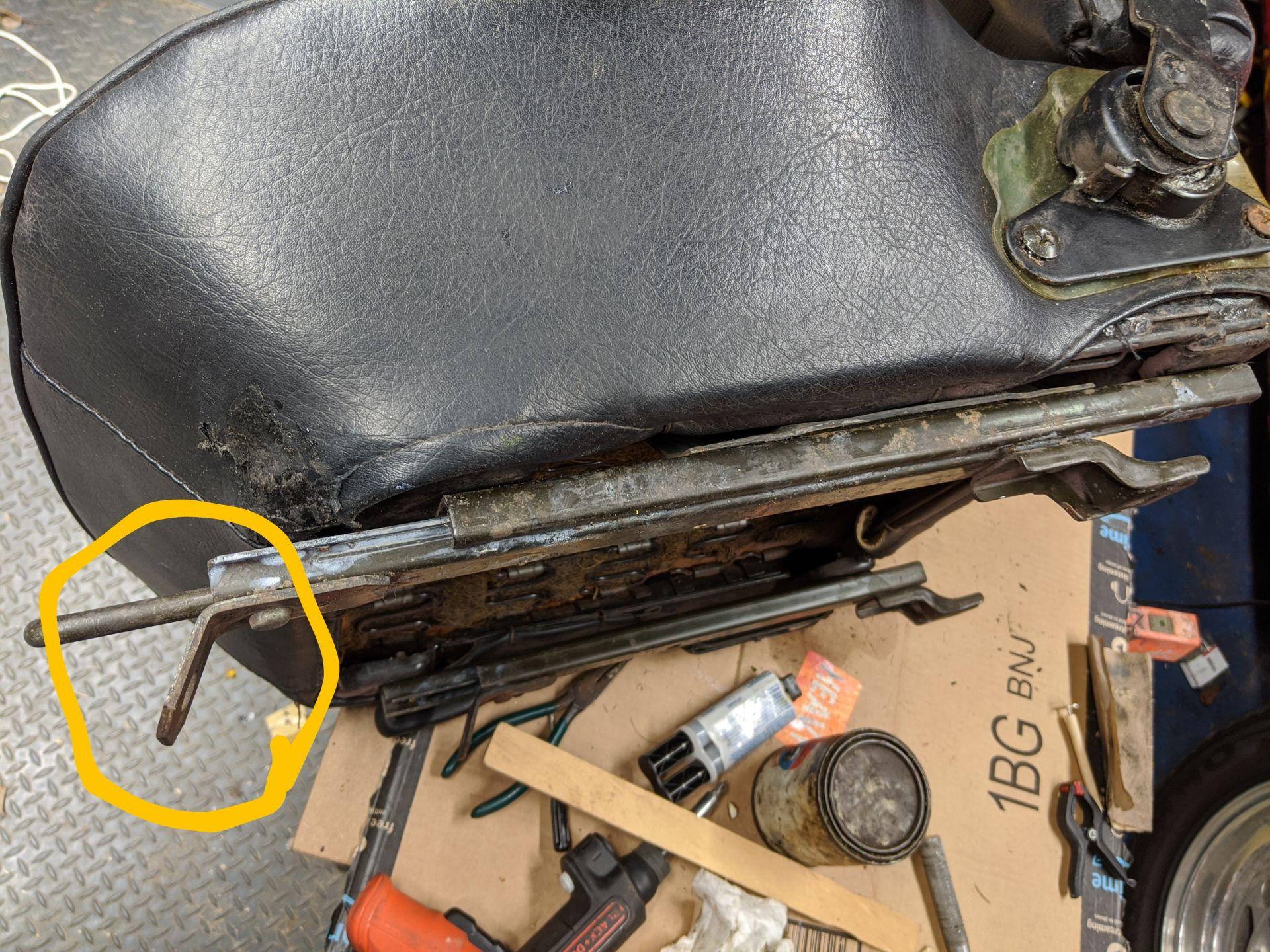

I'm in the process of putting my 260's interior back together with seats I purchased from someone that said that they came out of a 260. The rear bolts line up but the seats have a tab that tilts down at 60 degrees in the front that doesn't line up with anything. I'm likely going to just bend a steel bar and drill a couple of holes in it to make it fit.
Is there a part missing or is this just a variation in seat design?

Yup, those rails are 77-78. The 74.5 to 76 have 60 degree tabs on both ends, like the front tab on those. 240 rails have studs on both ends that fit your holes. I have lots of the 240 rails, let me know if you want a set. Send me a PM.
I have the same on my 11/75 made 1976 280,  they probably came from a later 260 and you have an early 260.
My 260 is a 4/74 manufactured so the source vehicle must of been a late build.
Does anyone see a problem in just bolting a 60 degree metal tab or should I replace the rails? I unfortunately have lost access to my metal brake until who know's when. I'll likely have to purchase 45 degree angle braces and hammer them to get 60 degrees.

Just replace the rails - get the correct rails for your original mounts.
I purchased the correct rails for my 260. Thanks for all the input.
