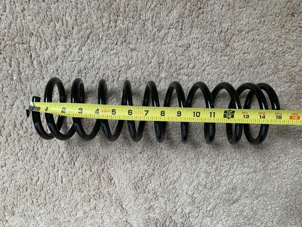

Yeah, that was my thought too. The 86lbs in weight reduction from dropping those bumpers might raise it up even higher. Starting to wonder if maybe the PO put springs from another car in. Taking apart the struts this weekend, will take a look and measure the springs
Actually @SoCalJim I decided to go grab one to check because I was curious. Looks like they are 15” which I think is around stock for the free length of the 280z. It’s definitely not the struts either because both are blown, no rebound when compressed.
