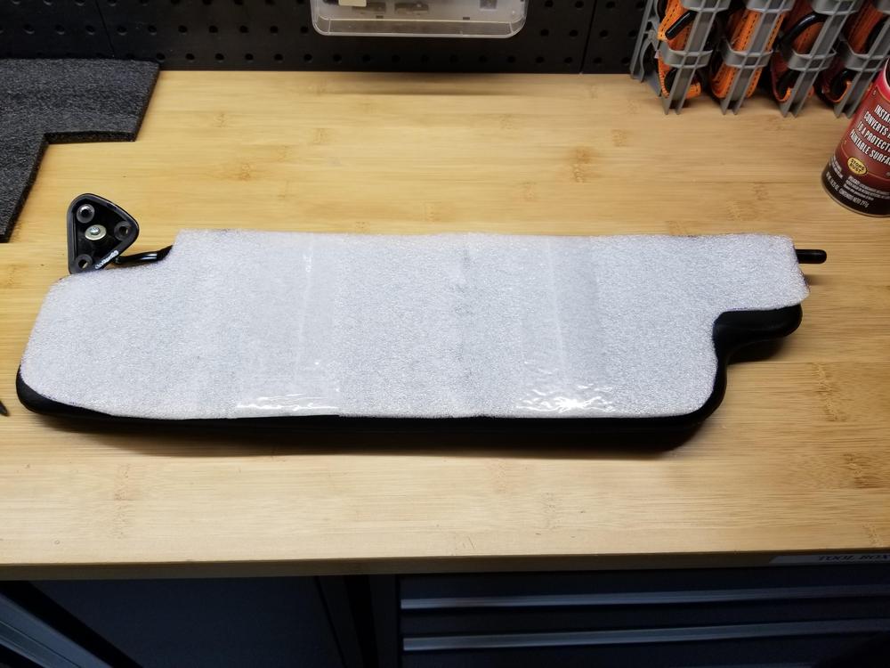

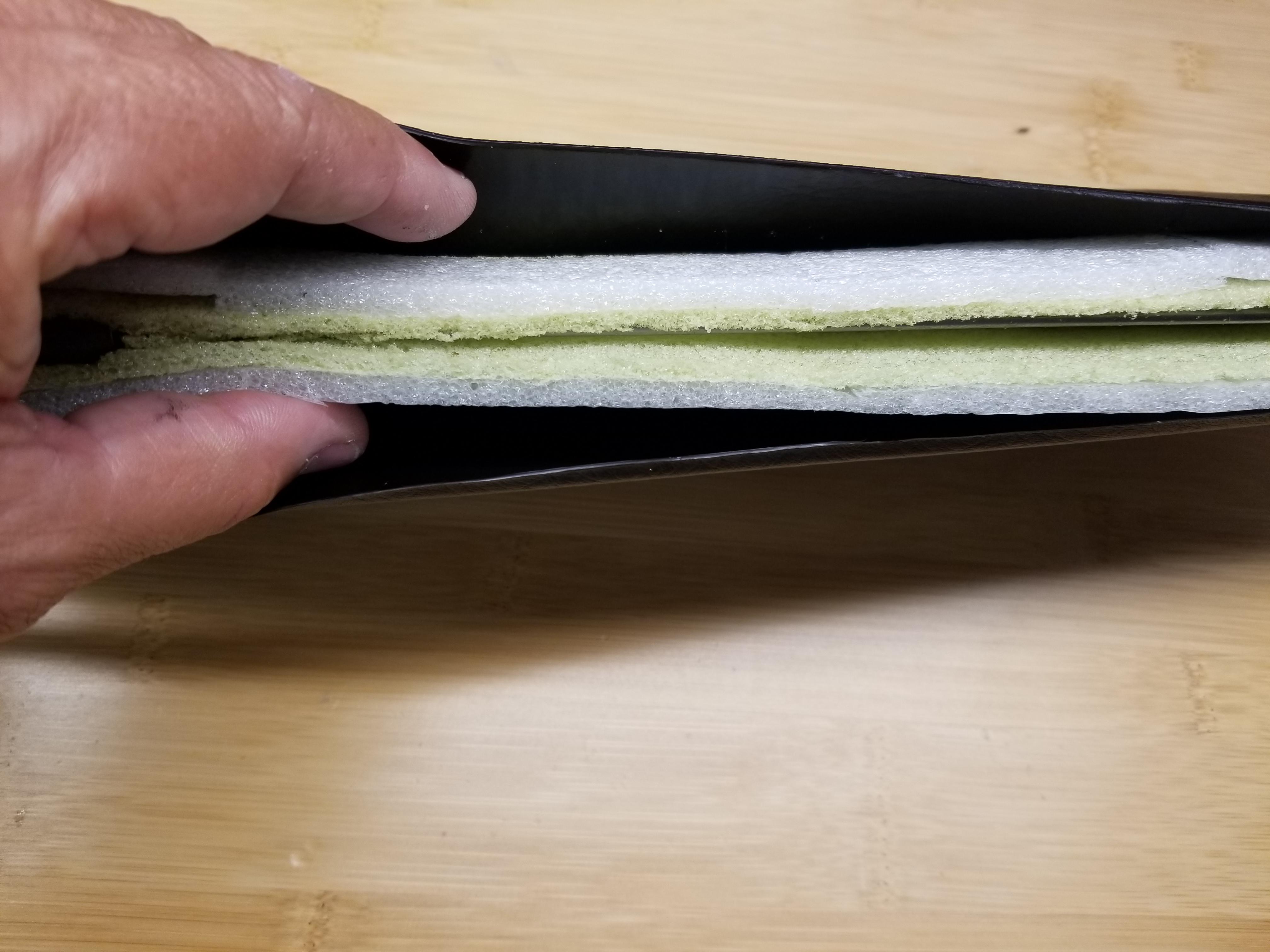

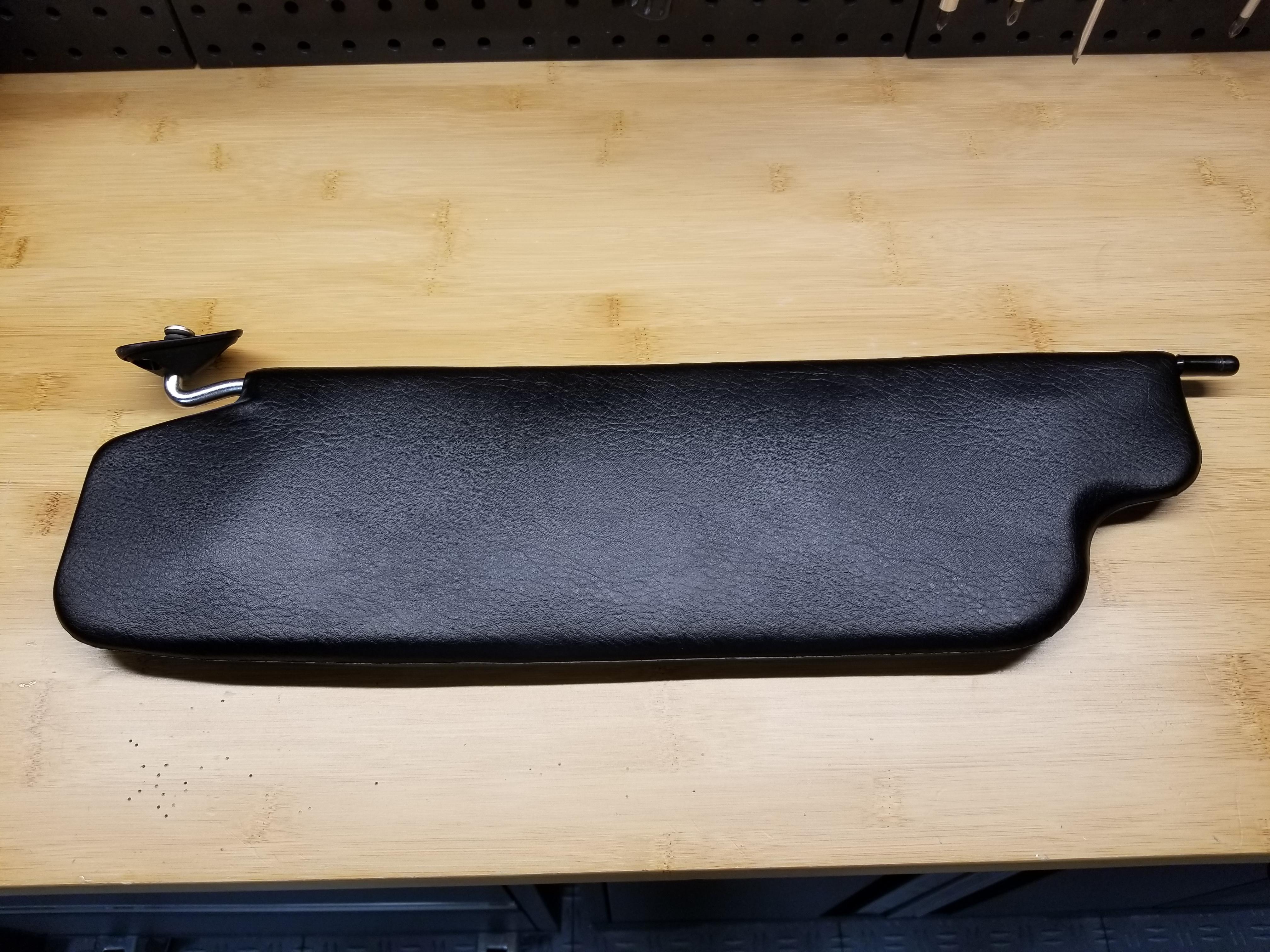

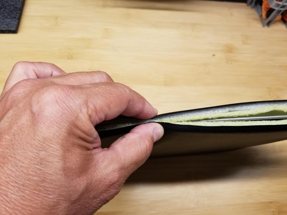

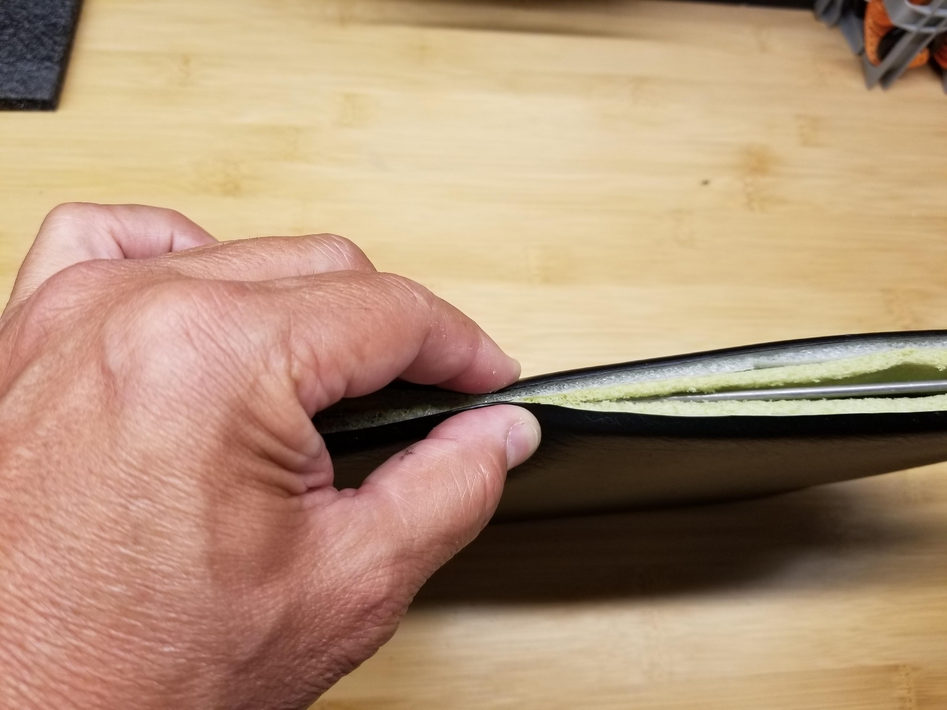

After looking at my original "saggy" sunvisors for a few years (and with lots of "sheltering at home" time) I decided to try a "fix". The vynil skins themselves are in great shape but it seemed as if the internal stuffing had deteriorated over 40 odd years and there were wrinkles here and there on the visors. I didn't want to change the original vynil for leather (visor repair kits on the market) so I decided to cut them open along the forwardmost seam with a fine scalpel blade, staying on one side of the seam so I could later close the seam almost invisibly.
To my surprise the foam layer inside was pretty intact and the cause of the wrinkles on the outside was just loose, saggy vynil. I cut out a filler panel for each side out of closed cell foam, 2.5mm thick and carefully fitted and glued it to the existing foam with 3M spray glue. Closing the seam again was tricky but all I could come up with was using a strip of Gorilla tape (that stuff really sticks). I placed half the strip along the inside of the top half of the vynil and slowly pulled the bottom half over the exposed tape until a precise closure was achieved. The result is a nice firm visor with an almost invisible seam. See pics below.

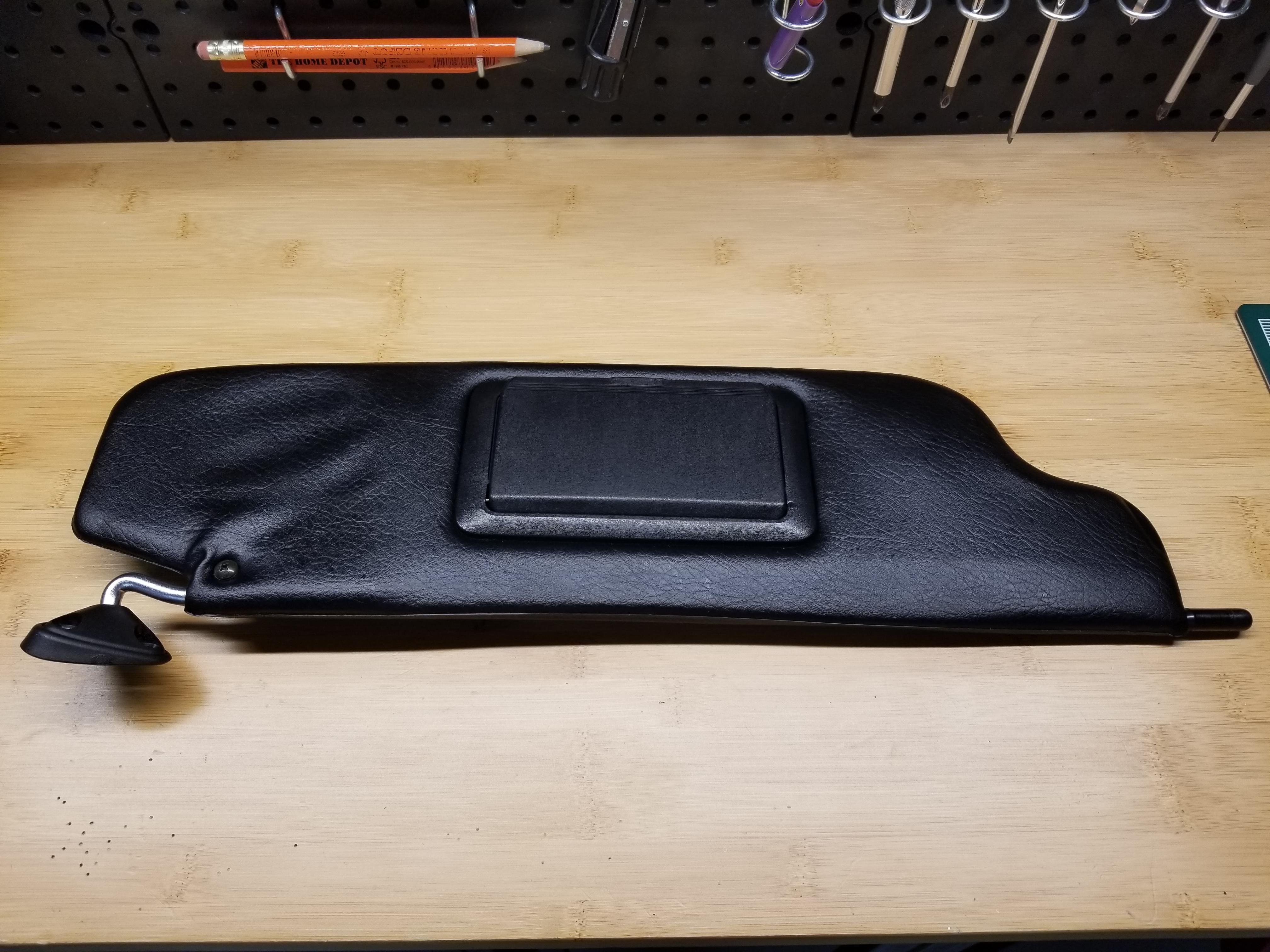

PS: I've only done the passenger side (which has the vanity mirror and is a little trickier) because I ran out of the foam. I will do the driver side once I get the foam and will post any details that I might change for improvement.
Original "saggy" visors (I know, they're way better than most!!)
New foam filler (white) fitted and glued to each side of the original green foam:
Trim the foam edges so approximating the vinyl edges can be achieved with just a little stretch:20200425_151542.jpg20200425_151622.jpg

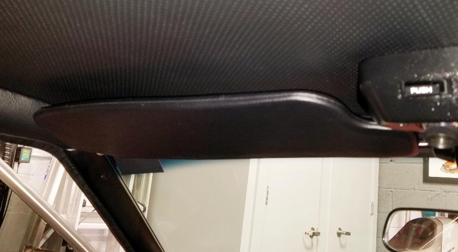

Gorilla tape on the inside of the top half and then bringing the bottom half of the vynil over the bottom half of the tape until the edges are precisely closed (start in the middle):
Final result:
Edited by dmorales-bello
Really neat job! Nice and plump.
Very nice work.  A few questions for you on 'technique':
  1. Why did you decide it was necessary to glue the new foam in place?  It looks like it would have stayed in place w/o the need for glue.
  2. Did you really manage to bring the two seams together perfectly, first time, or did it take a few tries to get it right?  If so, how did that work out? That Gorilla tape sounds pretty unforgiving.
  3. The picture where you're just bringing the top and bottom edges together makes me wonder how you managed to push the tape back into visor cavity without getting it wrinkled and/or making a mess (which you clearly didn't).  How was this accomplished?
  4. What is this 'scalpel' thing that you used?  Hobby knife, or actual medical scalpel?
Overall, I'm concerned that the tape joint is going to give up over time, esp. right at the seam and esp. when exposed to summer heat.  I guess only time will tell.

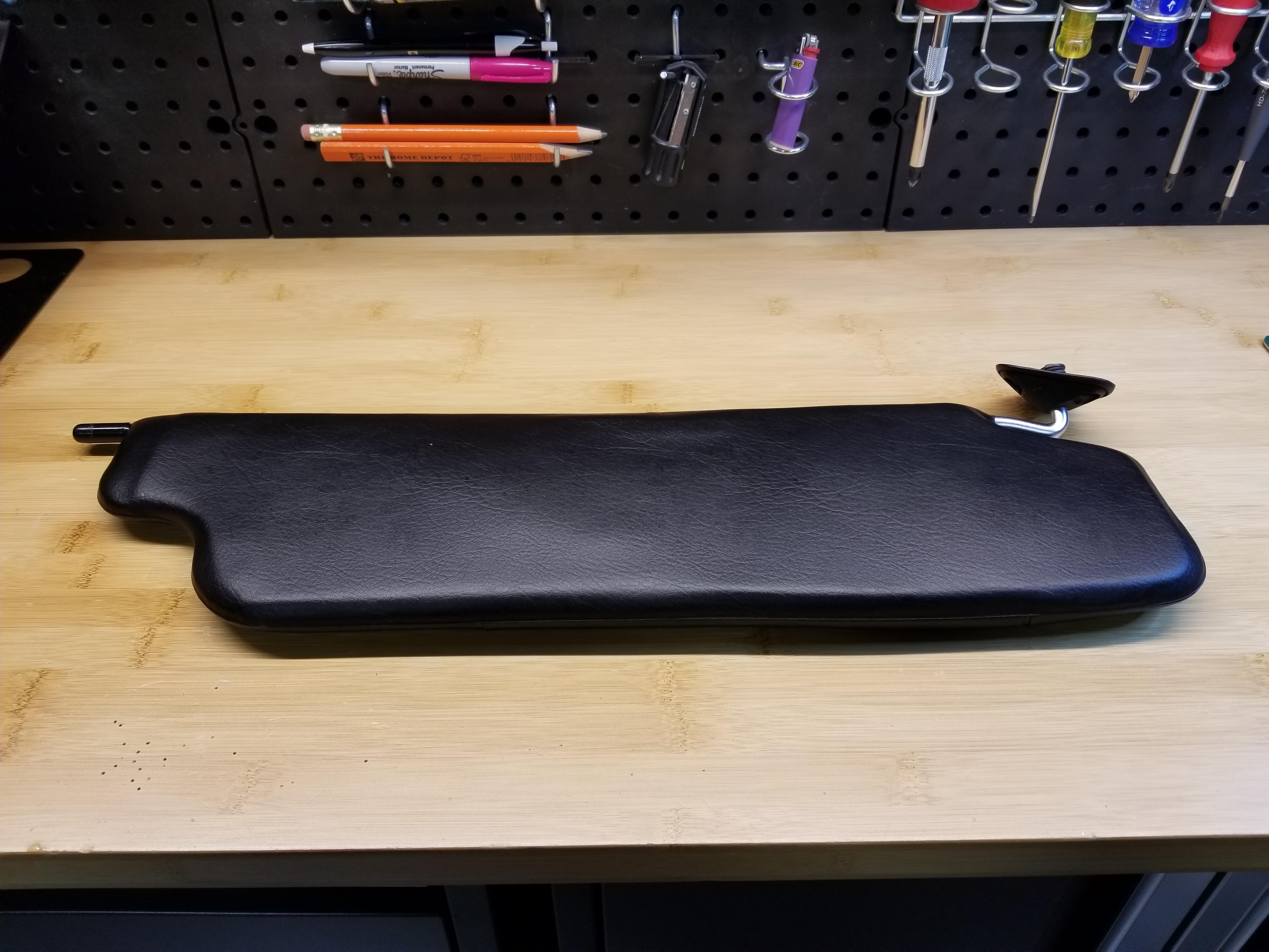

I just finished doing the driver side visor with a denser (dark grey) foam, same 2.5mm thickness. The denser foam gives you a result that's a bit flatter, less plump. I also revised a few technical details as I went along which made things easier and I will discuss those as I answer your questions.
1.- I decided to glue the new foam because it makes the visor a bit stiffer. It doesn't flex as much when you handle it and feels much more like the visors in other cars. It would have stayed in place without the glue anyways but the visor was more flexible.

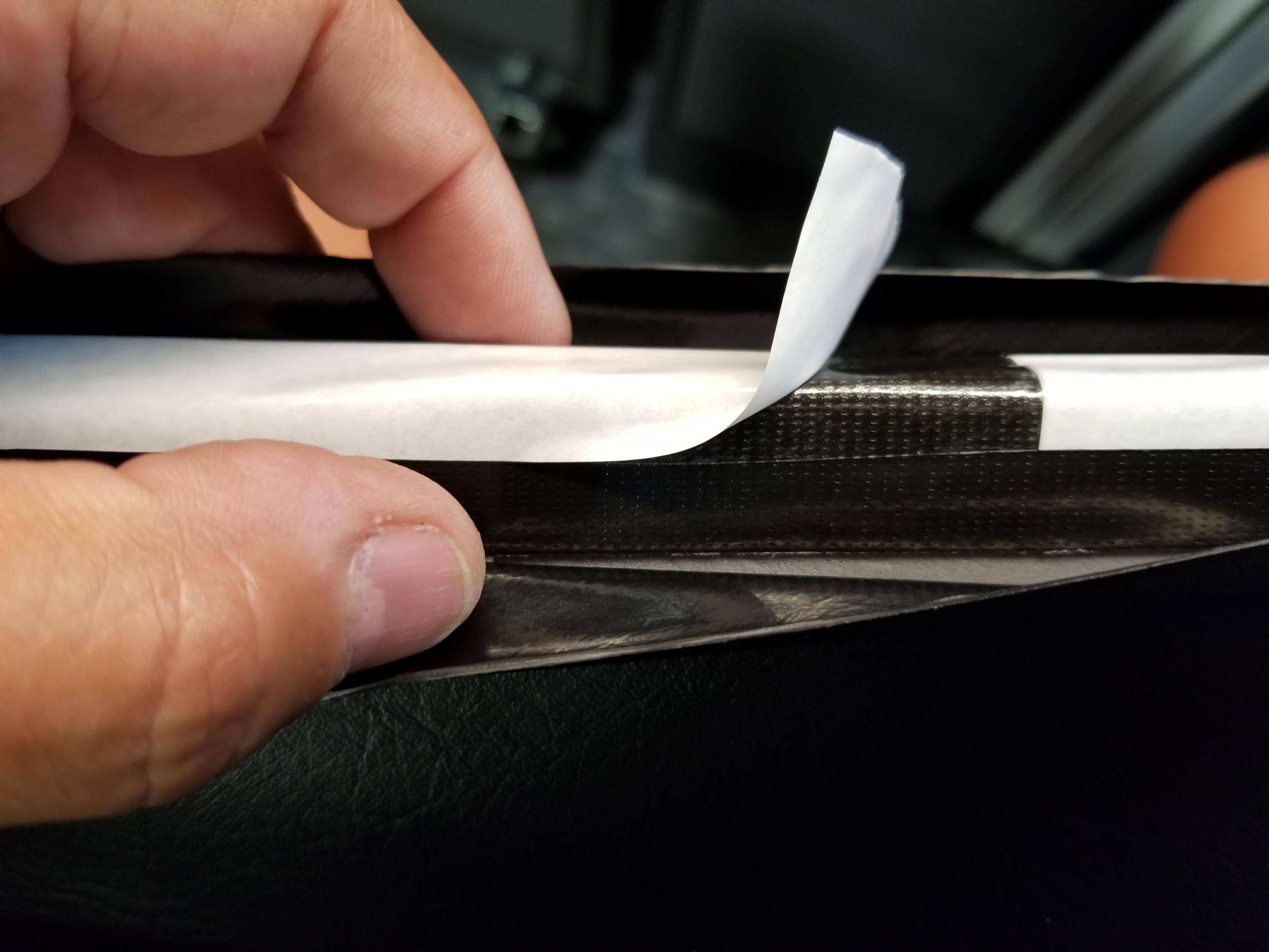

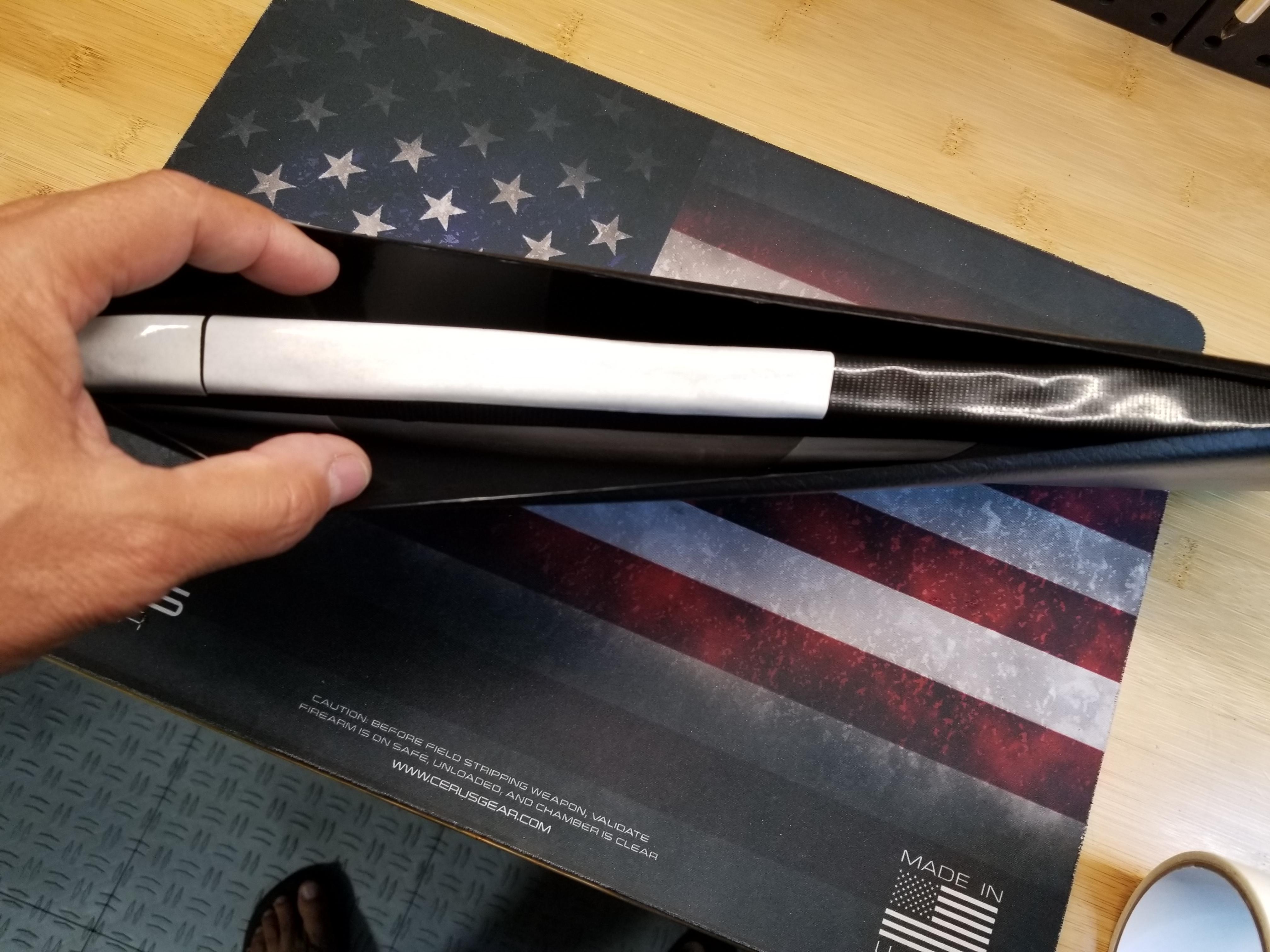

2 & 3.- Because it was difficult to align the edges perfectly with the inverted strip of Gorilla tape due to the width of it (which made difficult putting it in place without wrinkling the vinyl) and the very strong hold, I used a 1 inch wide strip of double sided tape (used for carpeting) along the joined top edges of the filler material. It's also very strong but not quite as much as the gorilla tape. I did however use a strip of Gorilla tape to join the top edges of the foam before applying the double sided carpeting tape (see pics below) so as to narrow the edge a bit and take all tension out of the vinyl edges when closing them. I think it's really important that when approximating the vinyl edges they do so with very little tension, start in the middle with about a two inch section and then work your way from the two extremes toward the middle distributing the vinyl appropriately so you don't end up with wrinkles. Both tapes (Gorilla and carpet) initially allow you to separate and reattach the material with moderate effort so you can fiddle with the edges until they line up properly. It's not as difficult as it seems.
4.- I did use a medical #11 blade on a scalpel handle but Exacto makes similar #11 blades that can fit their handles. I would not use a utility knife for that cut.
I liked the second approach (carpeting tape over the Gorilla taped edge) so much better that I took the passenger side visor apart again and changed it accordingly. It took a lot of effort and care to unglue the vinyl from the Gorilla tape after it had set! That stuff will not loosen with summer heat, believe me. I don't think the carpeting tape will loose its adherence easily either as long as there's very little tension when you close the vinyl edges.
All things considered I'm quite satisfied with the results and I don't have to stare at my saggy visors anymore.
I hope I've described the procedure clearly but keep the questions coming if needed.

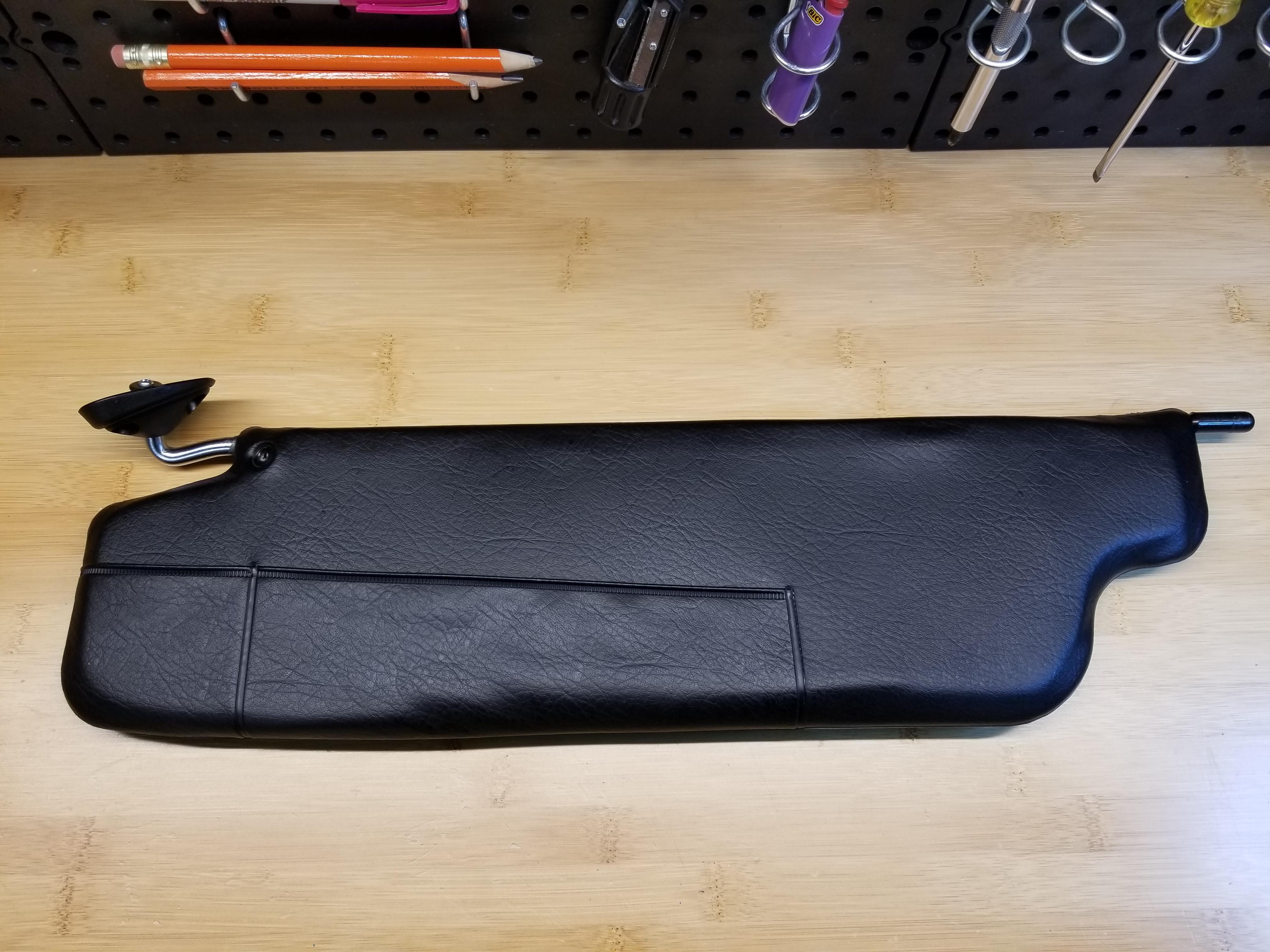

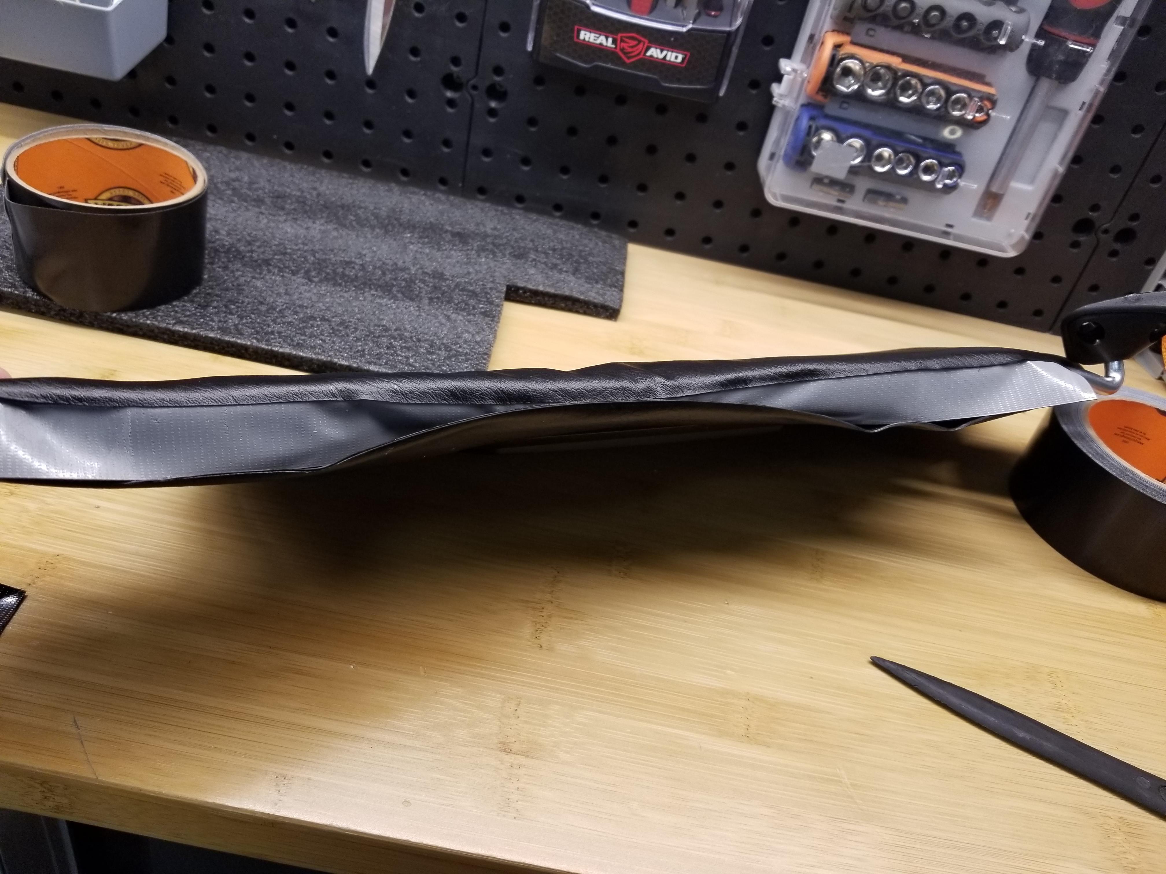

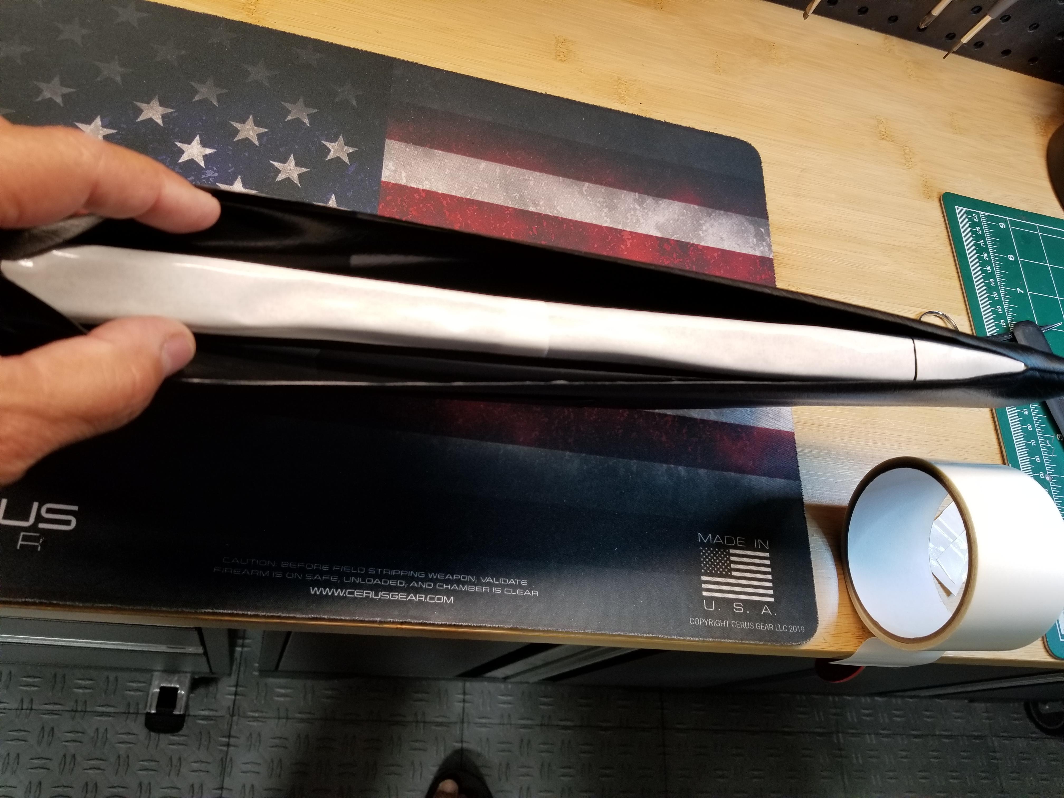

In this first pic you can see the Gorilla tape covering the foam edges (on the right) and the double sided carpeting tape with it's white paper backing on the left side:
Place a 1" strip of carpeting tape along the whole edge over the Gorilla tape:
Remove the backing paper from the carpeting tape and you're ready to start approximating the vinyl edges which can actually overlap a tiny bit as long as you left the "seam" on only one side of the cut (step 1 in the original post).

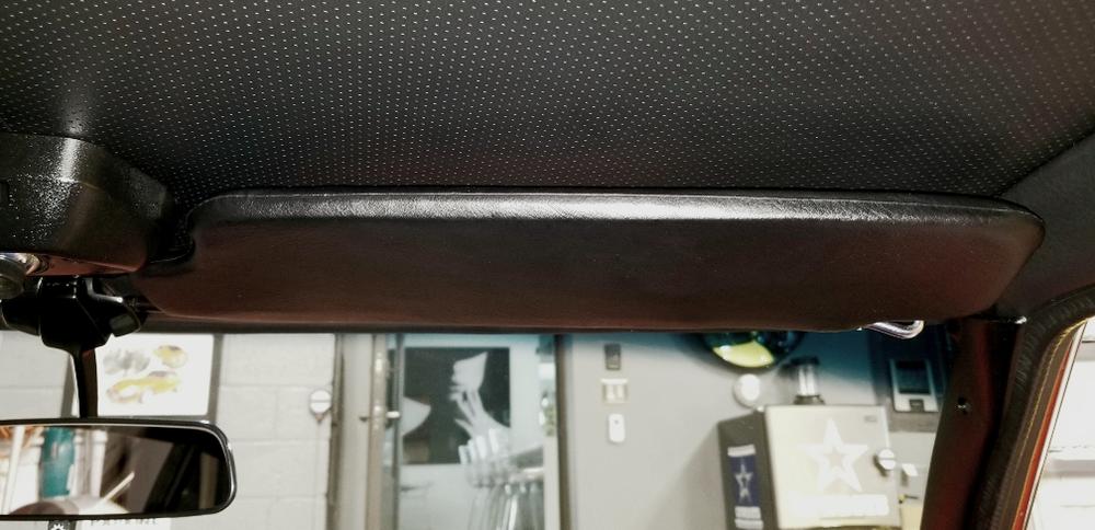

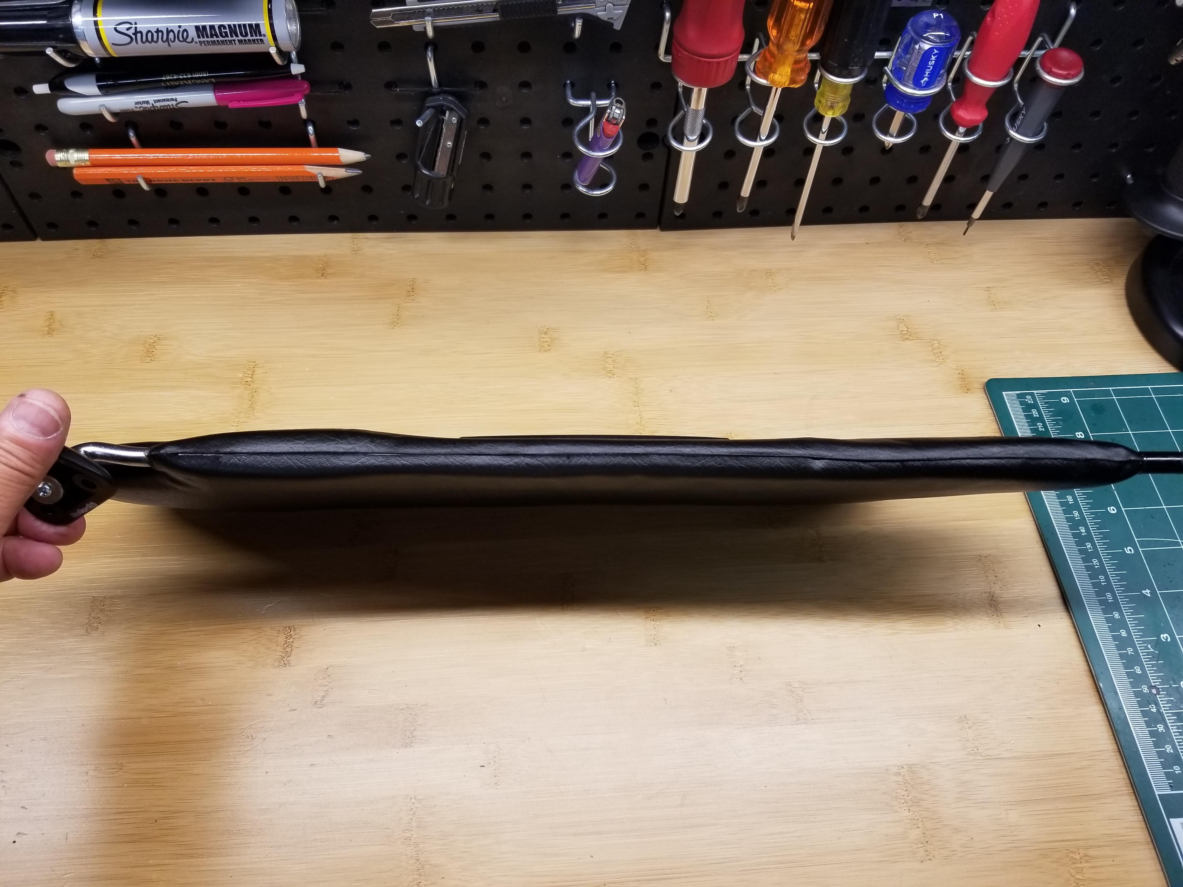

Final results:
There's still a bit of waviness on the vinyl skins but it's almost invisible once the visors are mounted on the car. Filling them with more foam would stretch out the wrinkles but the visor will start to look like a pillow.

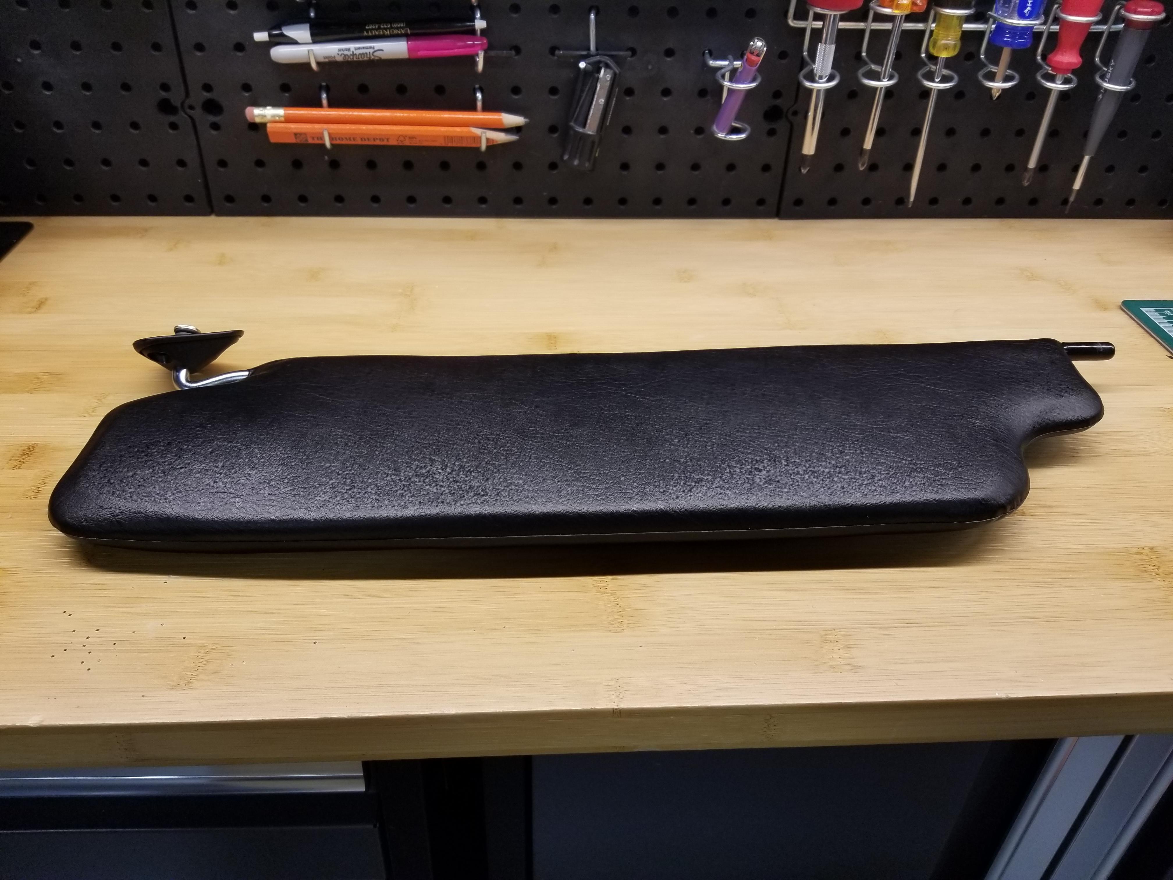

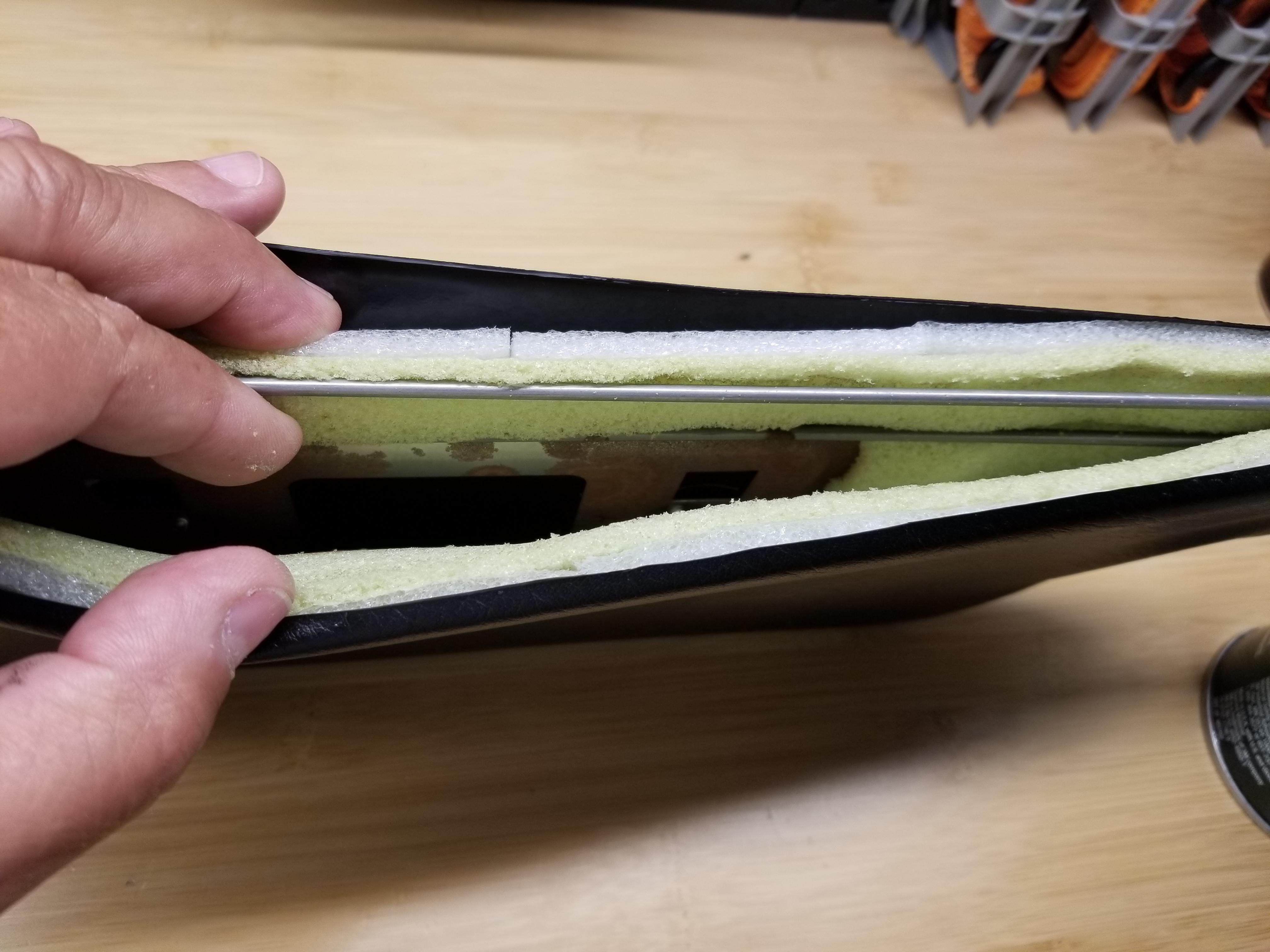

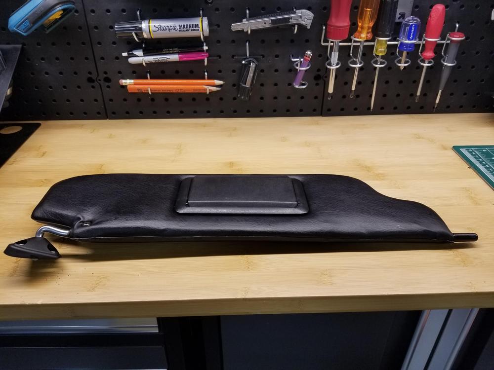

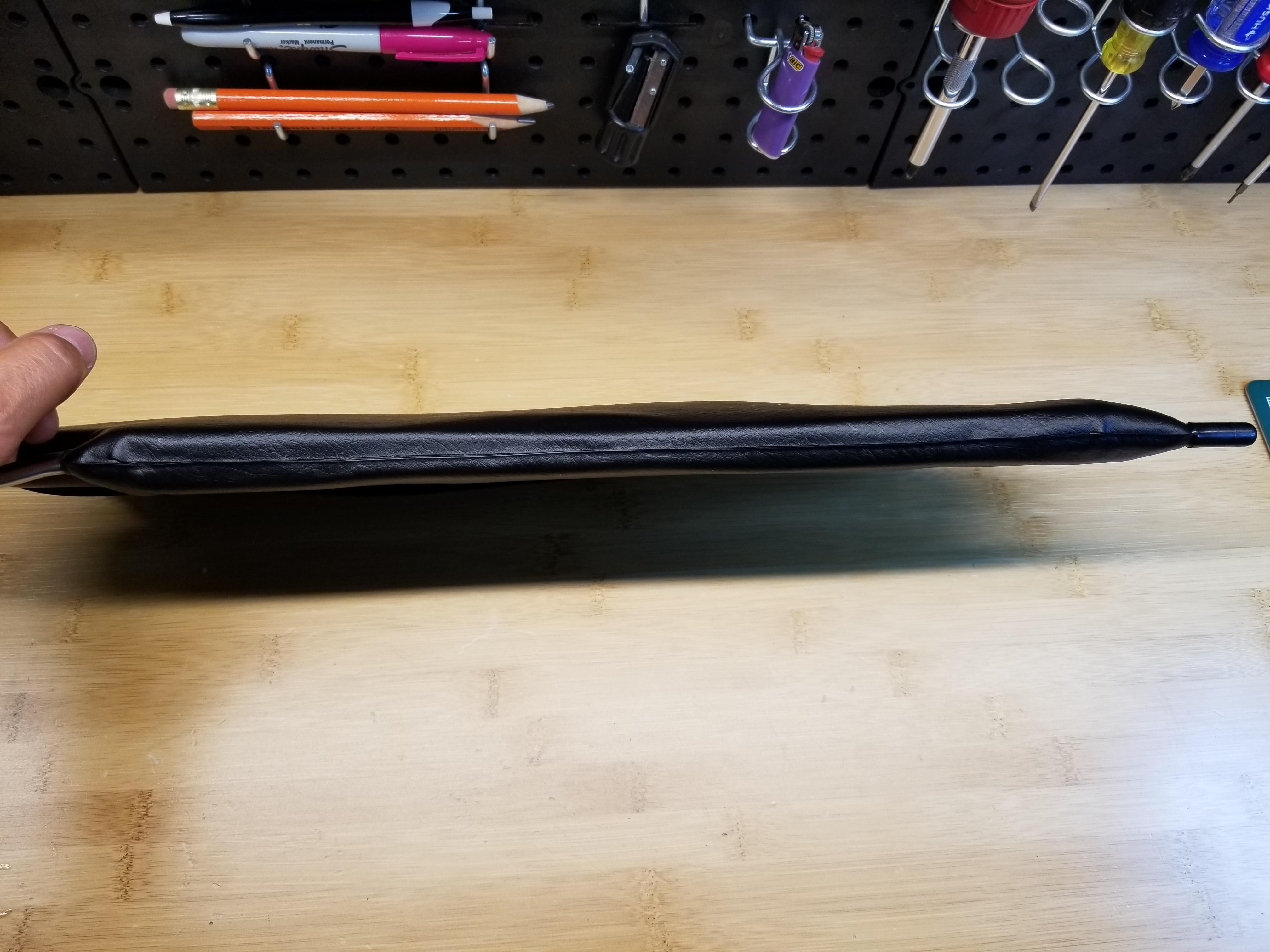

Not being satisfied with the "plump" look that resulted from my first attempt, I decided to be more radical and opened the visors again, took out all the foam I had added and all the factory green foam pads as well. I started with the now totally empty visor skins and prepared a "sandwich" consisting of a single piece of black 10mm thick high density foam precisely cut to shape, covered with a single layer of 2mm sheet of the same foam on each side. I beveled the edges a bit before reinserting into the visor skins. Closed up the same way as before. I'm super satisfied with the much improved flatness and stock appearance.
