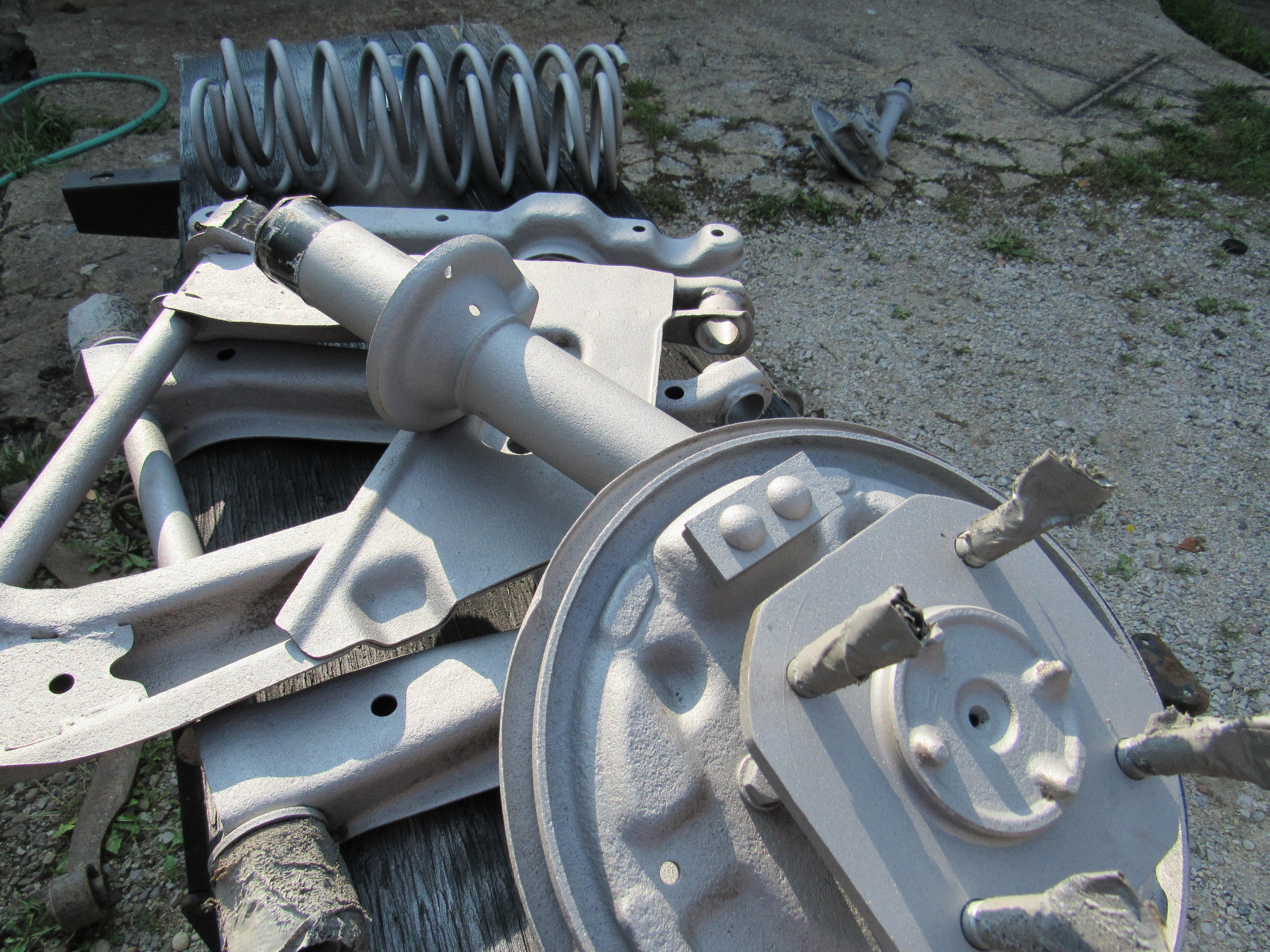

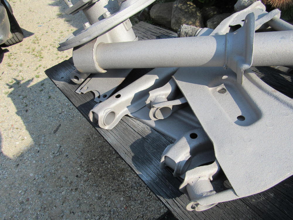

Sandblast, powdercoat or paint...

@grannyknot they do look very good once blasted!.. I will surely go that route. What about the dust shield for the front breaks ? They are different from my ‘73, Do they still make these?

Half the issue here will be that undoing a lot of badly rusted stuff can be frustrating and take hours.. If the calipers have seized pistons etc.. it might be easier to start with better ones, but the main suspension components will come up good after a blast and powdercoat.
