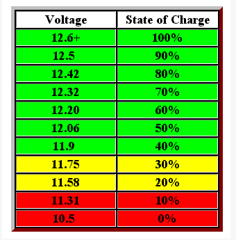

February 20, 20205 yr comment_592825 12 is half capacity. When lead acid batteries get fully discharged bad things happen. I had one in the garage that I kept charged but it went dead a couple of times. Then it was toast. Wouldn't hold a charge. Apparently the plates get coated and don't transfer the lead to the acid. Like having a smaller battery in a big package. There are internet stories about how to save them. Drain the acid, rinse the plates, put new acid in. At the end it might work and you have a bunch of nasty lead contaminated acid to deal with. You can also find methods of charging at high amperage to regenerate the plates, but you have to be careful of hydrogen gas and boiling acid. You can probably gamble on five used batteries and find a winner for less pain. It's a fun subject to study but it gets complex. https://www.rvtechlibrary.com/battery/bat_volts.php Link to comment https://www.classiczcars.com/forums/topic/63587-dead-batteries/#findComment-592825 Share on other sites More sharing options...
