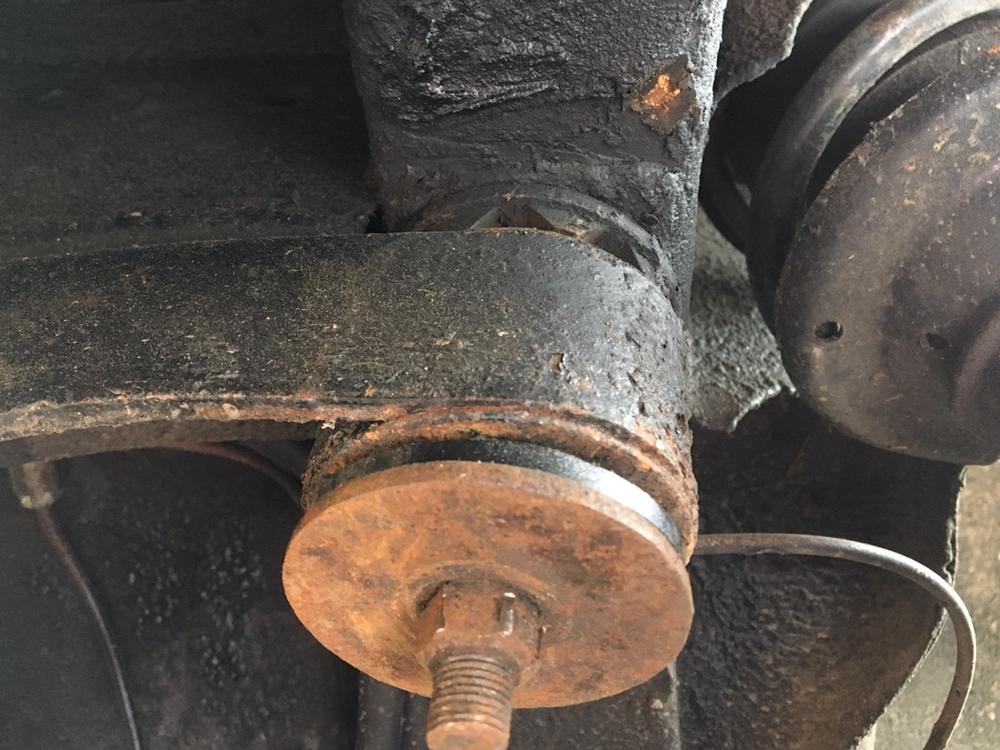

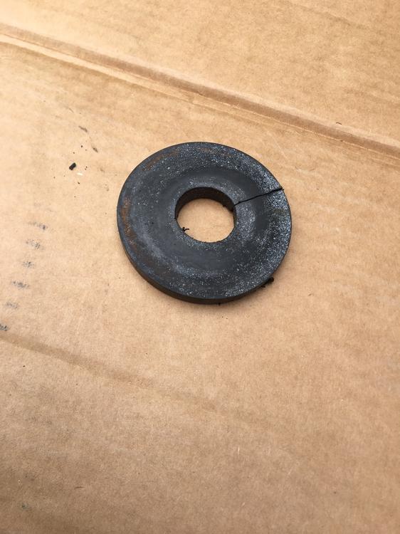

I waited for a number of months until some came up on eBay. People showing them in stock at the time wanted stupid money or didn’t actually have them. They seem to be a rare find and I personally didn’t want to go poly on that bit of the car. They do randomly surface on eBay.
For the serrated washers, I sawed a spare used compression rod poly bush and it turned out to be a near perfect fit that stoped the clonks. A few thousand miles later and it still works. Putting a cut in it meant I could (with difficulty and foul language) force it on without unscrewing anything.

AK260,
Thank you for the input. I checked on eBay before posting and didn't see any but will continue to look. If I don't find any before this spring (the car is in the garage until the roads are salt free) I will try your fix with the TC rod poly bushing as I have several of those lying around. It should be a pretty easy fix as the washers on my car are solid rubber, not the serrated ones and all I have to do is get the thickness correct.
John
Most welcome John. I cut them a little smaller than the gap to allow for some play to allow for where the serrated washer would have compressed in operation. Good luck!
