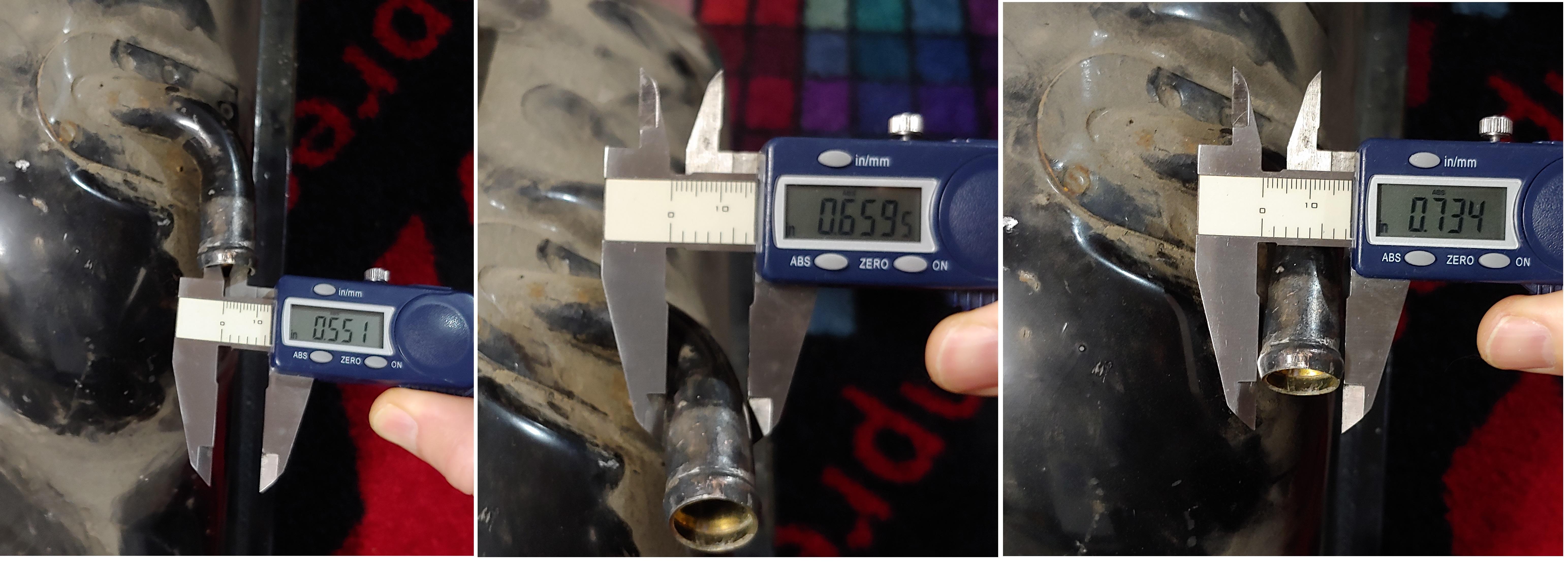

7 minutes ago, CanTechZ said:
My tank is out, here is a pic with the measurements. I have the original hose and it measured 17mm ID (.67"). Hope this helps.
@CanTechZ
Perfect that was exactly what I was looking for. Well done.
That pretty much answers my second question about the critical size of the interior diameter of that vent hose.
