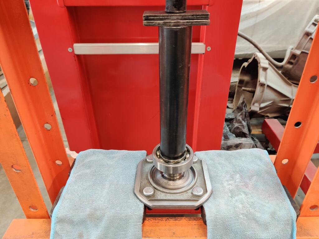

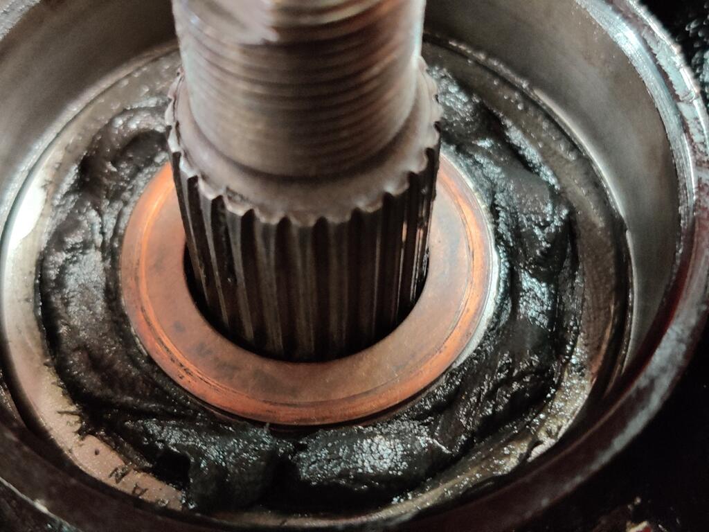

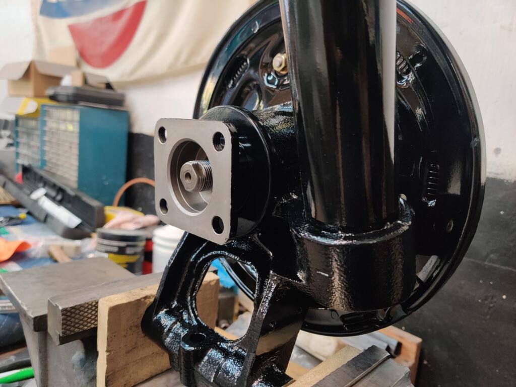

Today, I finished installing the rear axles.  Thanks for the info about not using too much grease @Captain Obvious!

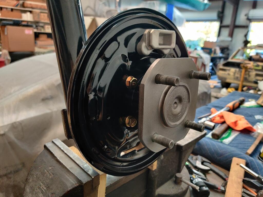

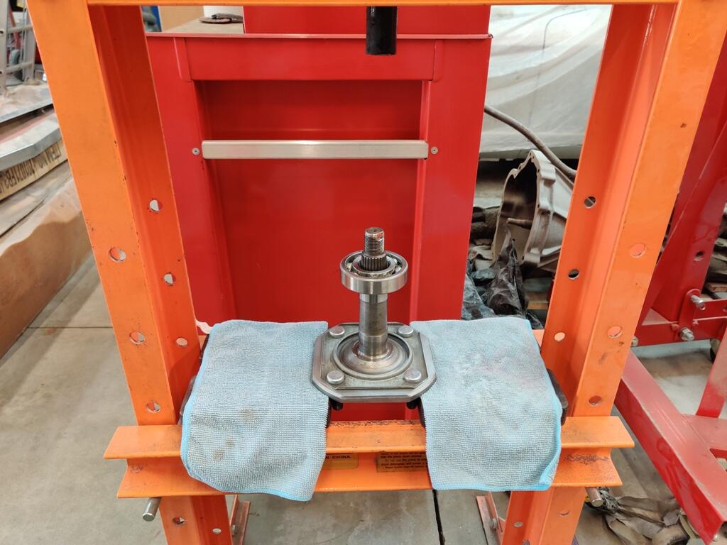

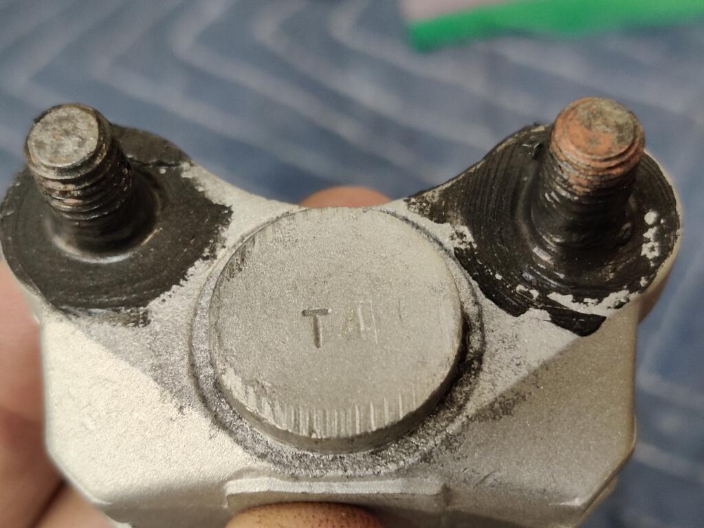

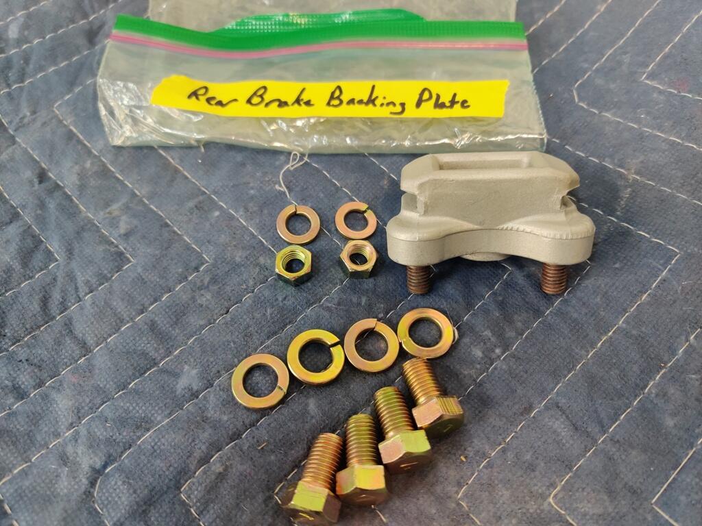

12 ton press in use - and a nice close up of the rear back plate going onto the strut

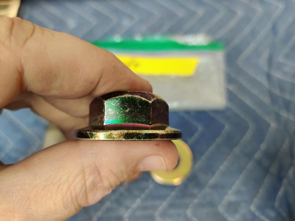

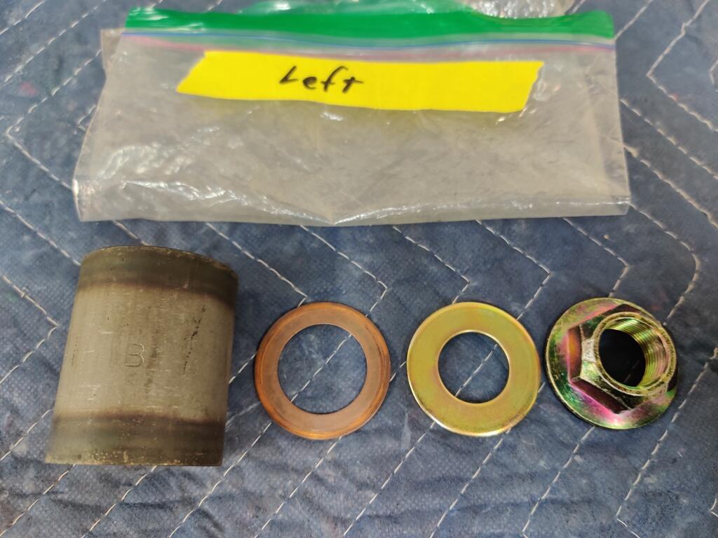

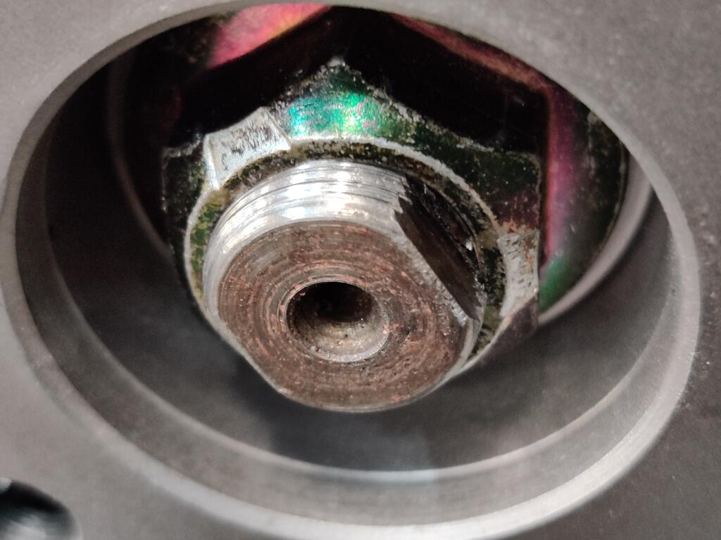

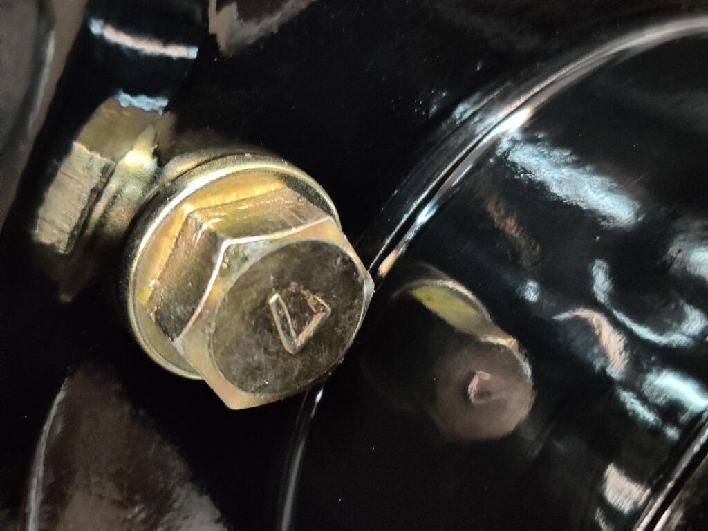

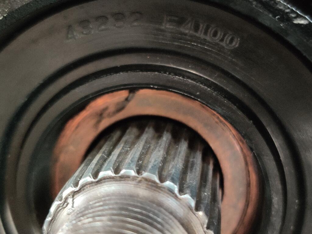

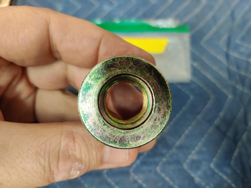

I like to use silicone on some parts such as the brake shoe "block" to keep water from entering and to keep rust from occurring on the threads of such parts.  Note that I have a new style axle nut (third pic):

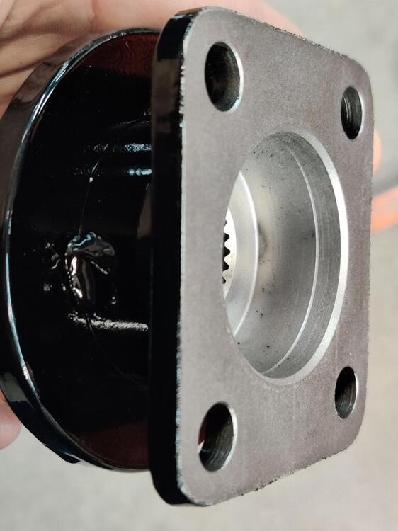

Axle flange is freshly painted and looking good!

Because the axle nut is a newer style, I did not use the large flat washer above.

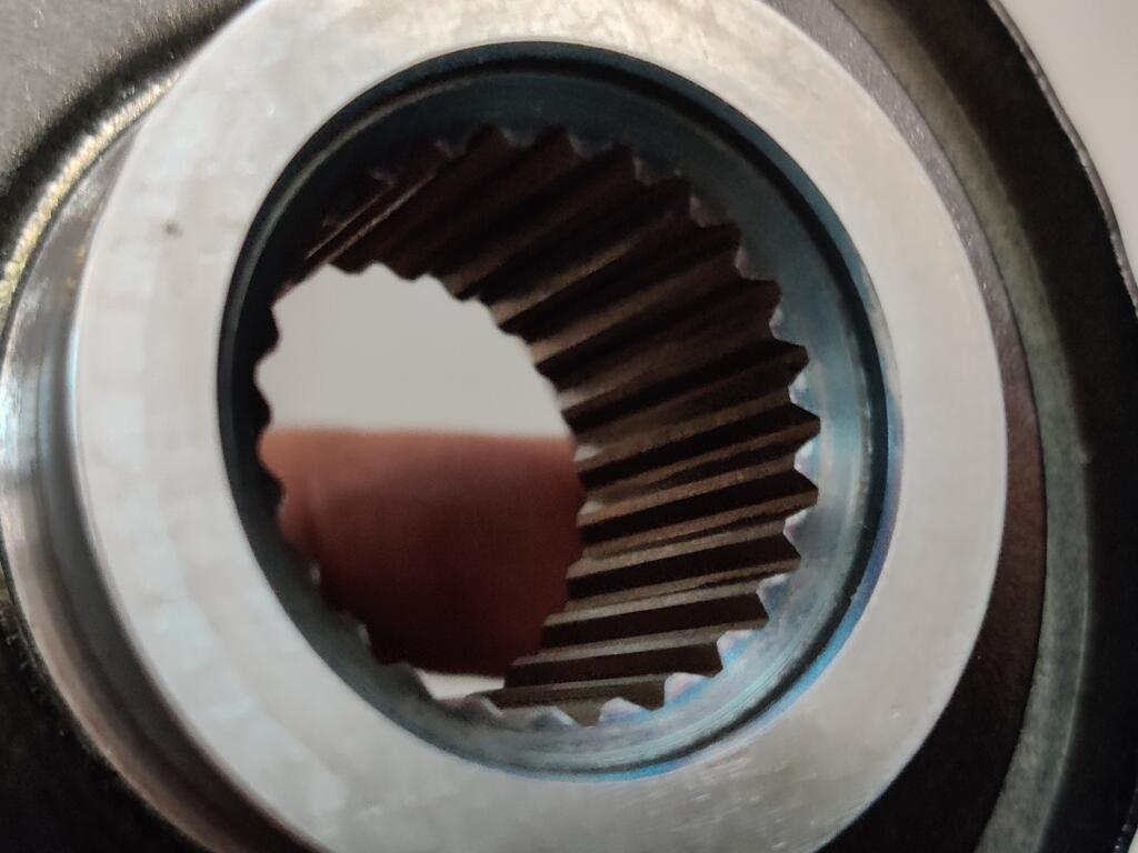

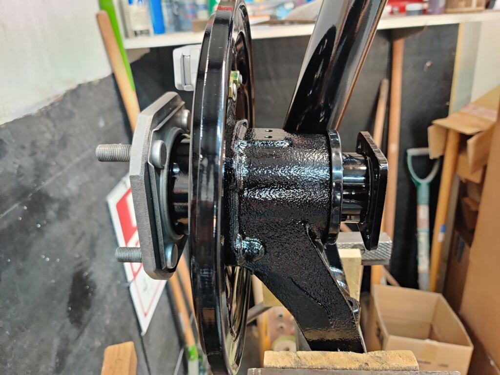

Note axle orientation - axle flange is aligned with hub to minimize weight imbalance.

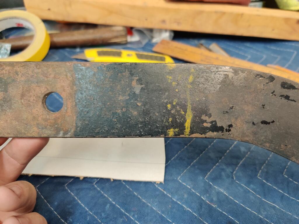

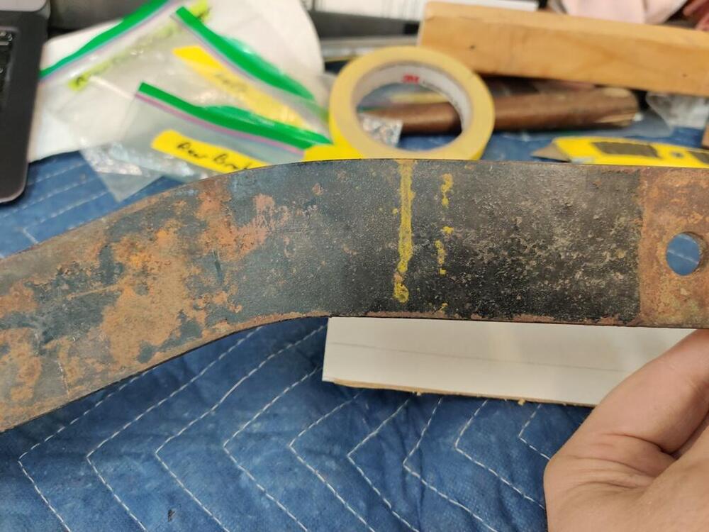

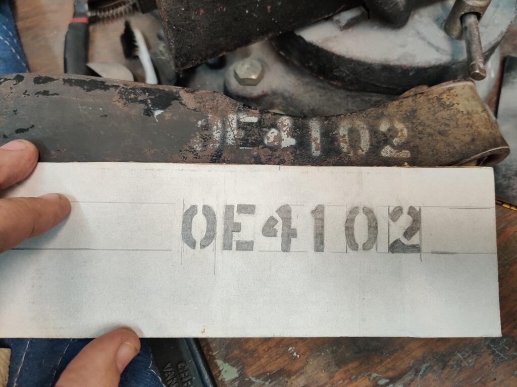

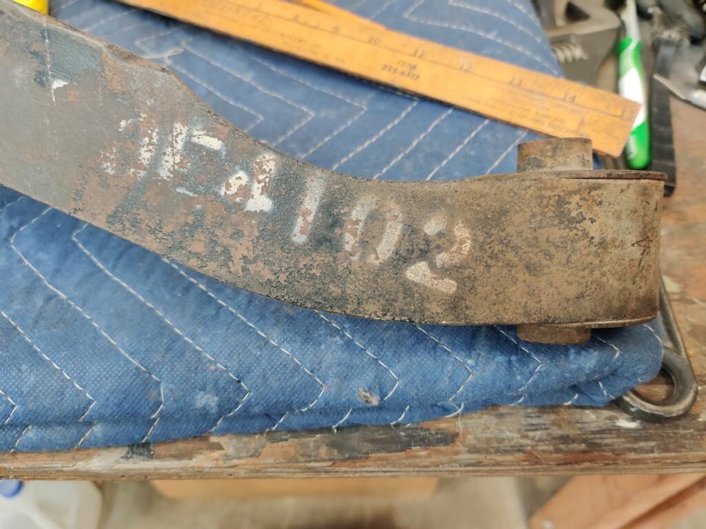

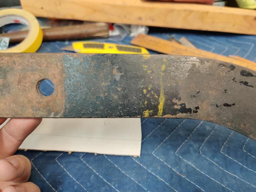

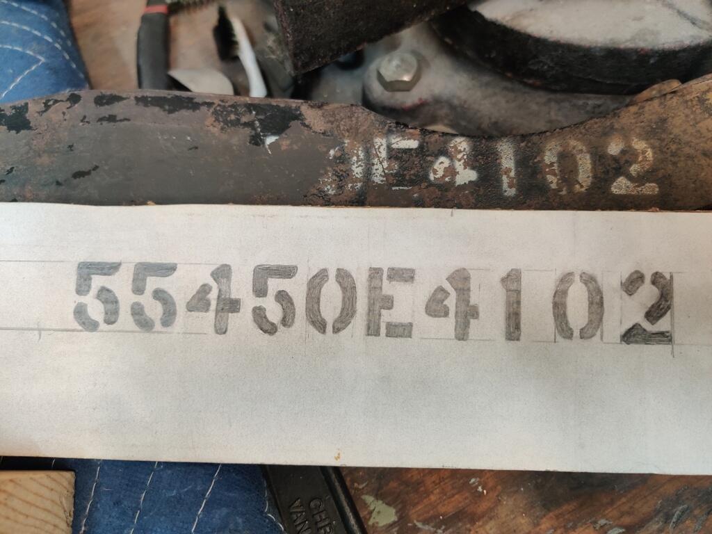

In addition to finishing with greasing the bearings and installing the axles, I worked on a stencil for the part number of the mustache bar.  This bar came with the car.  Note the vertical streaks - are these yellow paint marks from the factory?

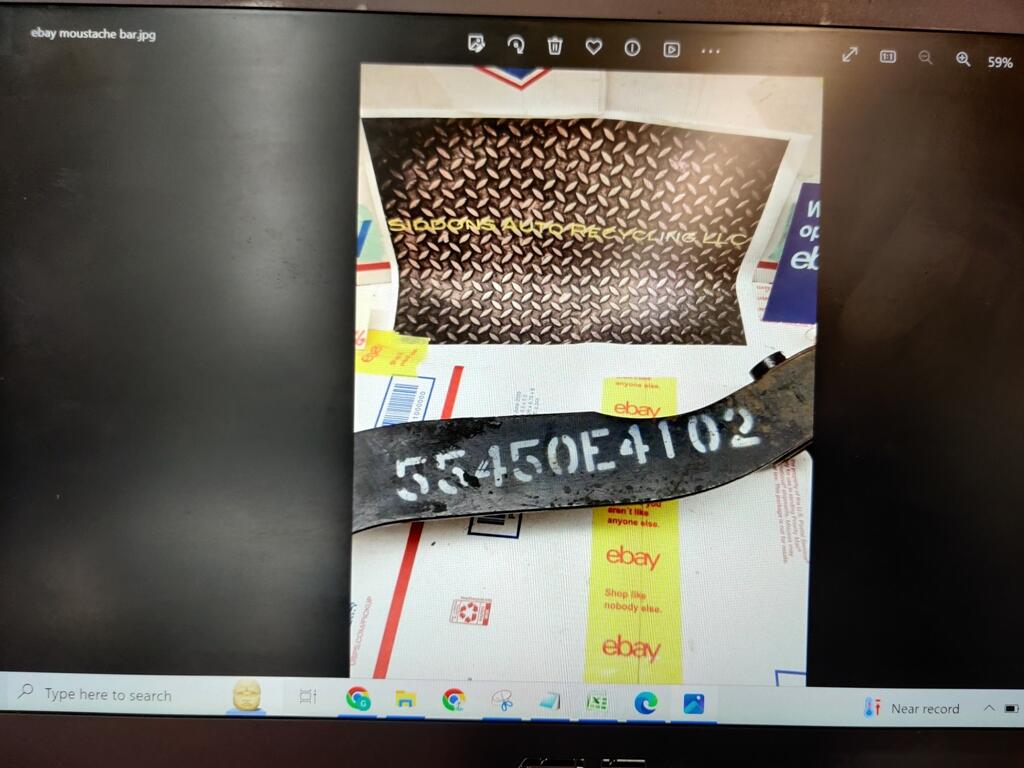

Some of the part number did not survive, so I was also looking at an image from an eBay auction I saved a long time ago as a reference image.
It's not perfect, but it is closer in size to the original than the picture shows - it is a bit closer to the camera lens that the bar.

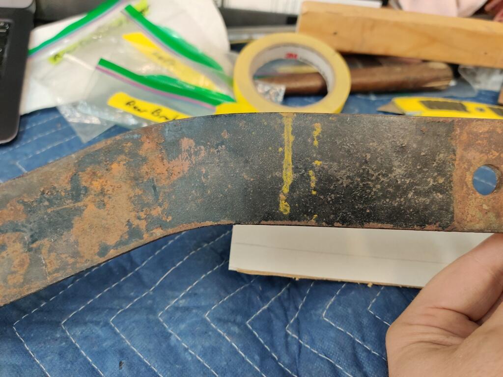

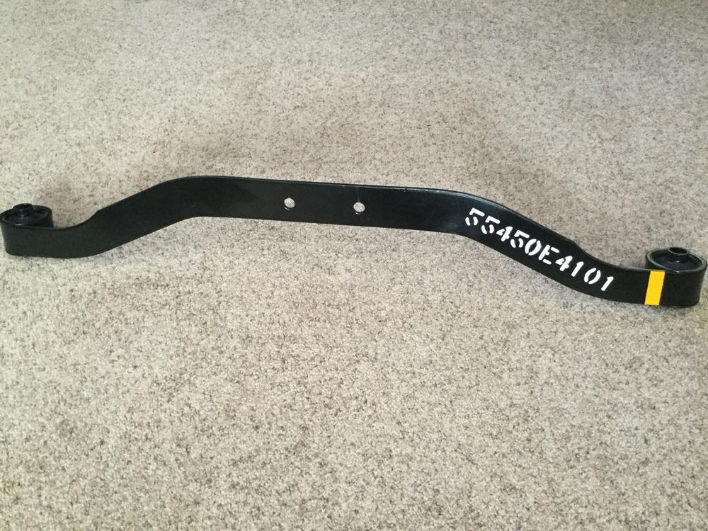

I'm going to take a guess and say that yellow drip mark on the moustache bar is from the yellow paint pen/brush used to mark nuts that have been torqued.
It looks like a drip. However, the odd thing is that there are two... one each side of the bar.  They look to be equally distanced from the center line of the bar.  I saw this pic that @kats provided at some point which has a solid yellow stripe:
Looking again, it looks to me like there are two yellow lines on each side.  And the width of the reproduction stripe on his bar looks close to the width of what I see on my bar.  Very different locations though.

How did you create your lettering template?
Is it something that could be posted in the resources if you were comfortable sharing?
I took a lot of measurements of the example I had and basically drew it free hand.  No objection to sharing, but how is best to do that?  Uploading a photo isn't going to be very helpful.  Is there a way to share it in actual size?

On the template, do you have a way to scan documents. If you do, you could scan it in several passes. It should print pretty close to 1:1
Unfortunately, Chester and Herod went out of business several years ago.  So, they are no longer an option.  I have a scanner somewhere.  Will have to see if I can get that to work.
