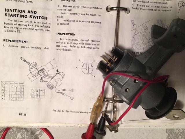

2) the ignition switch tested out fine except there was no continuity between the two red wires with the key inserted or in any position.
Could this mean the ignition switch is shot? Is it repairable? ignition switch.jpg
I repaired one once.  It depends on what's wrong with it.
The two red wires are for the steering lock switch.  You want to test between the pins on the end of the switch, using the chart with B, S, IG, and A.  The circles with a line between them indicate when there should be continuity.

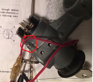

You can also plug it back in turn the electrical part alone.  I had a switch that would not turn the electrical part far enough.  I had to twist the rod between the mechanical and electrical parts.  Take the two screws out and use a screwdriver to turn the electrical switch.  You'll see the little flat rod that turns it when you take it apart.  You might have to destroy one of the screws, Nissan made them one time use as an anti-theft measure.
The pins tested out correct as per the diagram. I jumpered the solenoid to the battery and the starter spun like a champ.
I connected a multimeter to the wire that connects to the small connector on the solenoid and it showed no power when I turned the key.
I'm assuming that the two red leads don't need to be connected for the starter to start because I didn't bother since they only works the steering lock.
My next step, I assume, is to see if power is going to the ignition switch. I have a wiring diagram so I'll start tracing.
