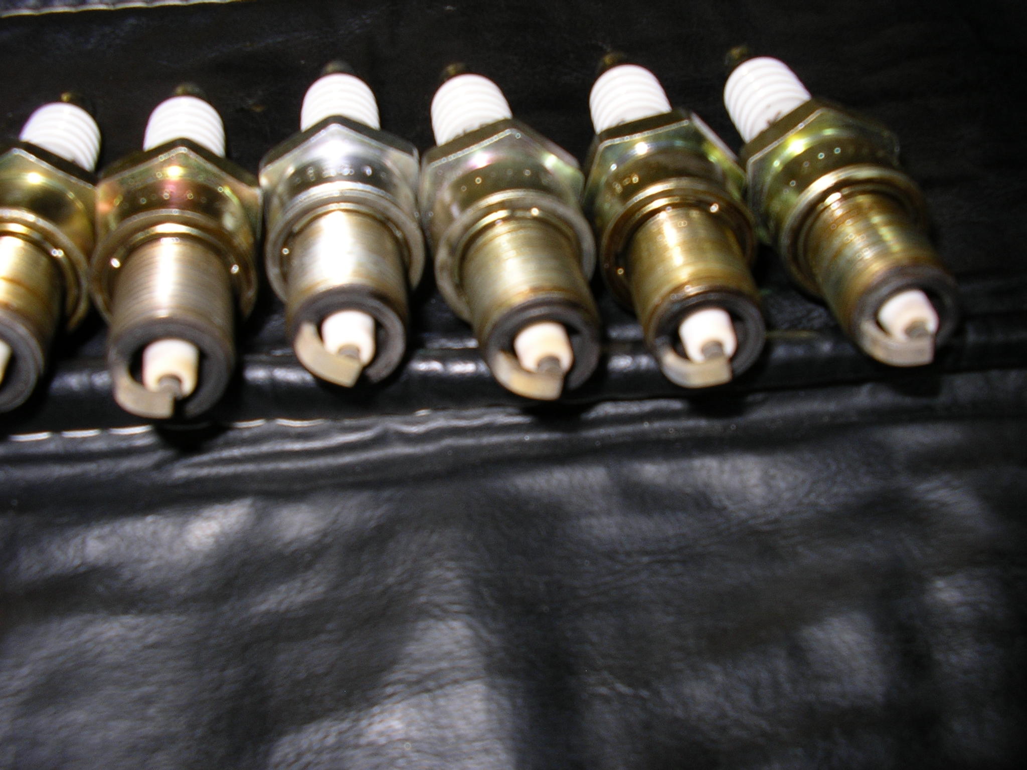

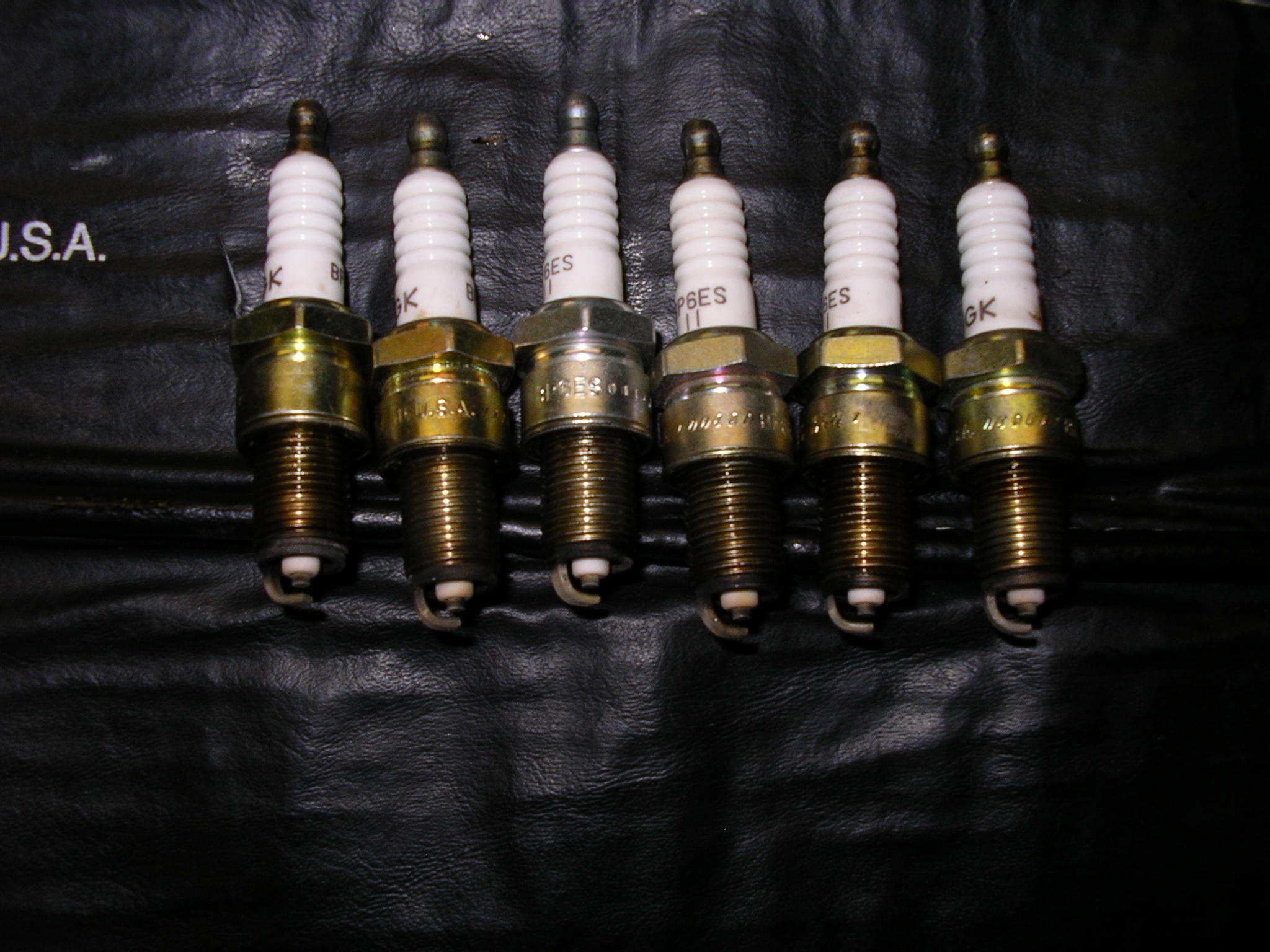

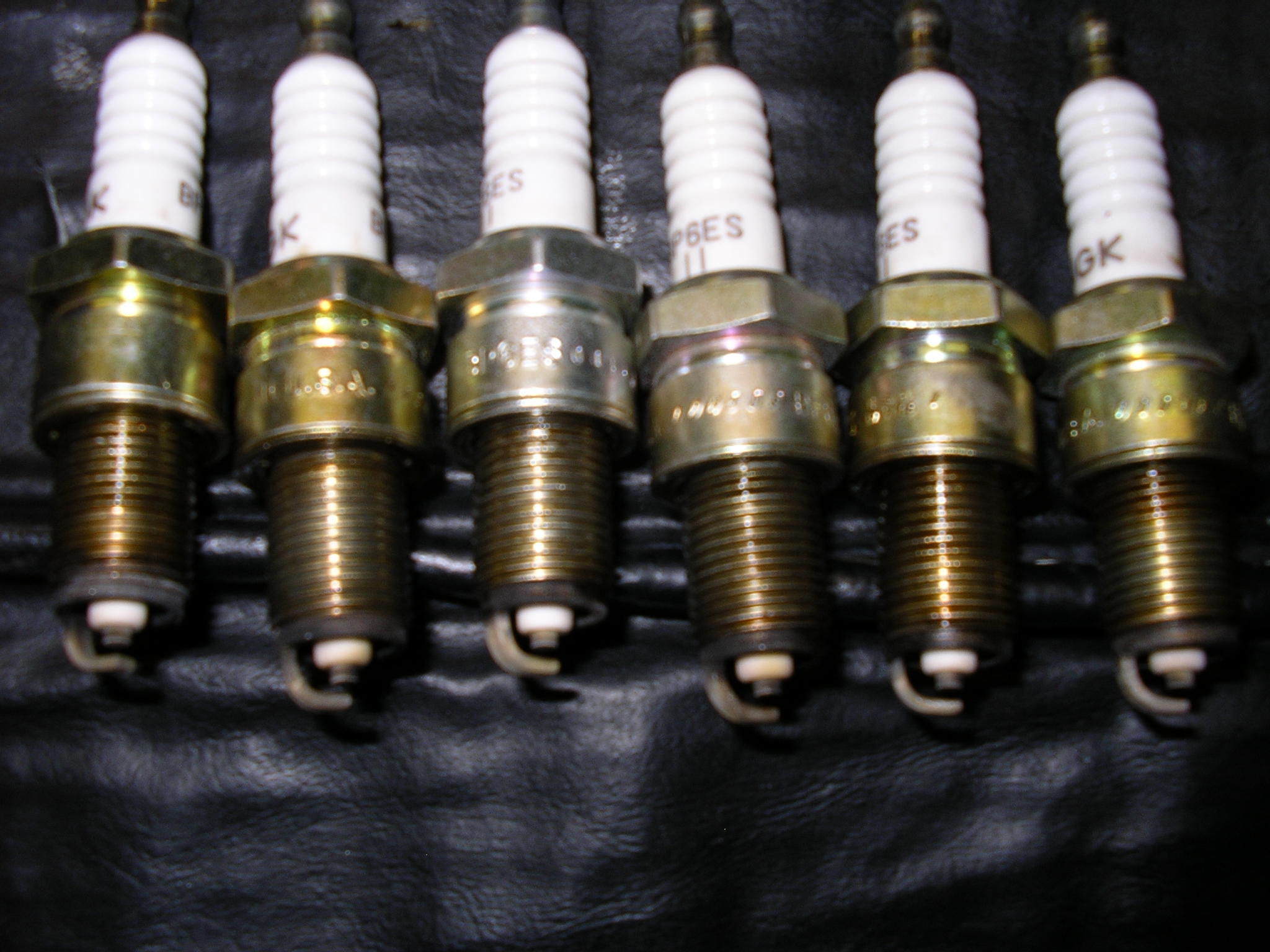

well I tried marks suggestion checking the choke and when I pulled the choke on a little it was idling better so I richen both carbs a 1/4 turn down and rebalanced the carbs and it is a lot better . must have been a little lean for the L28 motor. also the temps are a lot cooler here now but still have the humidity .I so she runs  a lot better now with the rpms idling in gear at 675 and pretty steady with barely any shacking of the motor. I  put 20 miles on the car today and pulled the plugs to see what is going on . here are the pictures you asked for mark the  plugs from left to right are 6,5,4,3,2,1 thanks
 Plugs are looking good. I actually thought it might be running a bit rich. The SU chokes are a great way to check for a lean mixture. How many turns down are the mixture screws now?
I was about 2 1/2 down, but  I would have to check again when I pull the air box off for easy access to them . but I think about 2 3/4 down now but I am guessing. great idea never thought about checking with the choke!! l will let you know tomorrow on the turns down kully
Edited by kully 560
 If the mixture screws are within 2 1/4 - 2 3/4 turns down it indicates the float levels are close if not spot on. Great news. Random question. What weight oil are you using in the carbs?
