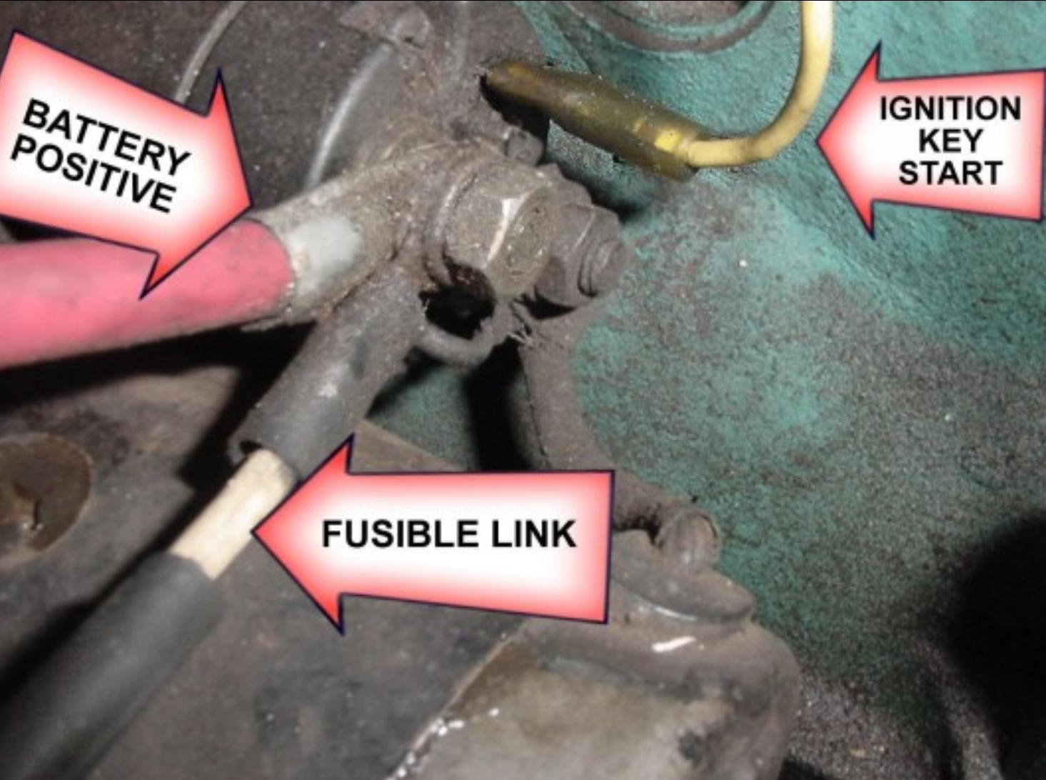

With photo
Thanks for that tip about running the fuel pump without cranking the engine in the '78Z.  Just to be clear...when you say "remove the spade terminal from the starter"....do you mean removing the spade connector from the larger/fatter wire in the photo above?  Isn't that the large negative wire from the battery?
No. It's the little spade terminal next to the large M8 stud terminals on the solenoid. It is the wire that activates the starter.

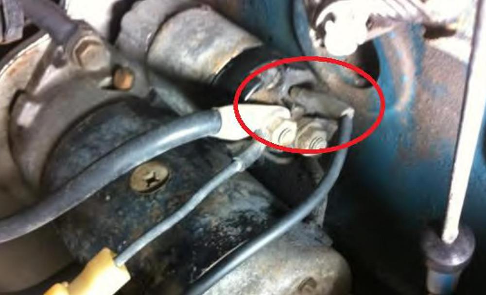

This photo might be clearer.
Edited by EuroDat
I just unplug the small wire by hand and use a large flat screwdriver to short the +12V cluster connector to the exposed connector.

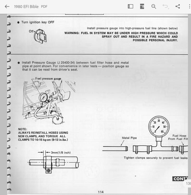

5. Fit a pressure gauge in the line after fuel filter (see photo of efi bible) and run pump again using key in start position. You shouls see 36psi.
6. Stop pump and see if system holds pressure. I'll post a leak down test for that later if you want.
