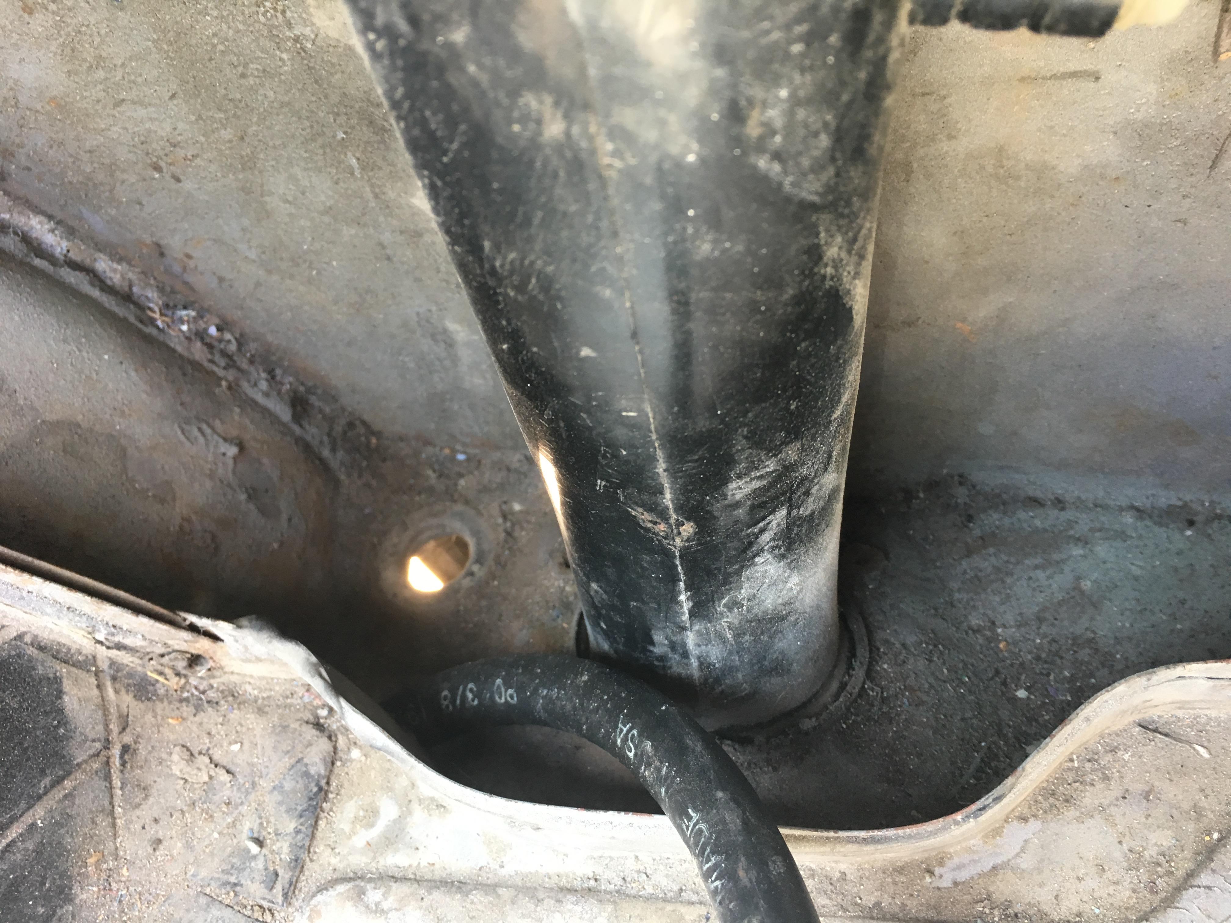

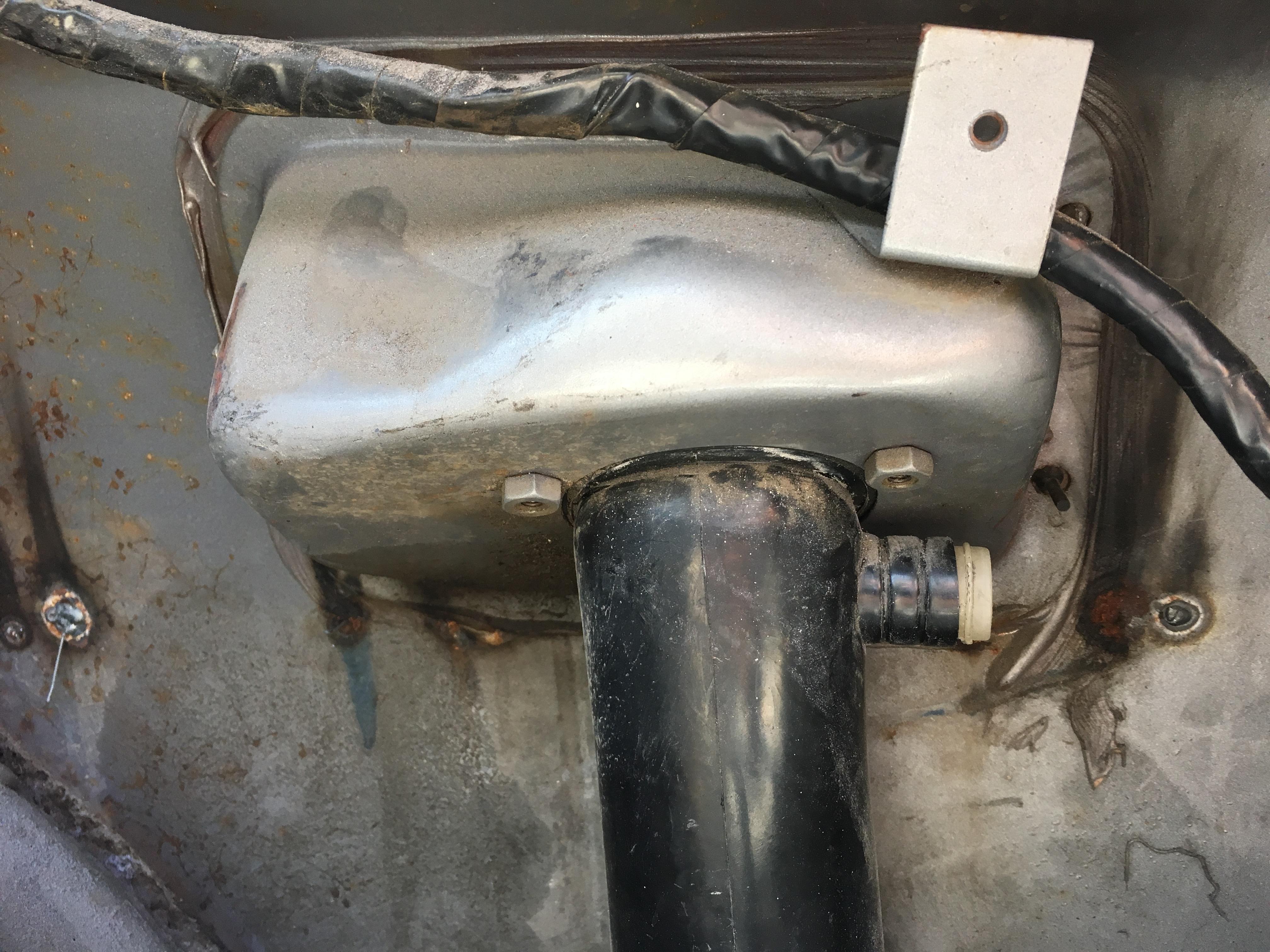

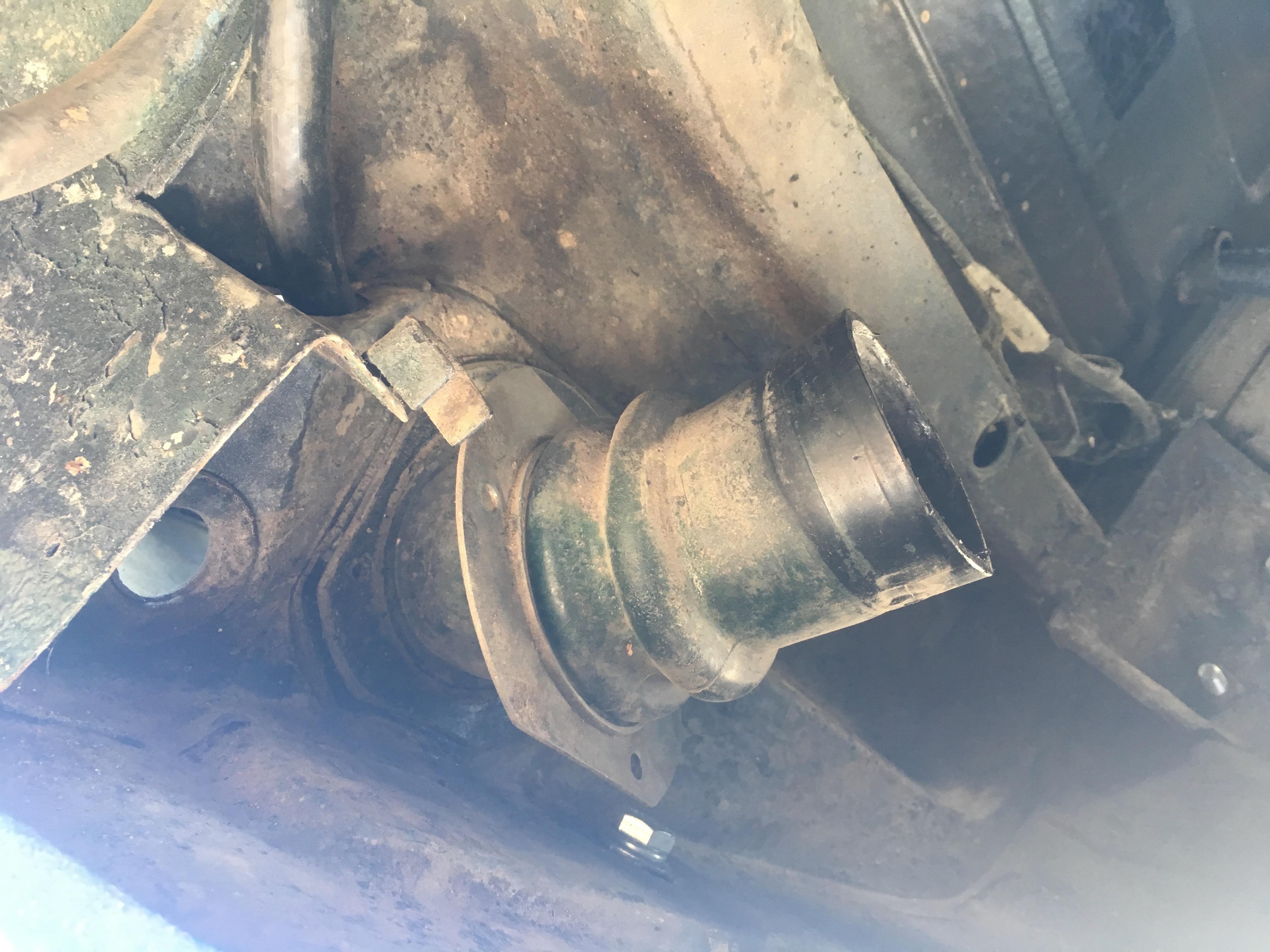

This morning tried to remove the plastic filler neck, take it downtown to Z Car Garage for identification.  Can't figure out how to remove it w/o cutting it in half!
From the images, can anyone confirm that the plastic filler neck is a 240/260 part vs a 280 part?
Thanks
The older those fill tubes get, the harder they get.  Old ones are very hard to work with.  When installing the tank, usually I put it on a small board with cloth over it and SLOWLY lift the tank into place using a floor jack.  The most important thing is to align the filler tube with the tank opening once they are close.  Put the collar of filler tube around tank opening at this time.  DON'T forget the clamp!  As you slowly lift the tank, carefully feed the vent hoses through their openings as you lift.  Attach all hoses before you lift into place as they are very hard to access once tank is installed.  Should be two hoses toward the rear of car and one in front of tank (goes to vapor tank).  That is the process I use.

Thanks for the clarification!  Good to know that I don't have to remove/replace the plastic filler tube.  I'll go back to trying to fit the tank fill neck into the filler tube.  The car is on jack stands with the passenger side rear wheel removed.  Have a motorcycle scissors jack under a tank-sized plywood sheet, then a layer of cardboard to protect the fresh powder coat.
All vent hoses are connected to the tank and routed into the body.  Thanks for the tip on connecting the fuel filler tube!
The hose is actually rubber. It's just gotten that hard over time. A heat gun or boiling water can help make it more pliable to get it out or to get the tank neck into the tube
