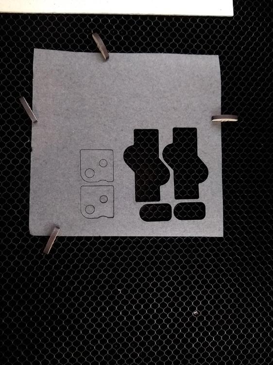

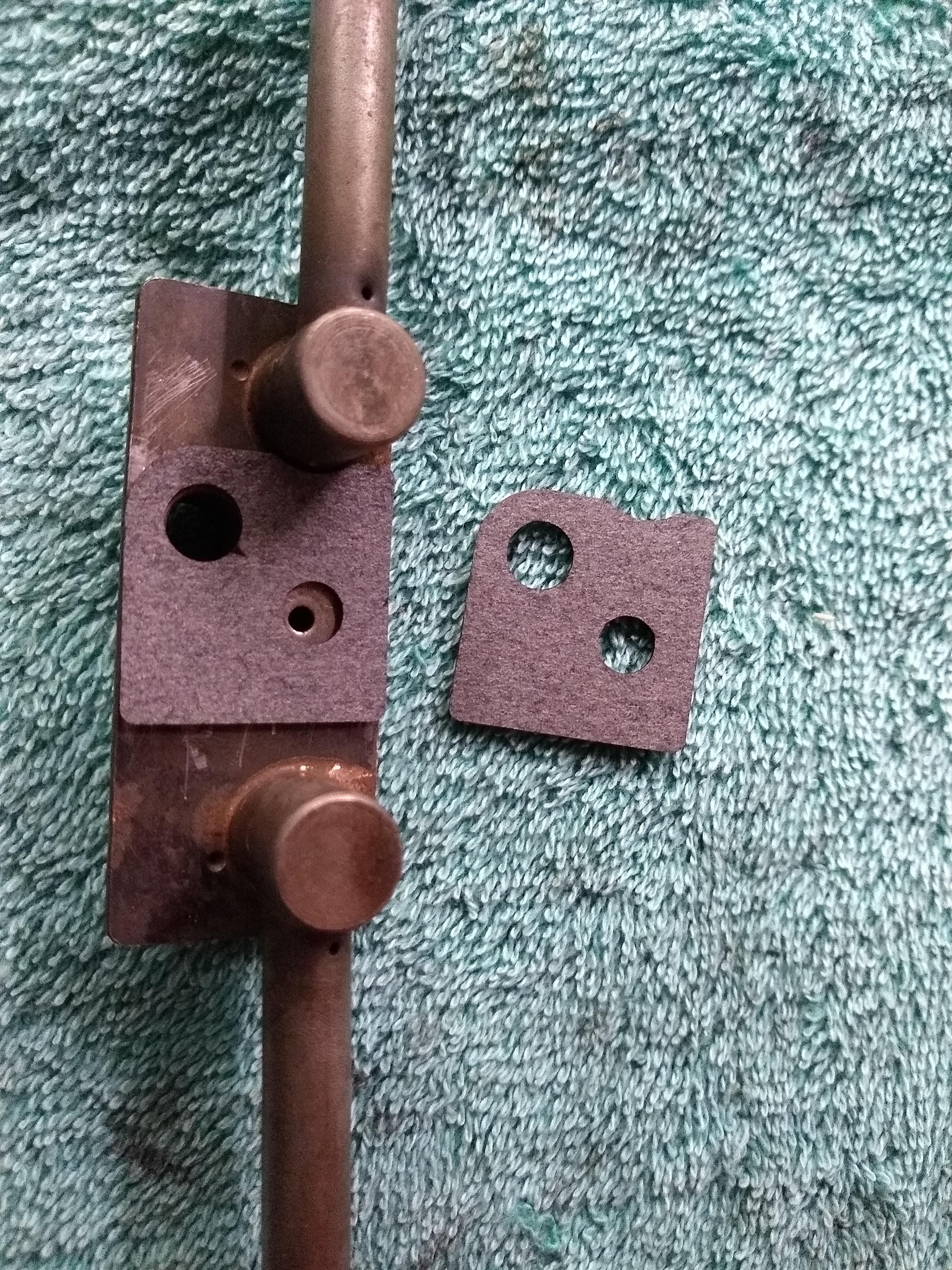

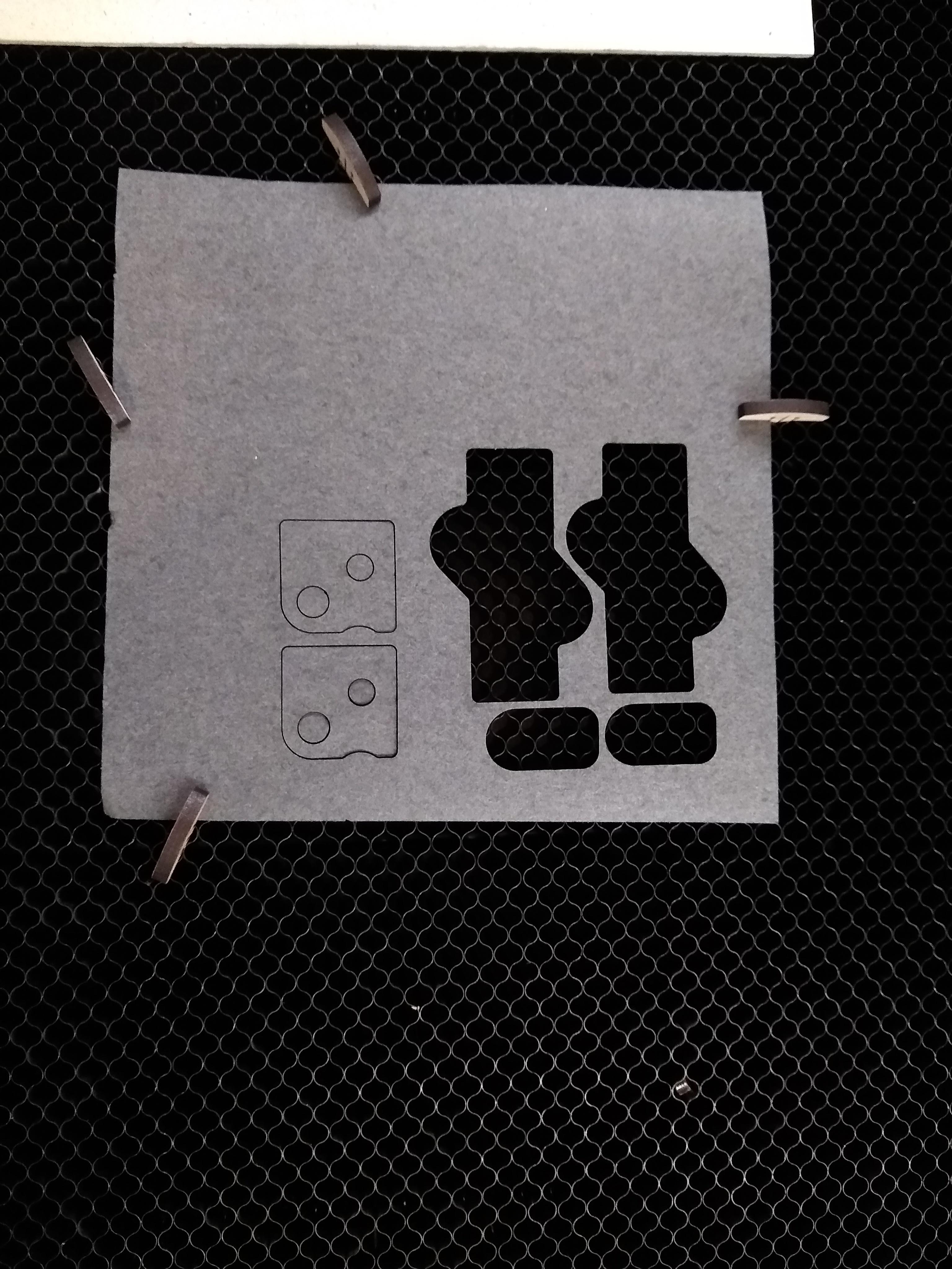

August 1, 20196 yr comment_580957 My laser cutter makes gasket making super quick and easy. File attached if someone needs it. I've decided to fit the newer version of the spray bar. Oil Spray Bar Front GasketV5- large.svg Edited August 1, 20196 yr by scotta added details Link to comment https://www.classiczcars.com/forums/topic/62574-camshaft-oil-sprayer/?&page=2#findComment-580957 Share on other sites More sharing options...
