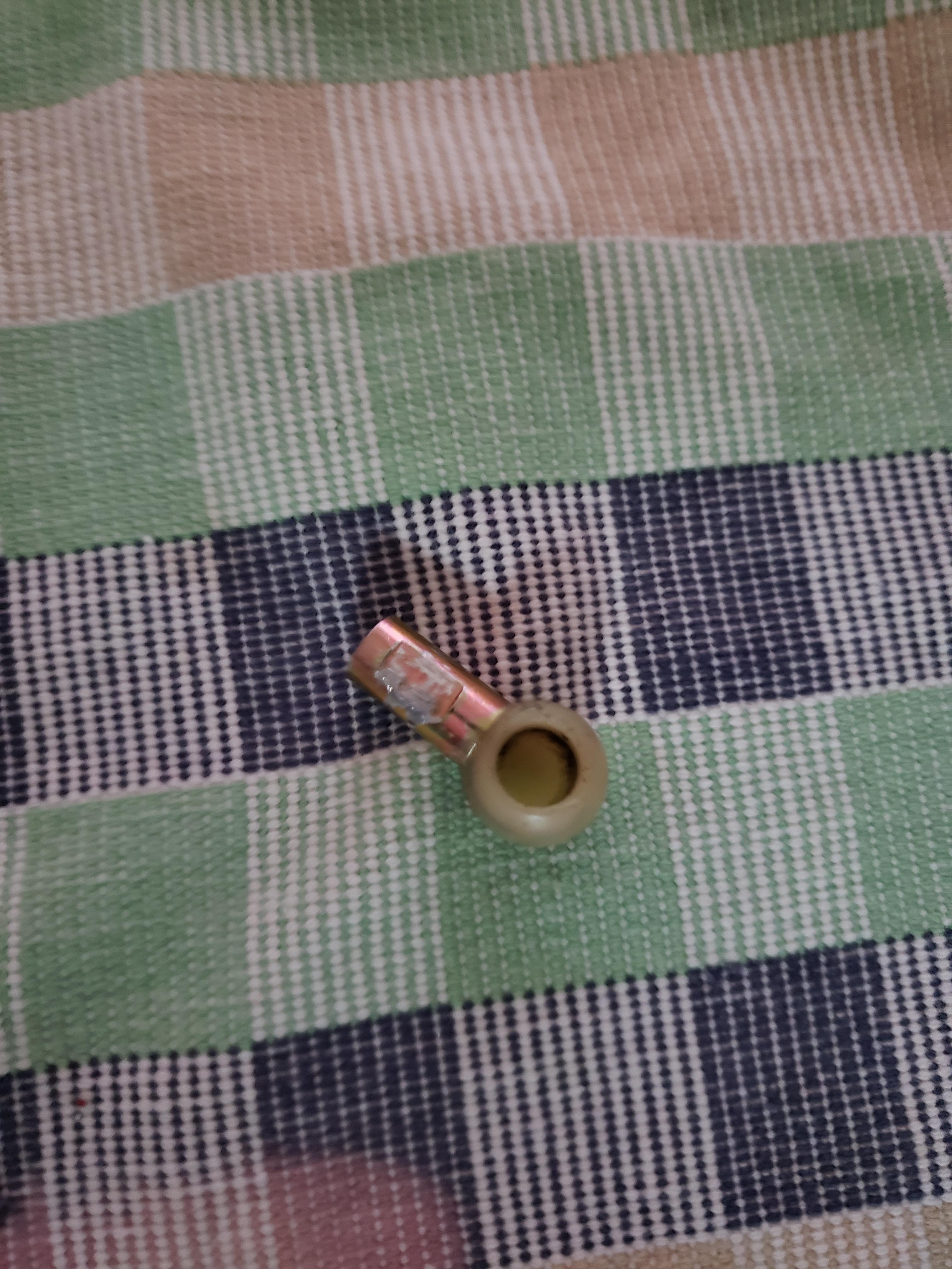

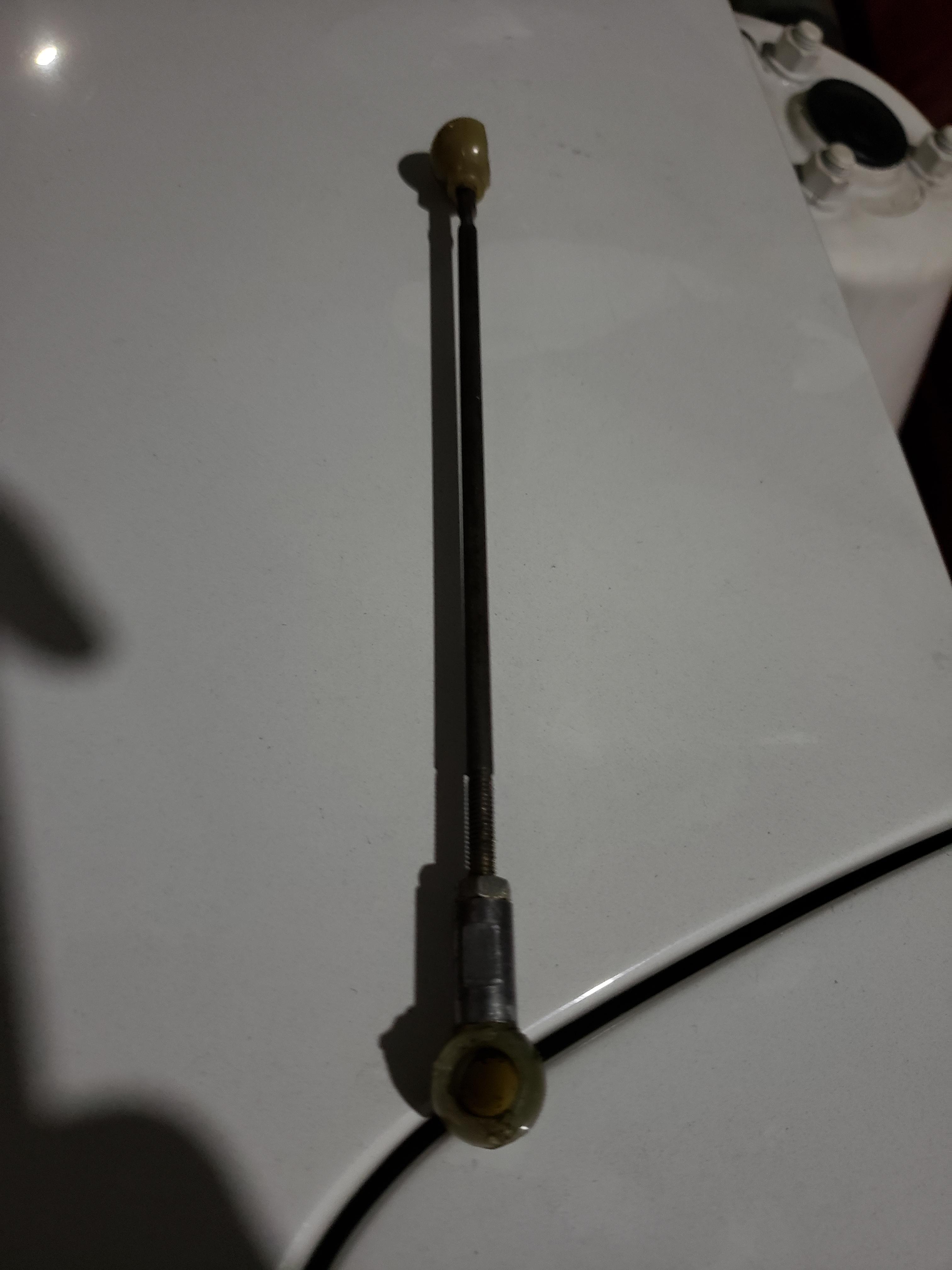

May 30, 20196 yr Author comment_576597 I had to use a pressure plier to grip the linkage and another plier to remove the end with the ball shown in the picture. Is this the correct procedure? I wouldnt like to break the metal linkage. Link to comment https://www.classiczcars.com/forums/topic/62158-long-throttle-linkage-replacement/?&page=2#findComment-576597 Share on other sites More sharing options...
May 30, 20196 yr comment_576605 Polishing up the new end makes sense, only the metal and stay away from the plastic ball. Be careful to not take off the plating... Then re-assembling the ball end with the threads should be easy. Just be sure as previously stated to note the Center-to-Center ball distance from your original rod. Once cleaned the ball can be easily screwed onto your good shaft, just clean your threads on the shaft before attaching. The nut on your original rod is used to lock the threaded ball end at the correct length and orientation. There should not be any significant force torquing the threaded ball end on. Good luck... Edited May 30, 20196 yr by moritz55 Clarity Link to comment https://www.classiczcars.com/forums/topic/62158-long-throttle-linkage-replacement/?&page=2#findComment-576605 Share on other sites More sharing options...
May 31, 20196 yr Author comment_576640 The plastic ball cannot be removed by itself it seems glued to the metal part so the only option is to unscrew the complete part from the linkage stem. How do you clean the threads once you remove the part? Link to comment https://www.classiczcars.com/forums/topic/62158-long-throttle-linkage-replacement/?&page=2#findComment-576640 Share on other sites More sharing options...
May 31, 20196 yr comment_576645 Correct. Unscrew it from the rod. The threads can be cleaned with a fine wire brush. Link to comment https://www.classiczcars.com/forums/topic/62158-long-throttle-linkage-replacement/?&page=2#findComment-576645 Share on other sites More sharing options...

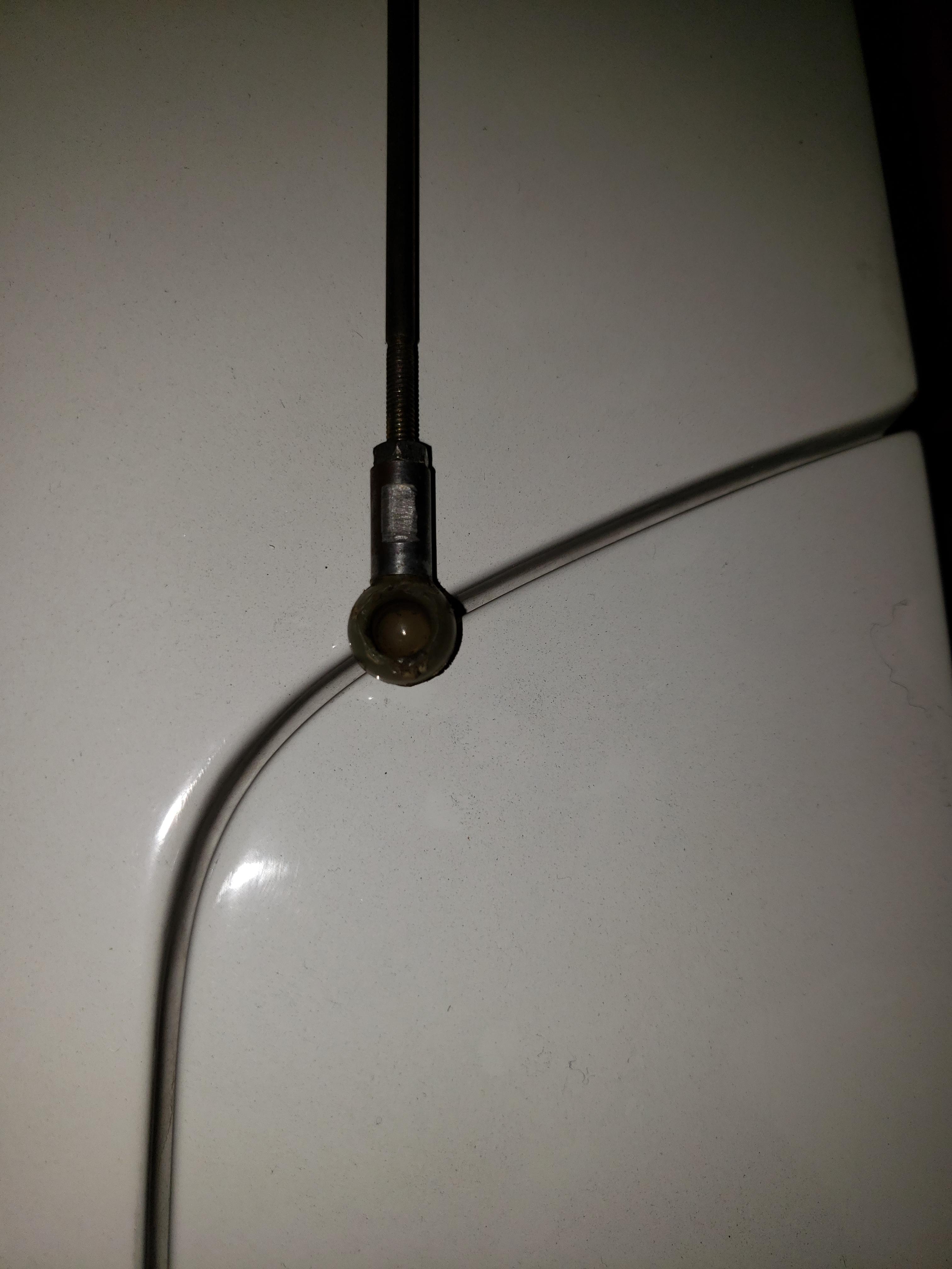

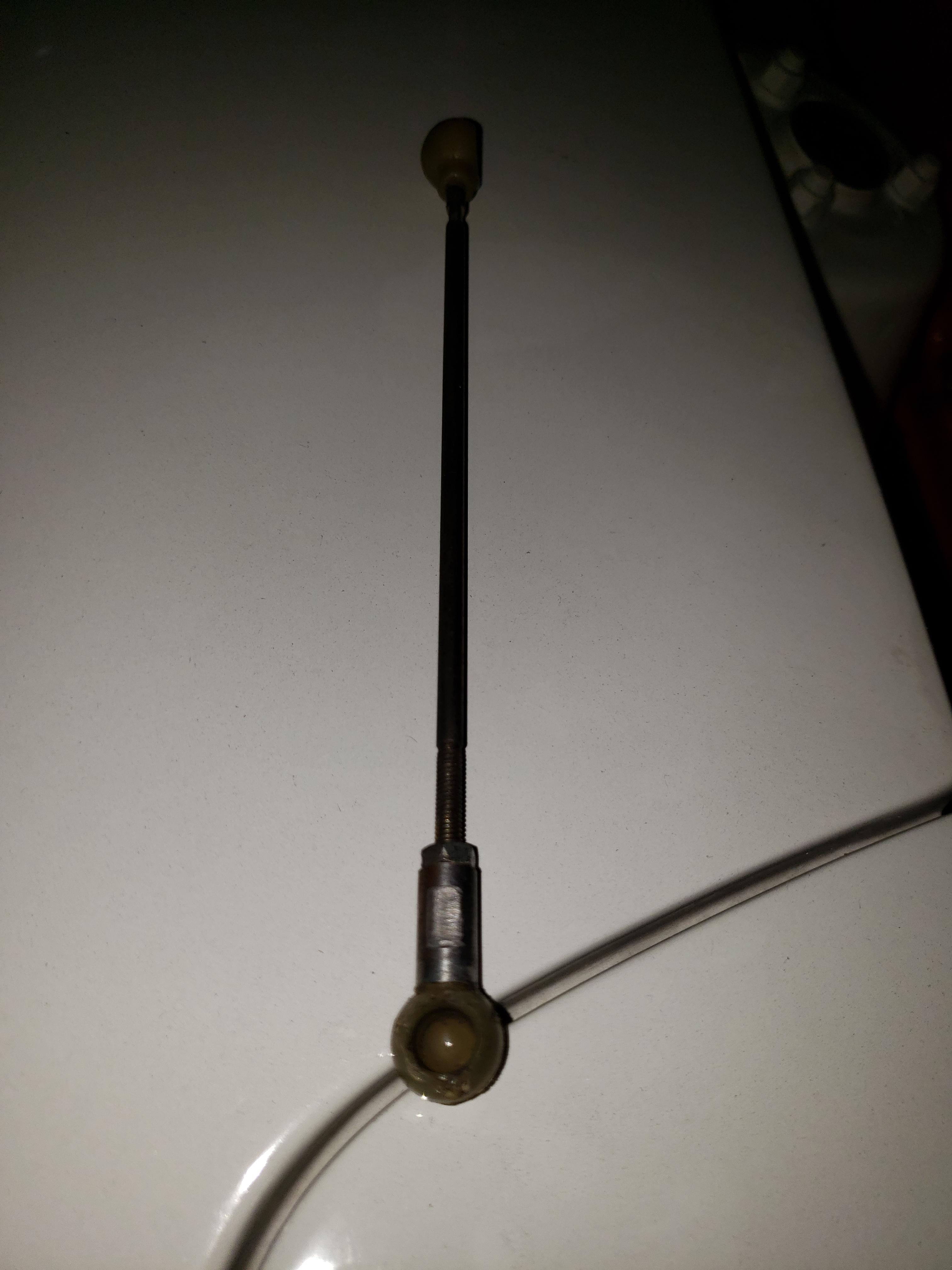

June 2, 20196 yr Author comment_576795 I took a couple of pictures of one of the plastic ball ends of the long stock linkage that i have installed. Do you really think its worth all the hassle of removing the stock one and installing the other one? The plastic ball end does not look cracked just a little bit worn. Link to comment https://www.classiczcars.com/forums/topic/62158-long-throttle-linkage-replacement/?&page=2#findComment-576795 Share on other sites More sharing options...
June 2, 20196 yr comment_576802 You can pop those off in a second with some needle nosed pliers. Put them under the ball against the metal and pull up. Edited June 2, 20196 yr by siteunseen Link to comment https://www.classiczcars.com/forums/topic/62158-long-throttle-linkage-replacement/?&page=2#findComment-576802 Share on other sites More sharing options...
June 2, 20196 yr comment_576806 No need to remove the ball if it's in usable condition. Save any good pieces of the linkage for repairs in years to come. Link to comment https://www.classiczcars.com/forums/topic/62158-long-throttle-linkage-replacement/?&page=2#findComment-576806 Share on other sites More sharing options...
June 2, 20196 yr comment_576807 I’d grab one from a salvage yard. I see them all the time when I find a Z. I’ll start grabbing them now that I know they’re so expensive. Sent from my iPhone using Tapatalk Link to comment https://www.classiczcars.com/forums/topic/62158-long-throttle-linkage-replacement/?&page=2#findComment-576807 Share on other sites More sharing options...

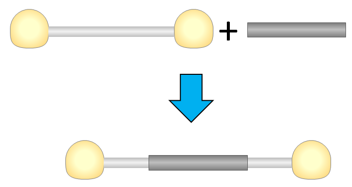

June 2, 20196 yr comment_576810 You can modify these easily if you have a few spares. Just get the appropriate tap and die and use an appropriate small tube to couple. I used a brake line as a makeshift coupler. I cut it to lenght the ran a tap into each end to make a thread. I then took a small ball and socket shaft and cut it in two. Each cut end was threaded with a die then screwed and glued into the brakeline mid section. Here is crude example: Link to comment https://www.classiczcars.com/forums/topic/62158-long-throttle-linkage-replacement/?&page=2#findComment-576810 Share on other sites More sharing options...
June 2, 20196 yr comment_576811 Since you now have two threaded removable ball ends, just buy a piece of rod and cut threads into the ends then attach your two ball ends. A machine chop can turn a nice piece of ss rod to the right diameter and cut the end threads! Edited June 2, 20196 yr by 240260280 Link to comment https://www.classiczcars.com/forums/topic/62158-long-throttle-linkage-replacement/?&page=2#findComment-576811 Share on other sites More sharing options...

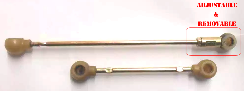

June 11, 20196 yr Author comment_577403 how exactly do you remove the ball end with the nose plier without breaking the plastic? Link to comment https://www.classiczcars.com/forums/topic/62158-long-throttle-linkage-replacement/?&page=2#findComment-577403 Share on other sites More sharing options...
June 11, 20196 yr comment_577413 On some rods, only one ball-end is molded on. You can unscrew and remove the other adjustable end. Link to comment https://www.classiczcars.com/forums/topic/62158-long-throttle-linkage-replacement/?&page=2#findComment-577413 Share on other sites More sharing options...
