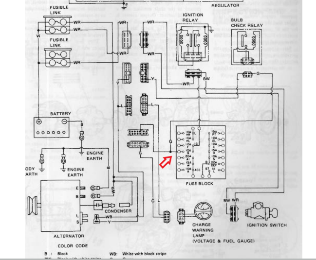

It could be the power supply to the ECU.  There is a ground wire and a power wire, both at the battery terminals.  The power wire has its own fusible link.  Don't get them backward.

There is a fuse that is on the supply wire to the charge lamp circuit.  Seems like the most likely place to start.
Does the Brake light light up when you turn the key on?  That is the other part of the circuit.
Don't forget to check your grounds too.

Indeed, there is no brake red light and buzzing (bip-bip-bip) sound doesn’t comes out either
Is the T plug at the alternator plugged in?  Check for continuity to ground through the bottom leg of the T on the alternator pins if it is.  The alternator is the ground for the two circuits.

Thanks so much for the link! I read through all 7 pages hoping to find somewhere where the fusible link ratings were translated into amps - the previous owner of my 75 280Z has been telling me they are 'fussy'. I'm more than happy to update this & add the H/L relay mod while I'm at it
EDIT - adding the amp rating cross reference link HERE   🙂
Edited by HusseinHolland
It's been pretty well documented that what is shown as a red link is actually a brown link (they're shown in the FSM) and it is also a lower rating (smaller gauge) than the green link (also in the FSM).  I never looked too closely at that chart in the past but now see that it has a yellow and a pink link.  You won't find those on a Z.  Maybe a ZX but not a Z.  (Sorry Blue 246, no offense intended).  Some of the Z car aftermarket suppliers like thezstore.com have updated their fusible link pages to show it.
Don't forget that fusible links are "slow blow" fuses.  Most automotive fuses are meant to fail quickly.  Good luck.
