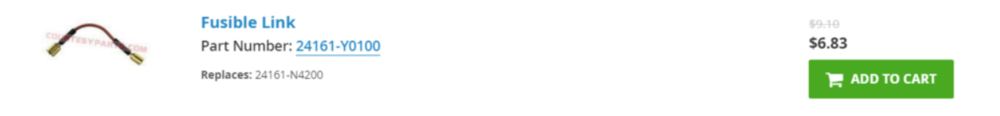

And here's zcardepot's Brown link set.  Probably repackaged Nissan parts.  So the reds are cheaper, but it's not clear what, exactly, they are.
And, even better, I'm pretty sure that you can see "0.3" on the wire itself, and 1.25 on the Black ones.
https://zcardepot.com/products/fusible-link-brown-black-wire-set-oem-280z-77-78

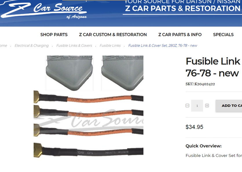

Sorry, just filling out the picture.  zcarsource sells three 0.35 mm^2 links, and a black 1.0 mm^2.  Not terrible, the 1.0 is undersized but won't burn up your wiring.  At least you know what you're getting.
https://zcarsource.com/fusible-link-cover-set-280z-76-78-new

I just ordered a set from Z Car Source.  They mentioned that they make them there but the supplies they use come from Japan.

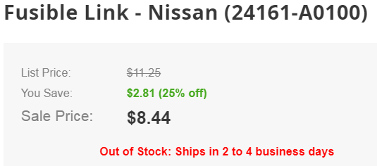

Just curious, this discussion could go on and on, but why didn't you just buy Nissan parts from Nissan?  4 x ~$7 = $28.
On 3/11/2019 at 4:07 PM, EuroDat said:
1x Black p/n: 24161-A0100 (YAZAKIFLWX-1.25)  $8.44
1x Green p/n: 24161-28500 (YAZAKIFLWX-0.5)  $7.51
2x Brown p/n: 24161-Y0100 (FTX-0.3)  $6.83
I seem to remember that there was a short period of time when some of the links were NLA.  Probably why all of these random sizes from random sources popped up everywhere.
But now they all seem to be available from Nissan, for cheap.  Why go elsewhere?  They're even on sale at Courtesy.  "Out of Stock" but it looks like that they still ship.  Maybe they're not really available?
