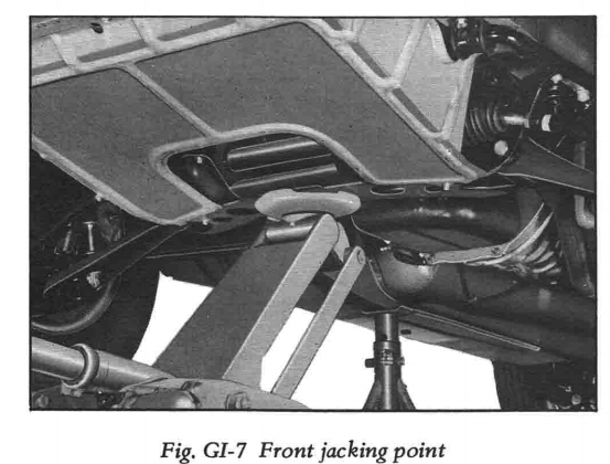

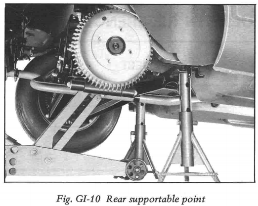

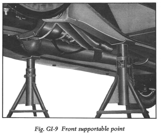

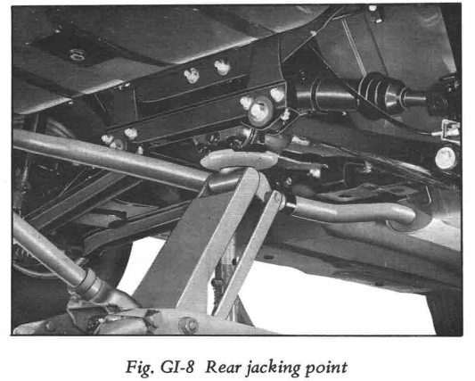

Nice lift, but i will Always use a 4 post lift for my z cars.. esspecially 280zx and 300zx.. they are so heavy that they bend a little on a 2 post lift.. you can't open a door on a z32 when it's on a 2 post lift..  yeah.. opening is possible but try to shut it...
And.. should i say it... oh well... ofcourse you did what loads of mechanics do.. you put the 240z on that lift in the wrong way.. it should be lifted on the 4 jack-stand points.. not under the floor..  (for as far i can see, your's is not lifted on the jack-stand places.. (see manual..)   sorry..
(with the last MOT of my z32 the mechanic almost did this to my z32,  (Lift the body front by lifting it on the thin sheetmetal floor!..) That's why i'm Always with my car at a check..  I freakt out and told the chop owner that i did not want that mechanic (idiot) near my cars! )

It’s not on the floor. I think that would nearly destroy the car

Ok. I did a bunch of research and it appears that lots of people recommend jack placement in the same position I placed mine. It looks like the most obvious place, and appears to also be the strongest support area.  I did lower my car removing any stress. Thanks for the input.
Great pictures. That's exactly where my lift is. Thank you.  I want nothing more than to do it right.  So far this site has been nothing but great.  What an awesome resource.
