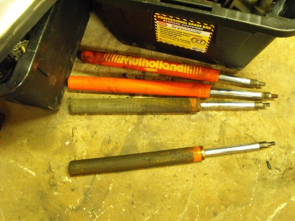

You mean like these, recently removed from my '73?   <grin>
(this brand name was well known in the '70s and 80s, but has now disappeared completely)
https://www.classiczcars.com/forums/topic/61602-mulholland-shocks

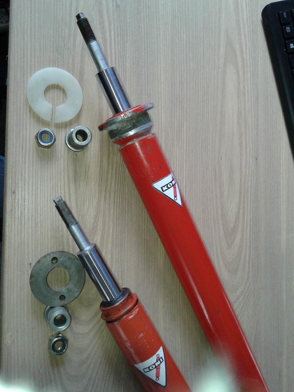

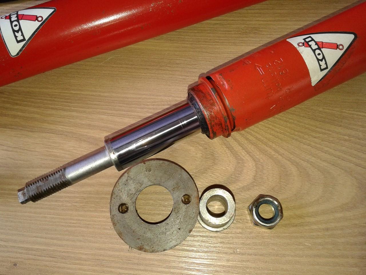

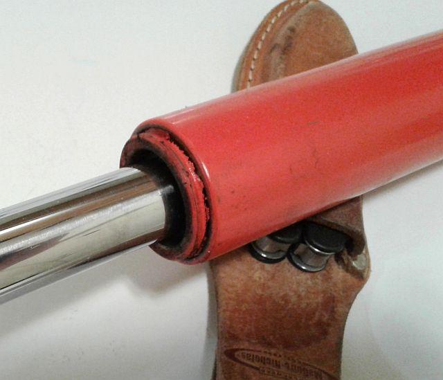

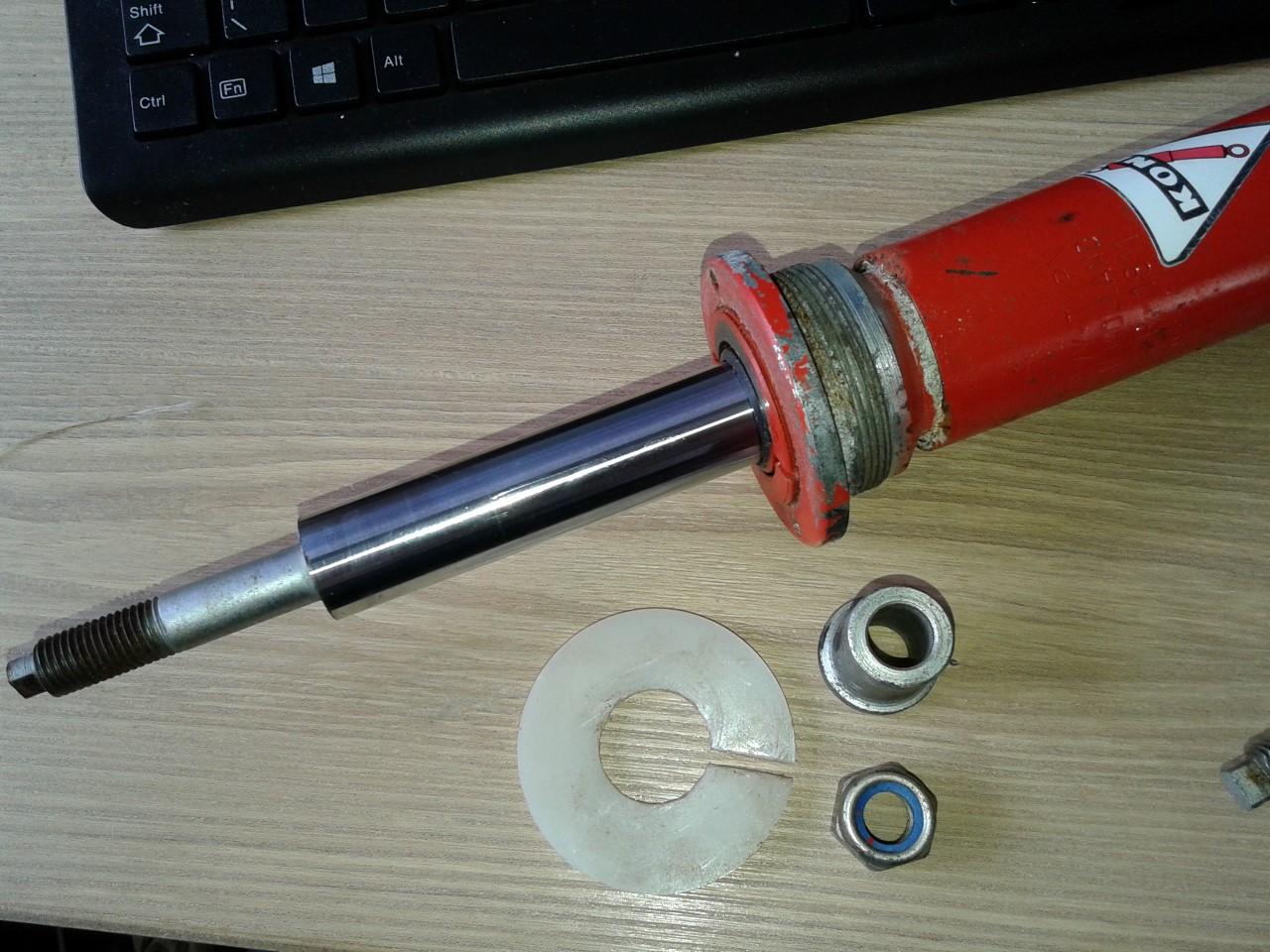

Well.. Thank you very much Mr. Lee Grimes!   Here some pic's from the shocks i've got laying around in my (big?) pile of parts for z/zx..
Front shock 82-R1811
Rear shock 82R-1812
front shock
rear shock
Edited by dutchzcarguy
As said earlyer, these Koni's are new old stock.
I've heard that these were the shocks that where used in the south african rally cars?

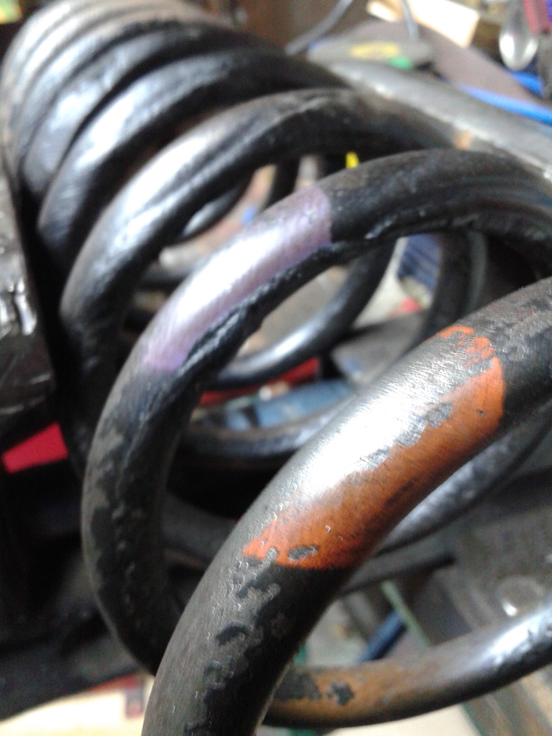

About my spring pic..  I'm 98% shure it's the Original Datsun 280zx 2+2 1979 (rear) spring..  I think technicians can tell what type of spring it is using the 2 colored spots on them, if someone could explain more i like to here it!
....  snipped..cjb...  I think technicians can tell what type of spring it is using the 2 colored spots on them, if someone could explain more i like to here it!
The different colored paint dabs help identify the Spring Rates, as well as the position on the car.  I don't have the information for the 280ZX, but as an example see: http://zhome.com/240ZSprings/EuroSpecSprings.htm
Nice Carl, Thanks.. So the 240z has 2 different spring rates in the front.. i learned something! ?

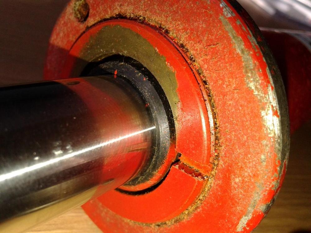

6 hours ago, dutchzcarguy said:
Actually this photo shows that you have one each of the early, older generation seals and guides (fronts) with integrated gland nut threading and the later design (rears) with the different guide, modern Viton seal and a separate gland nut.  What is interesting to me is that the 1980 date code on the newer design means that they must have started that conversion earlier than I'd thought.  Since there are no 40ish year employees left from those days before major computerization, there is little to no record keeping and archives showing exactly when things happened.  I'm pretty sure that happened over a period of time.
