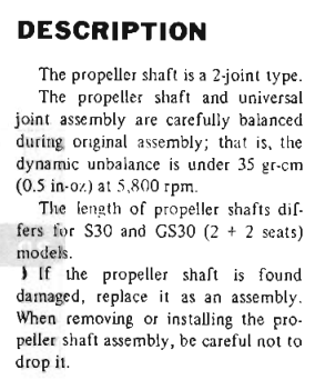

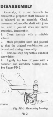

Nissan says that they should drop out with light tapping, after popping the snap ring off with a screw driver.

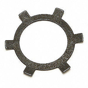

oops, forgot this was a junk yard find, don't recall the year. but its not staked, had the press in retainers. Would like to know where those could be found too, just in case the inside C clip types don't work out. the retainer look something like this
Doesn't look like factory Nissan parts.  Some shops will service the staked u-joints and use their own retention system.  You've got a weird one there.
