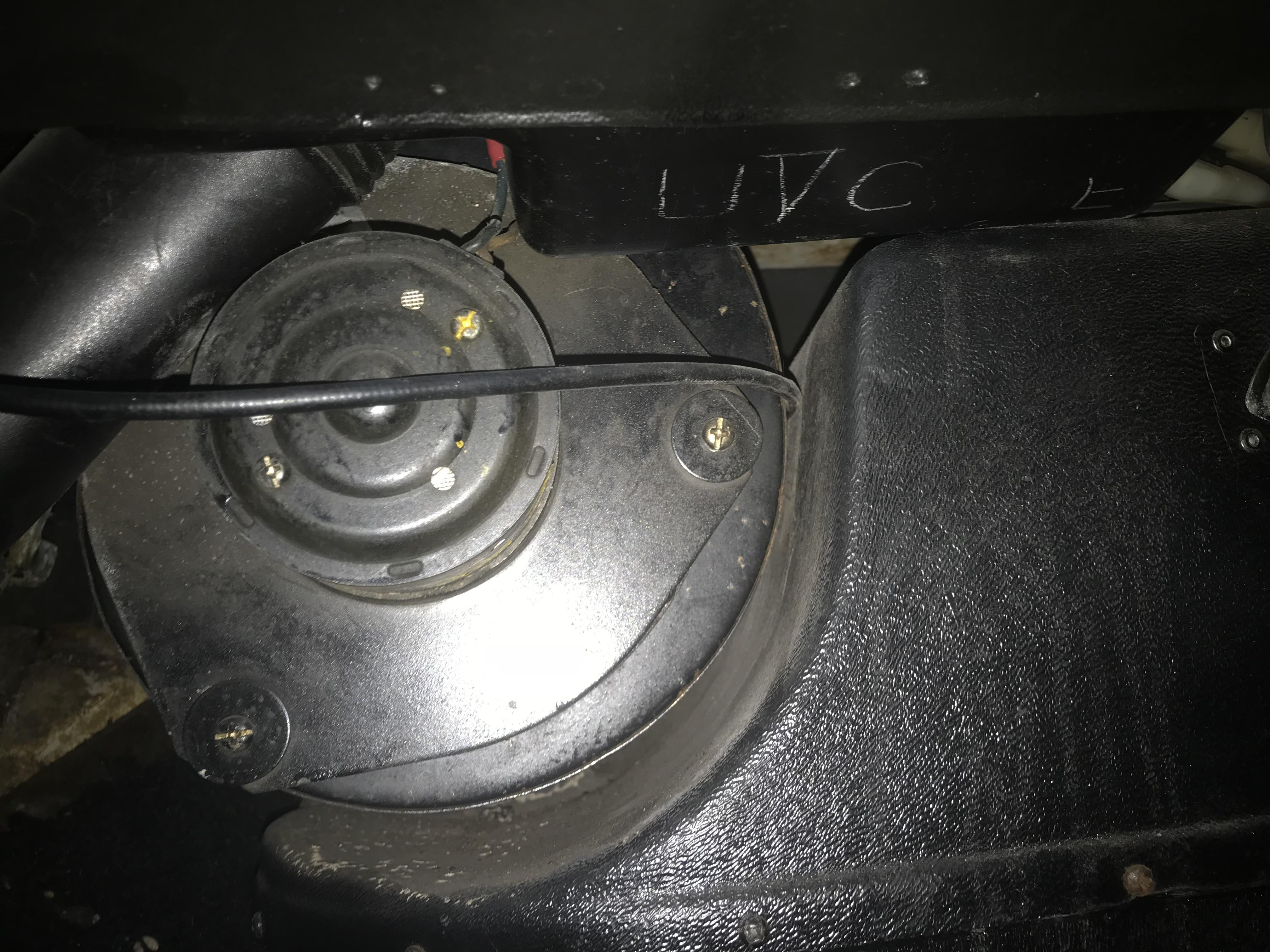

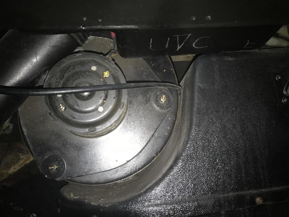

more info, picture
So when they added A/C, what does the oem fan (in the OEM heater box) do?  Is it still in play?
You're going to have to show pictures to clarify your car's situation, especially with the AC.  But typically with the stock version of the heater, you simply slide your controls to heat and hot and of course turn on the blower fan.  Hot air should only come out of the heater vents or the defrost, whichever is selected, not the center or side.  That is unless you have some other aftermarket kind and I am not familiar with any of those.  Someone with more V8 and 72' experience will probably chime in soon.  Good luck!

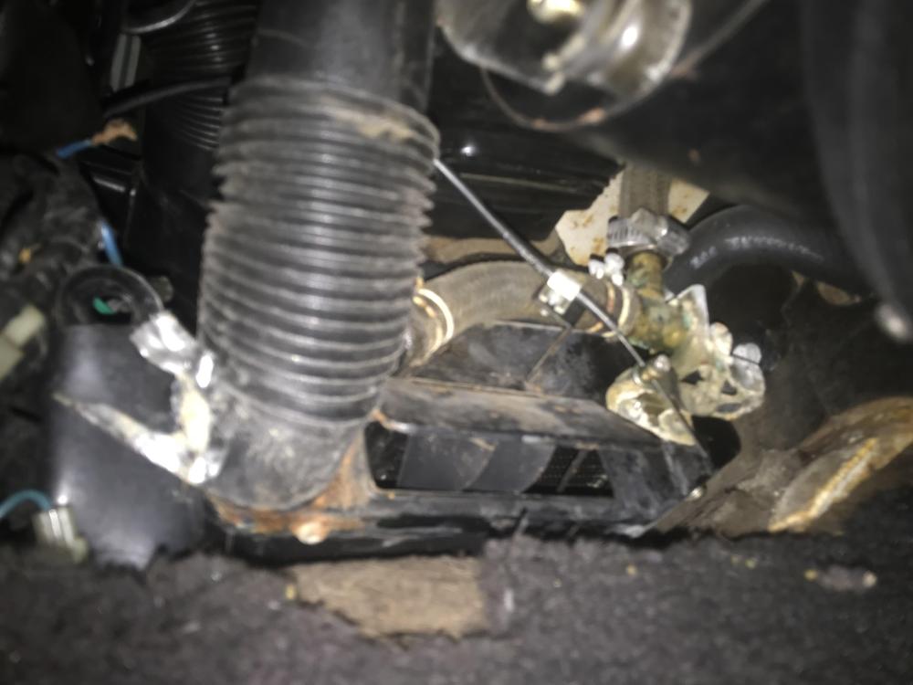

Yep, that's my question.  The A/C is aftermarket (they all in '72, or dealer installed, same difference I guess).  How would it typically work for the system to know which fan to run; heater box or A/C, or in the case of A/C does that install render the heater box fan inop? The fact it's got a V8 is irrelevant I would think. I just don't know how it is supposed to work "typically", I can trouble shoot from there once I know what it's supposed to be like ,then figure out the string of previous owner's and their hacks, then "fix" it my way. Here's the heater valve, FWIW
Edited by jvandyke
Hence the request for more pictures of your AC.  Under the dash, console controls and other side of the firewall to start.  That will show more info than trying to explain everything.  The folks on this forum are sharp and can pick out details that could solve your AC questions quickly.
okay, added the one other picture I currently have, will take more, the controls look stock '72 to me, the cable that runs to the AC and disappears behind, that one I don't know it's purpose, could be the culprit
On my '72 that cable pulls the valve open for heat.  Pushed all the way to the firewall is closed, no heat.
And if I remember right that cable that disappears pulls open a metal flap that is between the fan and the condenser.
Edited by siteunseen
The heater control valve cable I got a handle on, well it's pivot clamp is jammed so it doesn't work well from the controls but can be moved manually, so the valve is open, in theory, letting hot juice inside the heater core (in theory).  The one that disappears behind the A/C unit might be the problem then, if it's not closing then air is going to the condensor box and then the center and side vents, if closed it should re-route the air into the heater box and then to floor/defrost depending on setting, yes? sounds like I have to get back there and free it up, or at least force it closed for the fall.  These cars are fun to work on, I mean that sincerly, I love mess'n with my son's car.  The pay sucks though.
