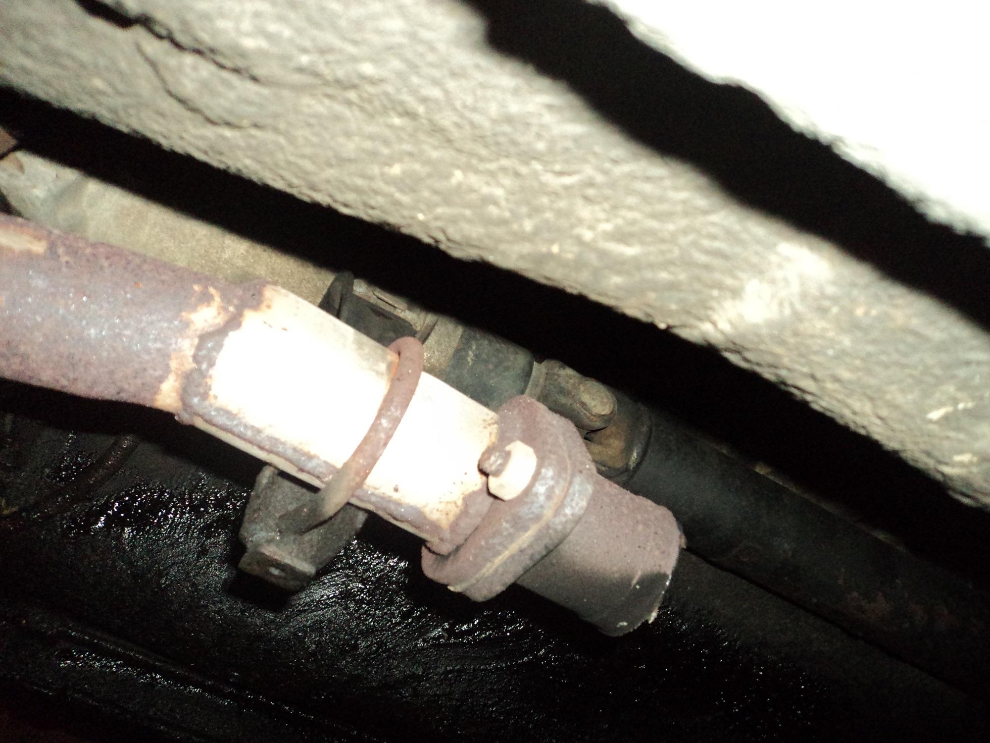

Anyways, as I was driving, I hit the accelerator pedal pretty hard, and then I heard clanking and it was loud, it was clearly dragging something.  Pulled over, and the whole exhaust had nearly fallen off the car, it was only being dragged under the car thanks the the rear hanger.

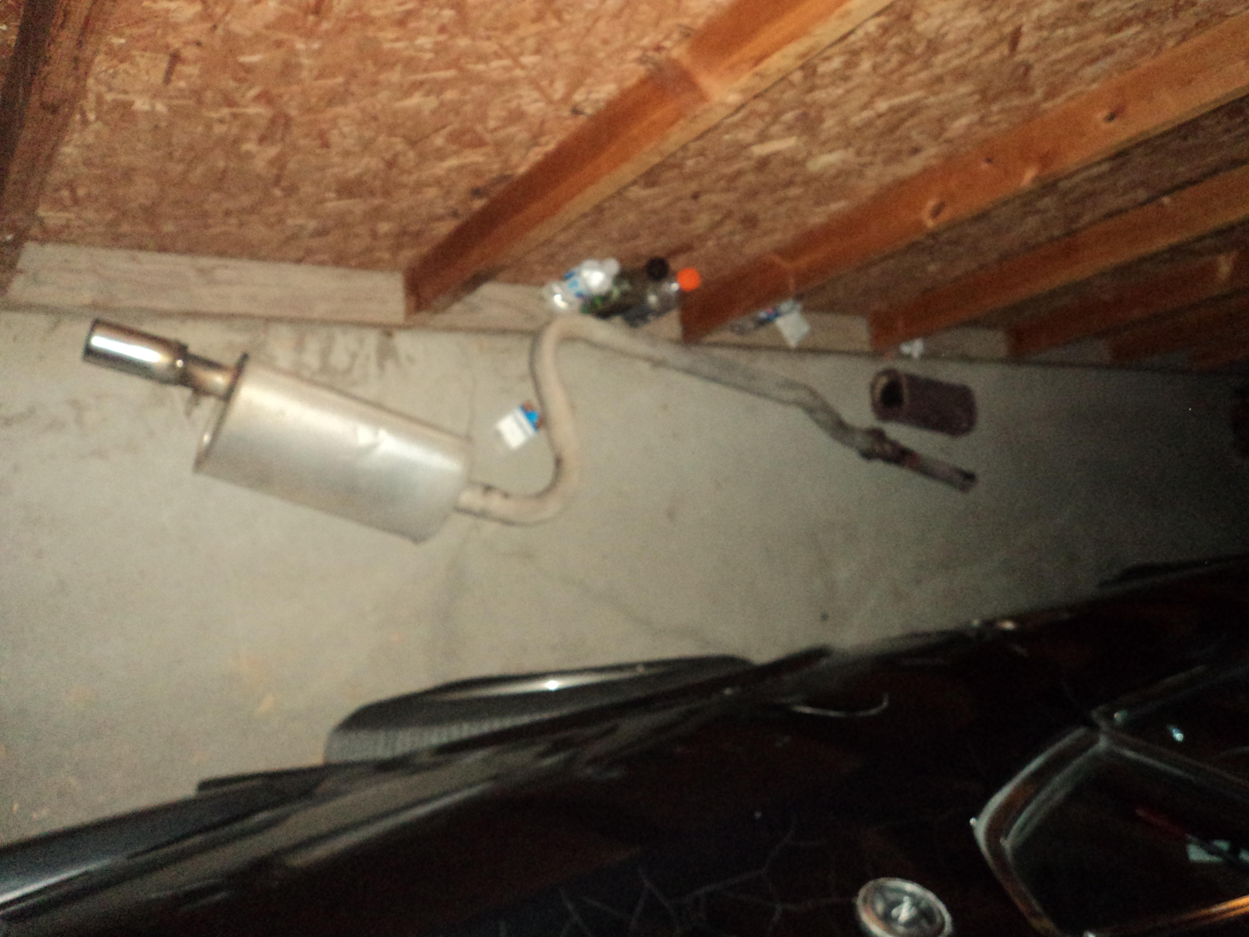

I took the hanger off, put the exhaust in my car, and limped home.  It was very loud.  I was lucky I had just tightened one of the hangers, or I'm pretty sure I would've ran over the exhaust and left it in the road... which would've been much worse lol!  Of course a cop was driving right next to me, but I was content knowing that my exhaust system was sitting next to me in the car, surely they would just warn me in that situation haha

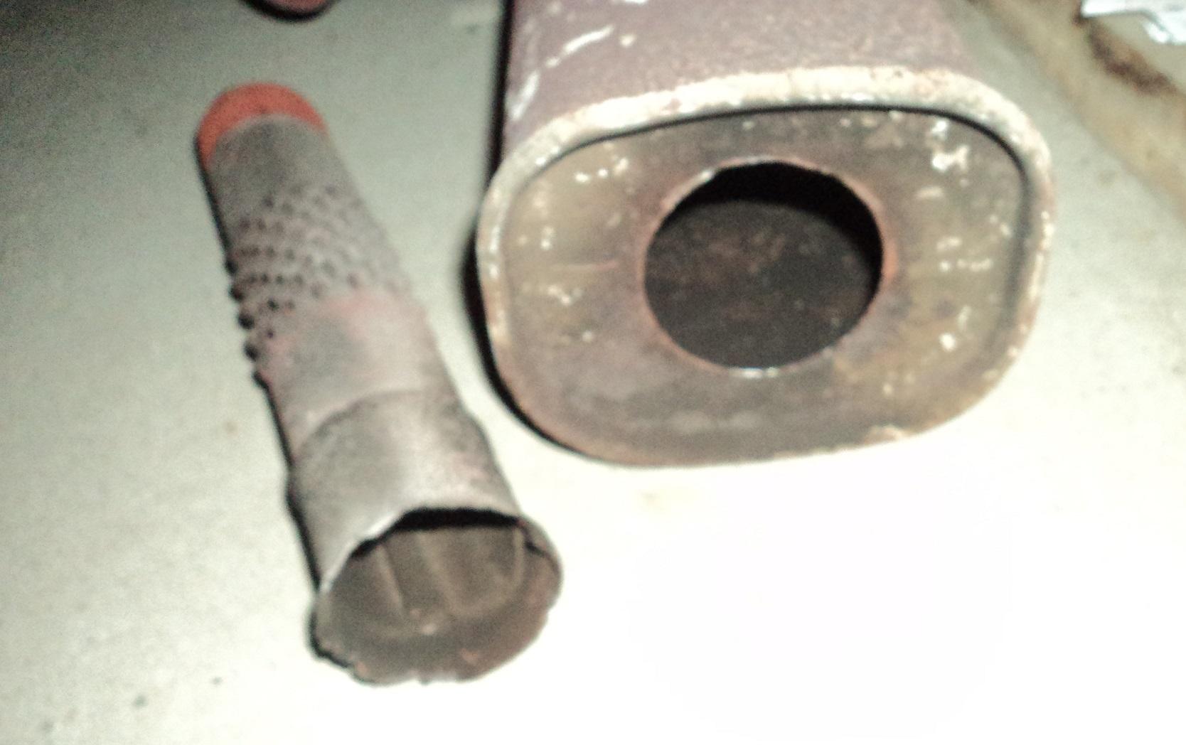

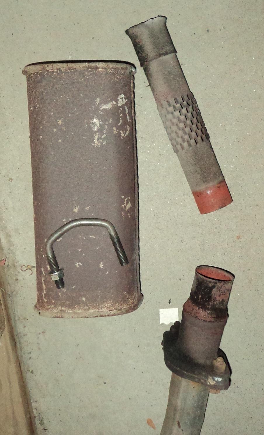

What happened is the weld at the resonator broke.  So what I have on my garage floor is the resonator and the pipe inside the resonator (which is now separated, due to the weld breaking) and the pipe that goes to the muffler, with the muffler still welded to the pipe.
I can re-use the pipe/muffler section just fine.  BUT the resonator is obviously done for: Unless I can weld it back together?  Anyone have a pic of their stock resonator?  I can't figure out which side has the protruding pipe?  I could have it welded at work.
I can either try to find and install a replacement resonator, which I can't seem to find?   Or some use a section of pipe or flex pipe from the parts store and clamp it together.  I mostly just don't want to run it  as is with the gas tank being right there where the exhaust is currently exiting.... BOOOM!
Any advice here?  I don't want to ruin the sound stock Z's have by not installing a resonator.  I don't care if it's a little louder, this just my fun project type car.  I also don't want to spend much, really just looking to keep it going as is, I'm happy with it.  What about some sort of glasspack? They're not too expensive.
Would replacing the resonator with a pipe ruin the sound/performance?
I also have presumably the entire winter to fix this, so I have time to consider the best options.

People use "glass packs" all the time to replace the resonator.  If you replace it with pipe you'll probably get drone.  Glass packs are pretty cheap.
If you post a picture of the damage we could probably tell you how to put it back together.

I think retaining some sort of pre muffler/resonator is the best option, might even improve the sound a tad.
Here are some pics I got showing what broke, and what is left under the car.

Went ahead and bought a Glass Pack from Jegs for under $20.  Had to use various exhaust fittings/clamps to get it in place (the hardware cost more than the glasspack....).
Only drove it once last fall after the glass pack, but it seemed fine, maybe a little bit of exhaust leak, but that could be from the broken manifold stud as well...
