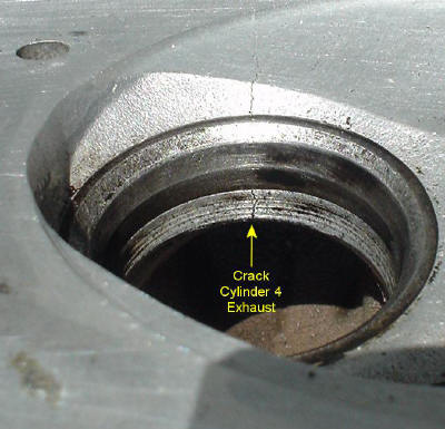

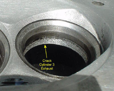

I had deposits on my 77 EFI on plugs 3&4. It was due to cracks in head.
The exhaust ports on 3&4 are the only two adjacent exhaust ports and heat builds there.
Maybe exhaust valve lash is too tight on 3 & 4allowing reversion.
Here is 3&4 exhibiting darker colour on cracked head (EFI):
Edited by 240260280

246's issue is similar.  Not clear how the cracks cause the fouling though.
