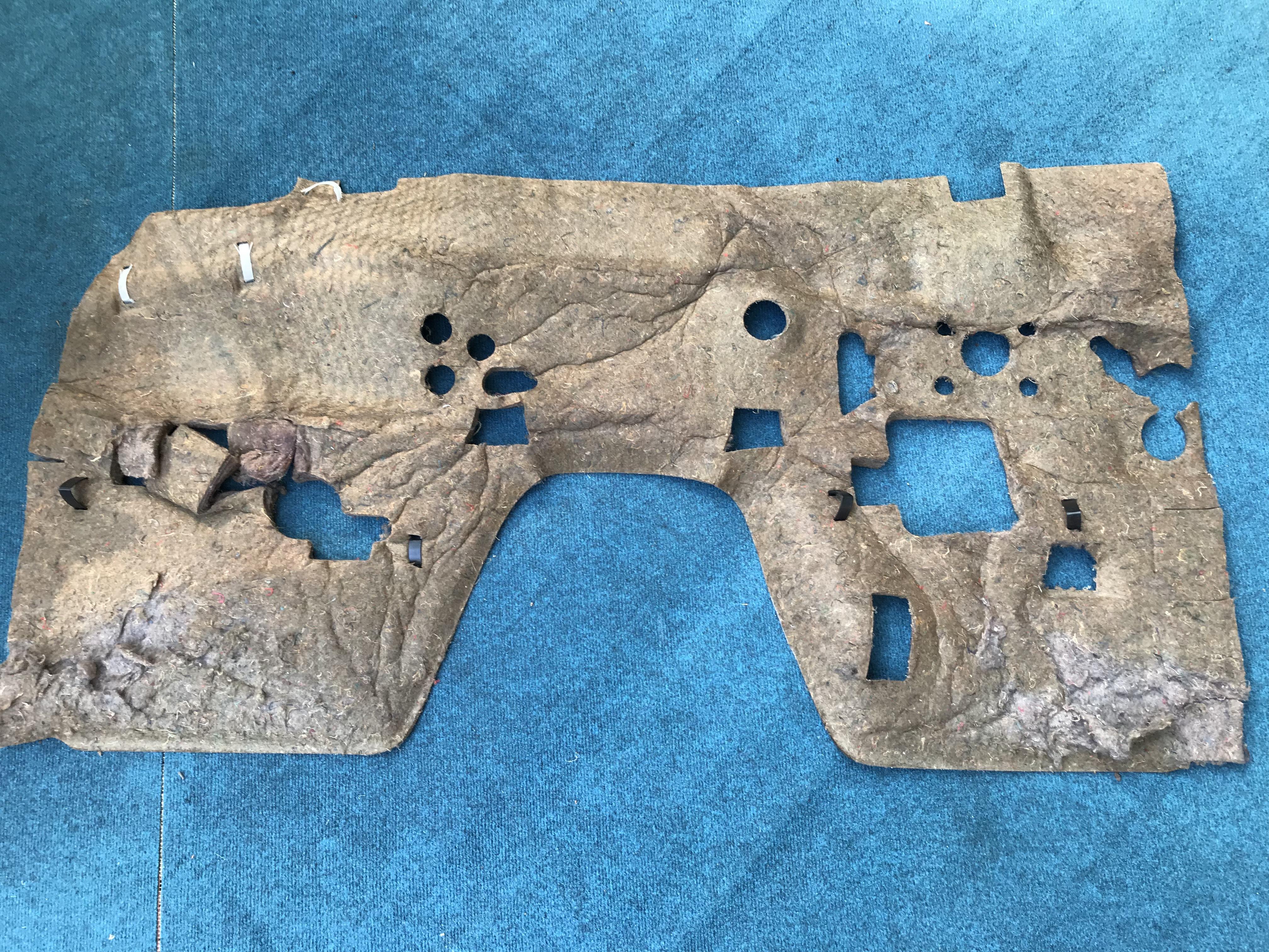

The firewall pad on my 1981 280ZX has been cleaned by a fire restoration company but still smells musty. I'm looking to replace it but I cannot find it anywhere. It has the normal insulation WITH a heavy rubber backing.
Does anyone know if there is a seller that has this kind of material in ROLL STOCK so I can just cut the holes myself and mold it to fit with my heat gun?
Also, I saw ZUP's post and photos about floor deadener material that he bought from a Porsche website. Like ZUP, I'm trying to bring my 280ZX back to original stock condition. Does anyone have other recommendations for floor insulation / sound deadener? Looks like there is some very thin tarry (sprayed) material on the floor (not in may places on the floor). I'm thinking about leaving them and painting over it before re-applying a new layer of deadener. I bought the car brand new in January 1981 so what I have found is ORIGINAL.

I found a vendor in California that sells firewall insulation for earlier Z’s and I’m working with them to see if I can just purchase the rubber base with the insulation in a roll. Then I can cut out the holes and heat-press the edges.

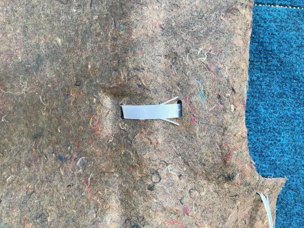

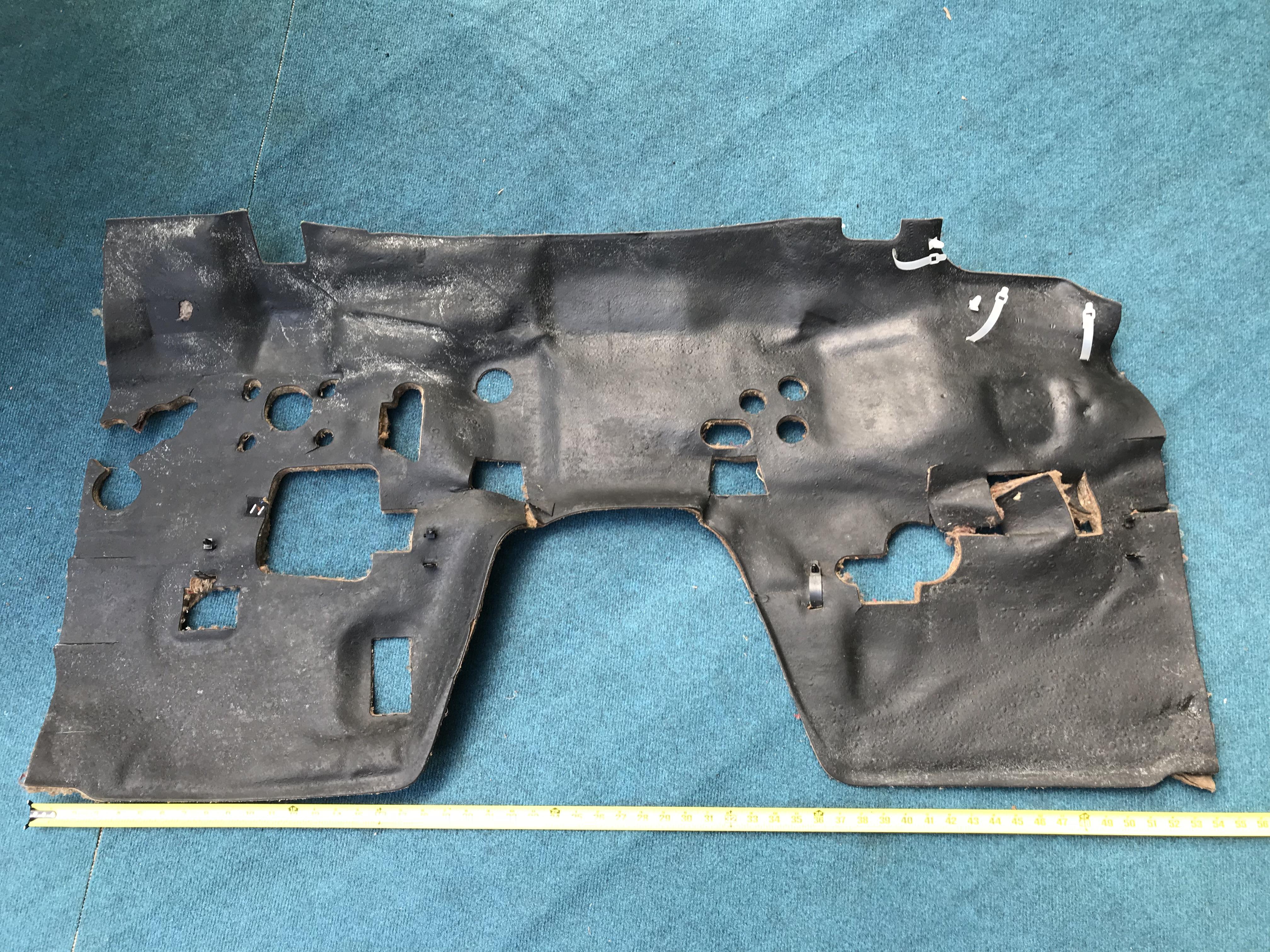

Photos of my smelly firewall insulation are attached. Both rubber side and insulation side.

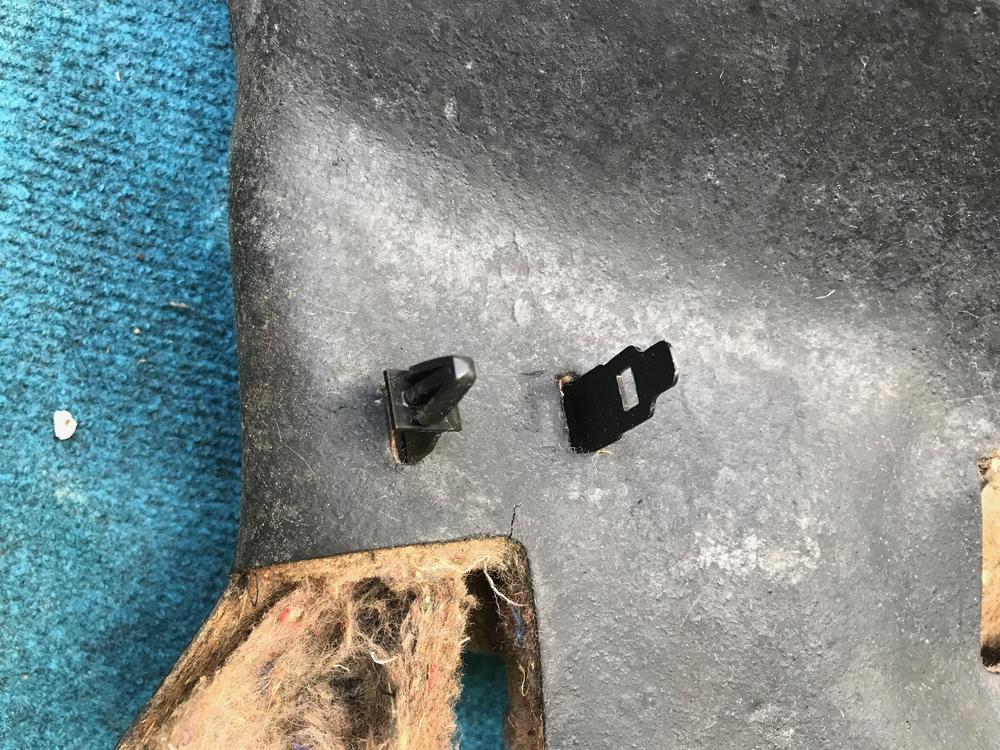

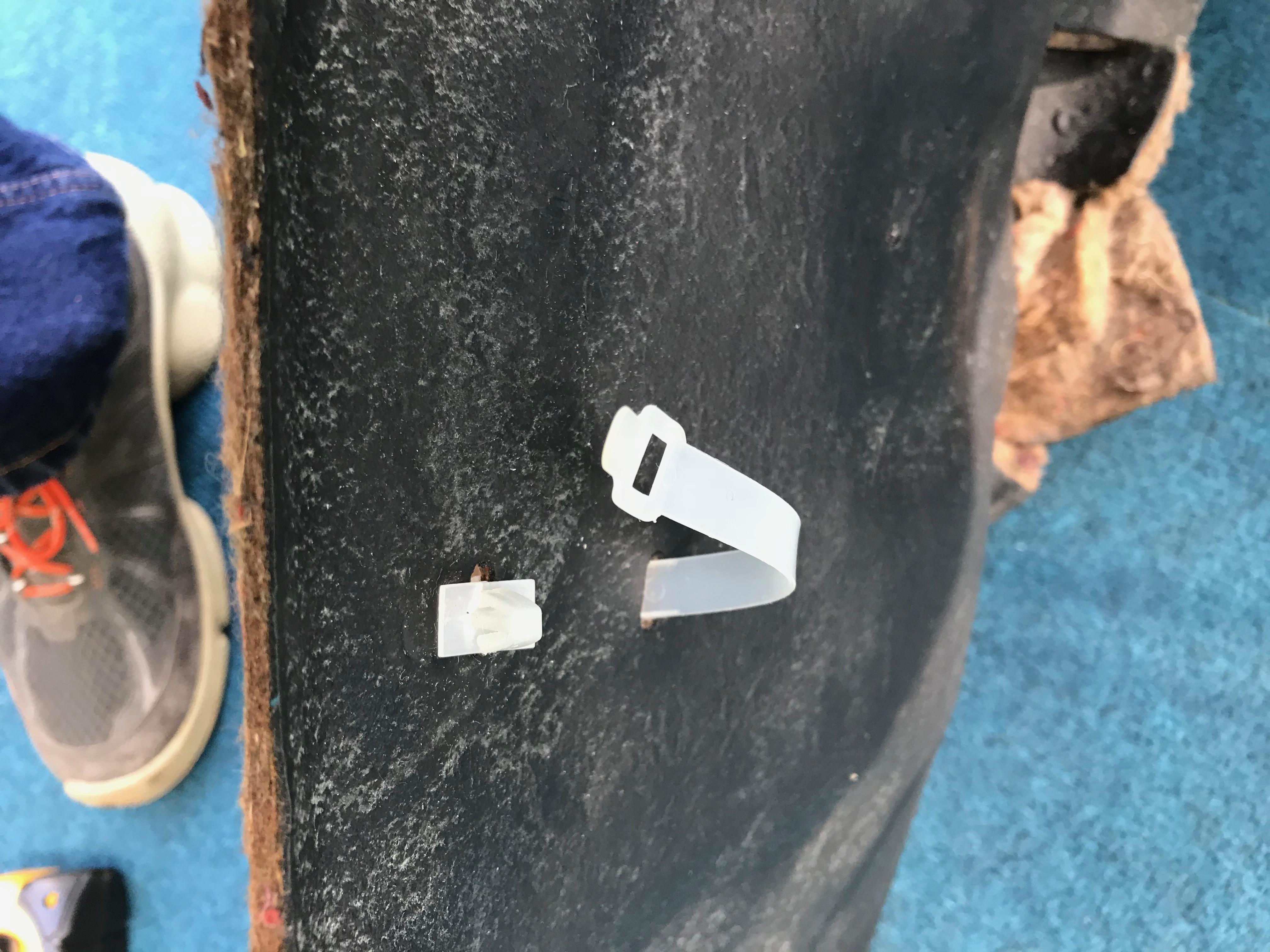

That would really be awesome! As long as it doesn't smell musty and stinky. There are some black clips and some white clips that stick through the engine wall (firewall) and clip to the engine side of the wall. They sort of look like these photos. I'm not sure how to arrange payment and shipping address since I've only been on this forum for a few months.

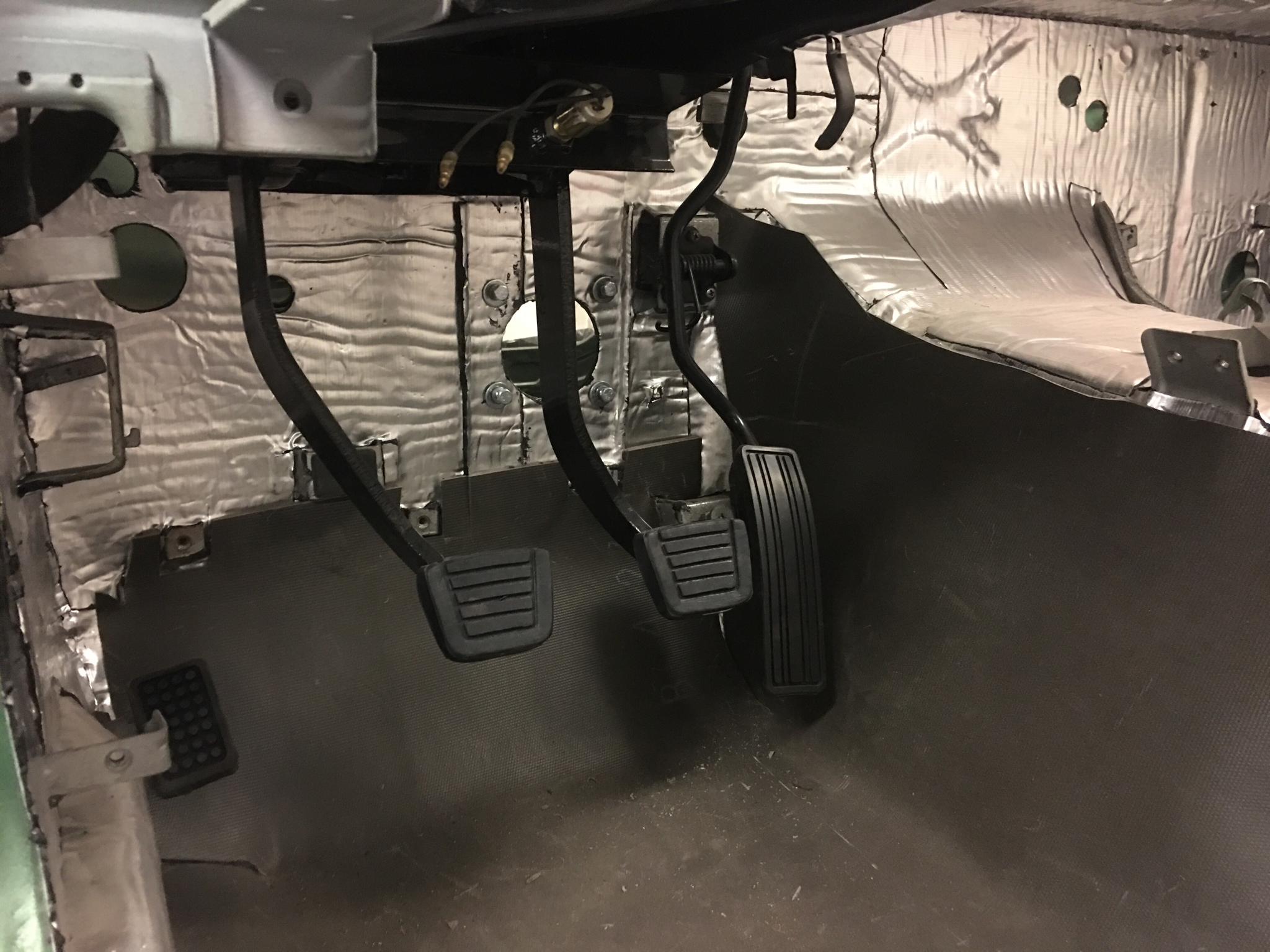

Glad to be helpful! I never did find authentic firewall material and I only have the B-Quiet ultimate product on there at the moment. Still not sure how I’m going to finish that area....
Hot diggity dog. There we go!
Where did you get this material from? Looks much easier to install.
Looks like it could be used on the floors, too.

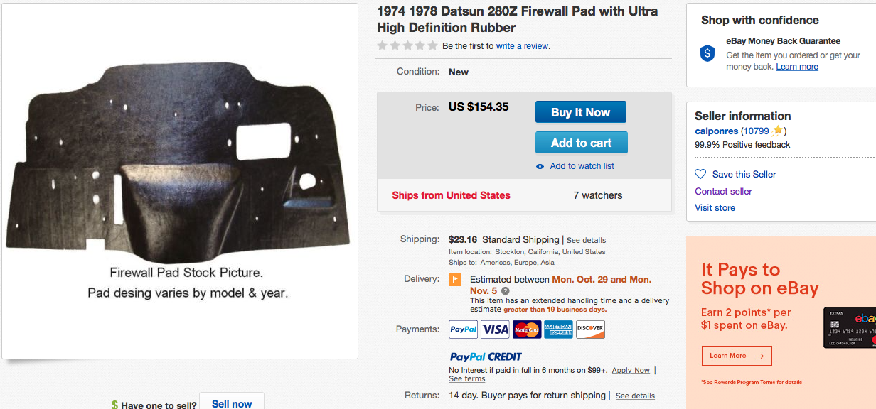

I found a company in California that might be able to get  similar genuine  firewall material in roll stock. Its a store that sells restoration parts for Pontiacs. I found an ad on their site showing a firewall for "1974 1978 Datsun 280Z Firewall Pad with Ultra High Definition Rubber" and I am in the process of seeing if this material is available in ROLL STOCK. Crazy thing was this posting was on a California Pontiac Restoration site on EBAY that I can't specifically remember the name but I will let you know! Copy what I have in quotes and do a search on eBay. See the post that I found.
