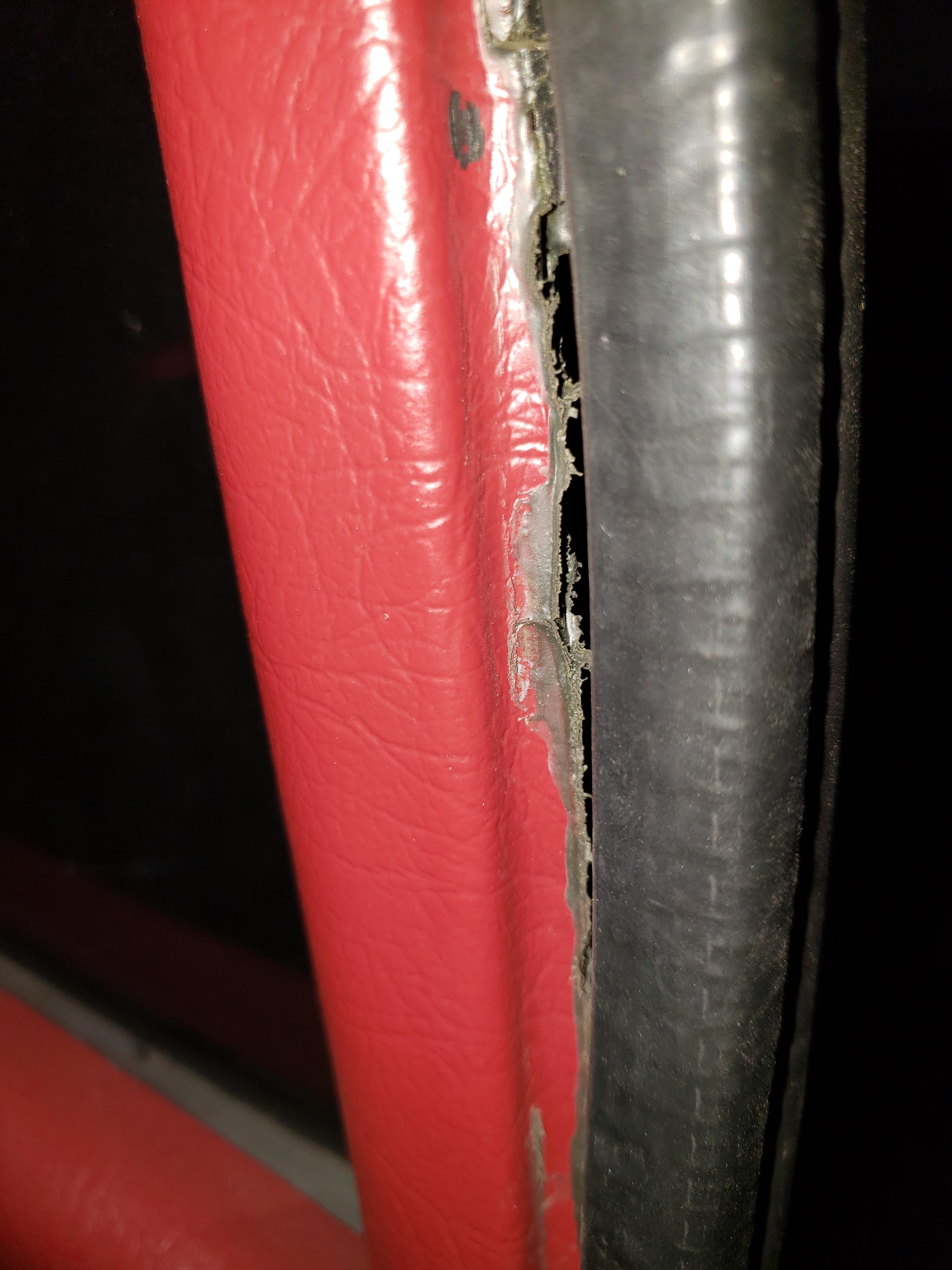

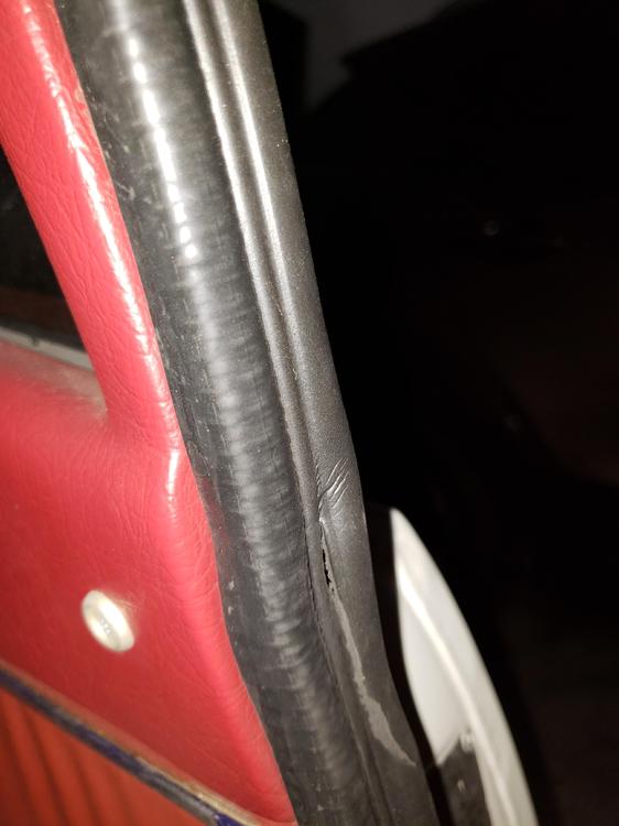

Anyways i will take some pictures of the damaged weatherstrip due to sloppy installation after painting the car.
