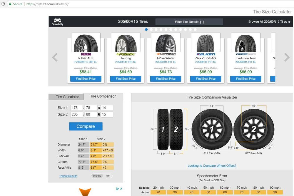

You don't have to measure your tires per se. You just have to get the sizes off the sidewalls. (Note, that it has been pointed out in a different thread on this board that the wheel diameter can vary even with the "same" tire size.)
Assuming that we're starting with a stock 175 R14 tire, I used 175/78R14 as the size. (Google is your friend.)
You want a 15 inch wheel (There are not many good choices at Tire Rack, but if you don't mind the road noise, Advans  are available.).
This gives you available tire size (at Tire Rack) for 15 inch wheels: https://www.tirerack.com/tires/sizes/results.jsp?diameter=15

A little more digging revealed this size chart at Tire Rack: https://www.tirerack.com/tires/tiretech/45_conversionchart.jsp
If the OP wants 15 inch wheels, the 205/60R15 should give a comparable tire size and not much speedometer error with the actual speed a little lower than the indicated speed.
