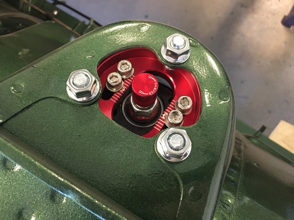

why would you want to ruin your strut tops!?
Lets hope I don’t. We’ll start with just lowering via coilovers.
Who says you need to ruin them?

^ Must be nice to have a portable laser cutter ?
Seriously. How did you cut those out so nicely. Will you do mine? :beer:

^ Must be nice to have a portable laser cutter [emoji106]
Ha! I used a drill and a rotary tool with steel cutting head to do that. Granted I started with raw metal them primed and painted afterwards..., but still done by hand.
When I suggested slotting the tops I had in mind that one would weld in the plates once one had enough money to do so. You would need some form of camber bushings (front and rear) to make that work but those are cheap as opposed to a full suspension upgrade.
We ran -3 degrees using this method before welding in TTT plates and adjustable control arms. Granted this was a race car and overall looks were not important.
Those done by Mark are very, very pretty. Nice work.
that as neat as i've ever seen it done.
Well. I might not need coilovers after all. Let’s see how this goes.
