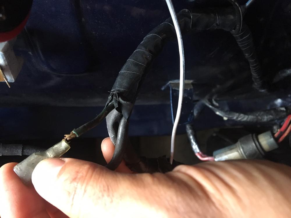

The way I looked at mine was v simple: eliminate every possible electric cause.
I changed:
the plugs in case one had a crack
The dizzy cap and rotor
The coil
The wires to the coil by running direct from battery (fused of course) temporarily.
Spark plug leads.
Also
Checked and cleaned up engine earth strap
Replaced a couple of connectors - see this one that was holding by a single strand you can see coming out of the connector.
Did each one at a time until I found the culprit - and I would say there were two issues in the HT leads and a potential other in the low tension connectors.
Bear in mind I had rough running and backfire at revs and when on power and missing visible on timing light. So given my experience I would say your problem is electrical in nature not advance related.
Good luck buddy.

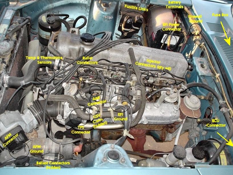

Ill check those connectors. Which ones should i specifically check?

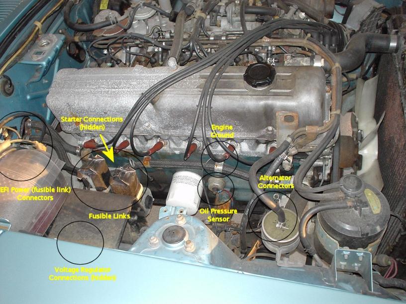

Which grounds????

Could i be missing a ground strap somewhere or any kind of ground causing the plugs to foul at idle?20181004_201413.jpg

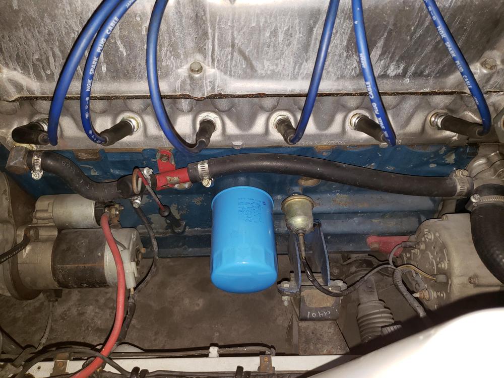

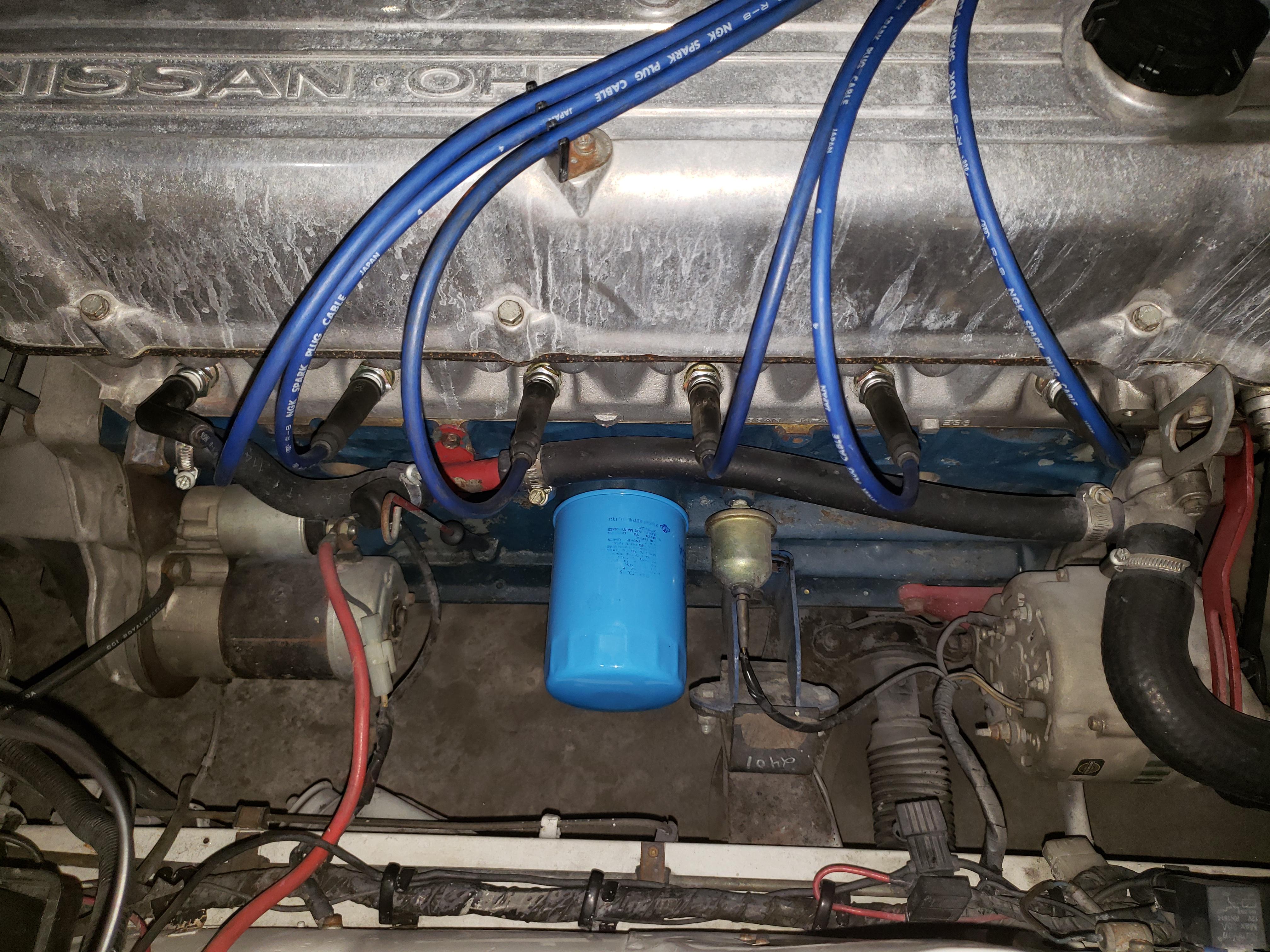

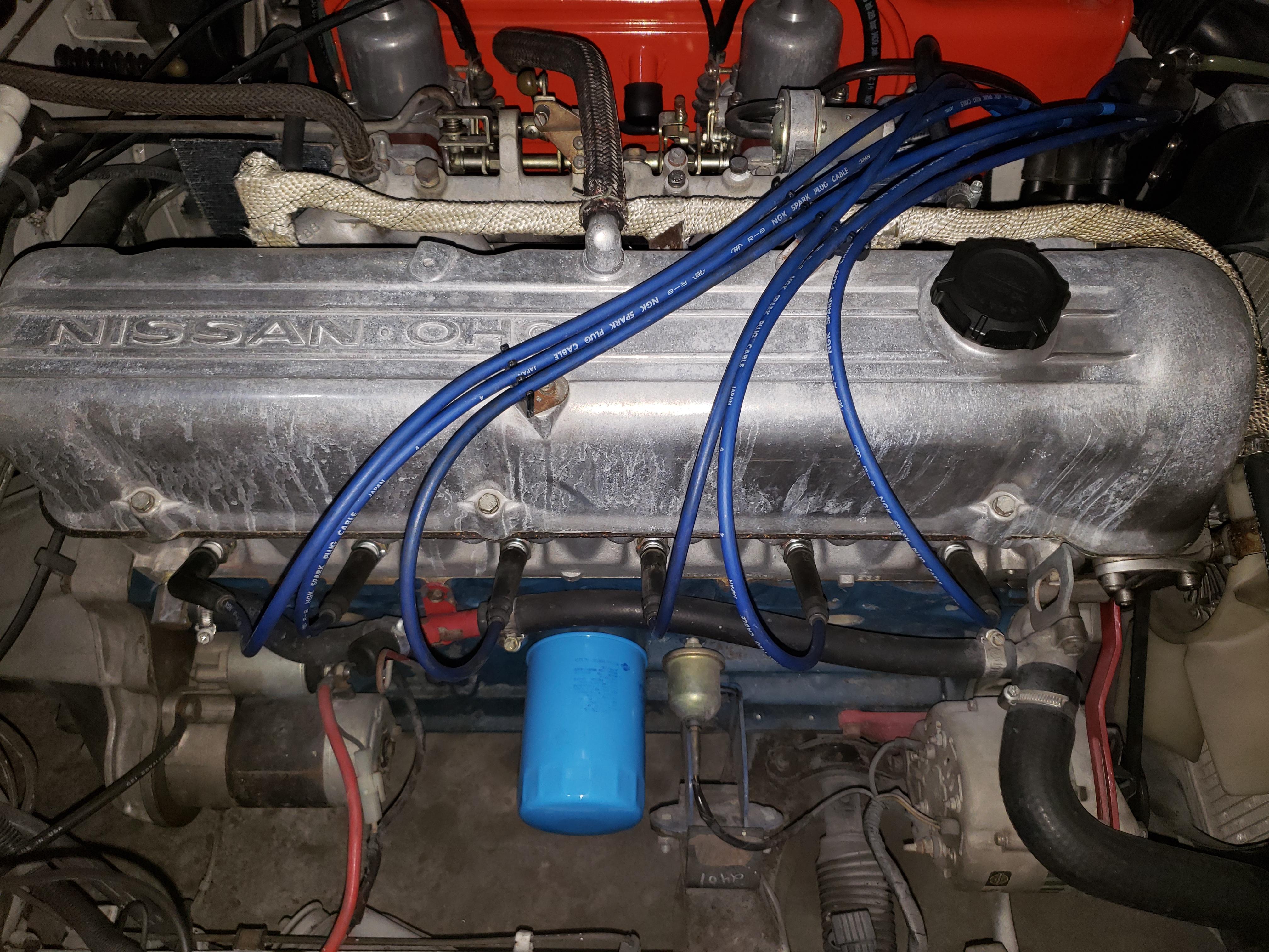

Went for a drive and once back left the car idling for 15 mins. This was the result. I did swapped plug leads 5 with 4 and 2 with 3.
Order is 6 5 4 3 2 1
