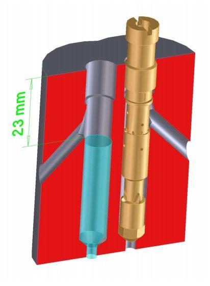

Overflowing fuel bowls is usually too much pressure from the pump.  It causes the fuel levels in the bowls to rise and the fuel easily runs down the pipe to the Aux Venturi.
Another reason to set fuel level 27mm to 30mm down rather than the internet myth of 25mm down (unless you run an old 4cyl Lotus it seems).
Once fuel sloshes to 23mm up, it pours into the throat of the carb.
