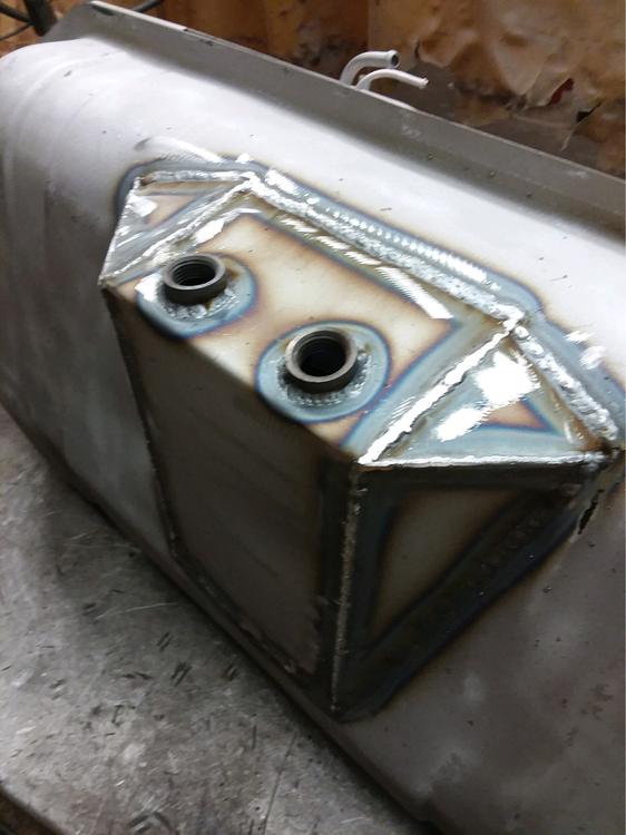

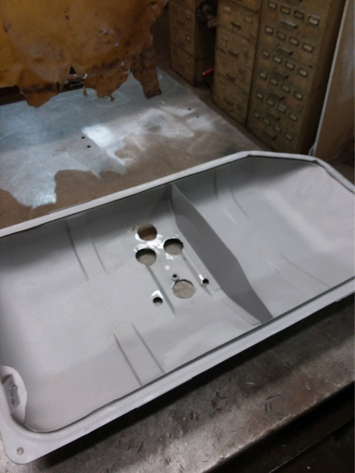

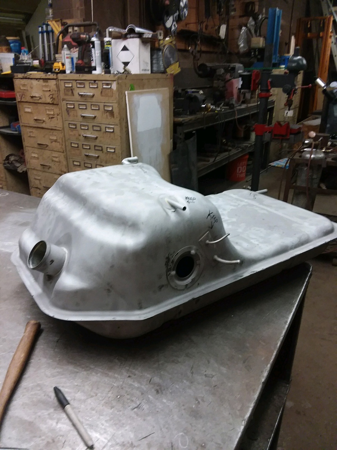

Posted April 20, 20187 yr comment_547719 Question. Sent my tank in to get a cleaning and reseal and now im adding a sump & baffles and things are just getting out of hand because I’m not familiar with what to delete and keep regarding lines from the tank. 240z tank 280zx turbo swap. With the new sump do I tell him to delete the factory lines from the tank ? Sent from my iPhone using Classic Zcar Club mobile Link to comment https://www.classiczcars.com/forums/topic/59900-240z-sump-install/ Share on other sites More sharing options...

April 20, 20187 yr comment_547724 People often run in to problems when they start deleting stuff the factory installed. Even the emissions lines have the benefit of containing the smell of gasoline. I'd try to get them all back to where they were, unless it's a race car. Link to comment https://www.classiczcars.com/forums/topic/59900-240z-sump-install/#findComment-547724 Share on other sites More sharing options...

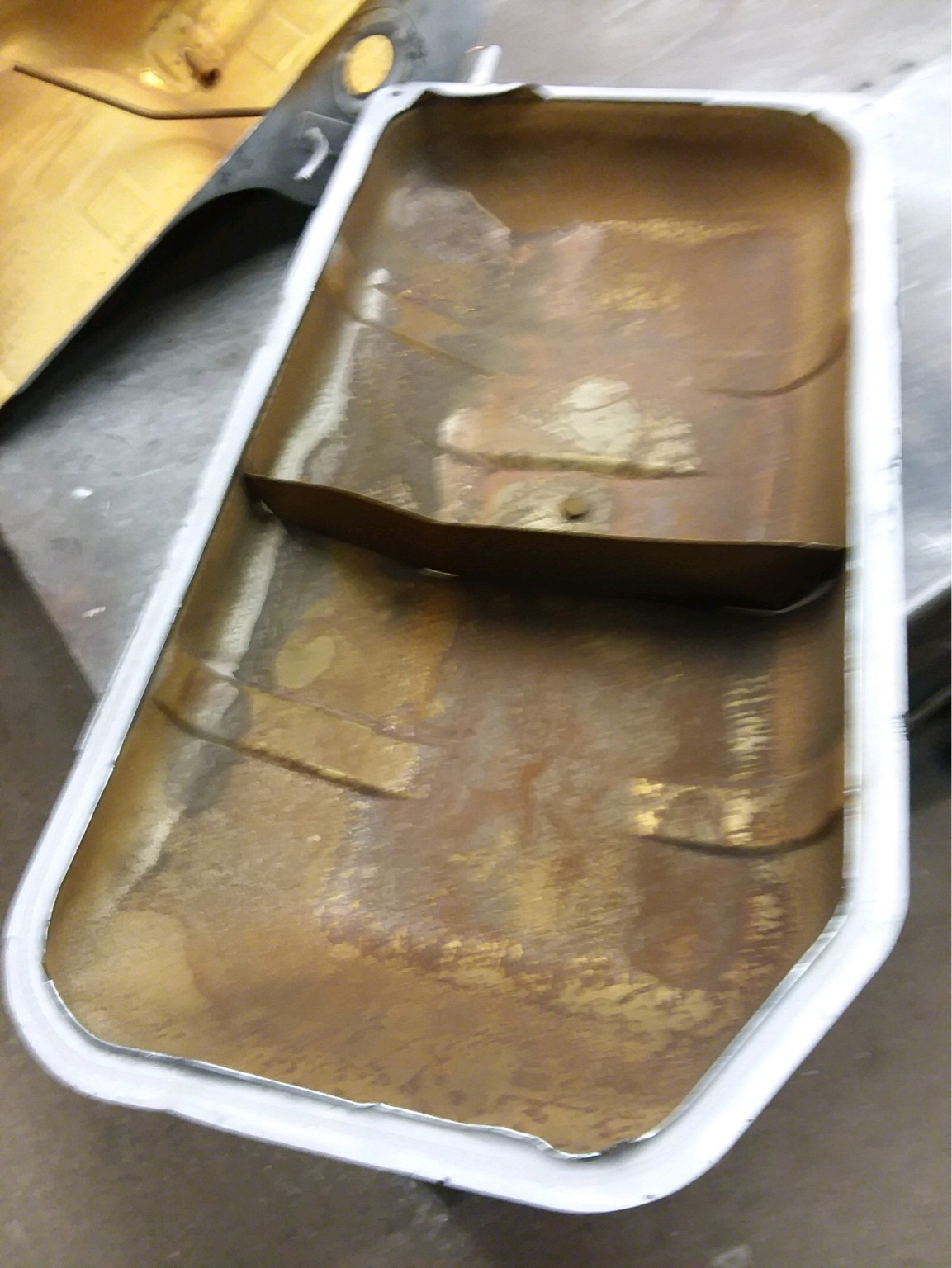

April 20, 20187 yr comment_547733 You might want to leave all of them and find out as you reassemble which ones you need, the rest can be plugged before you install the tank. t Also, just wondering how your guy managed to get the two piece shell apart without cutting any metal on the seam? Link to comment https://www.classiczcars.com/forums/topic/59900-240z-sump-install/#findComment-547733 Share on other sites More sharing options...
April 20, 20187 yr comment_547737 3 hours ago, grannyknot said: You might want to leave all of them and find out as you reassemble which ones you need, the rest can be plugged before you install the tank. t Also, just wondering how your guy managed to get the two piece shell apart without cutting any metal on the seam? I agree, I wouldn't delete anything. The old pickup is probably redundant but you may end up wanting all the vapor points. You also need to be careful you have a known, functioning way to allow air to enter the tank not leave. If you run the tank with too much vacuum it will collapse. Not an issue with carbs at 3 psi but with EFI with high pressure it can happen. I suspect that is one reason the later tanks are much thicker. It looks like he cut the tank just about the tank flange Link to comment https://www.classiczcars.com/forums/topic/59900-240z-sump-install/#findComment-547737 Share on other sites More sharing options...
April 20, 20187 yr comment_547757 9 hours ago, Patcon said: It looks like he cut the tank just about the tank flange Yes you're right, that's exactly what he did then placed it back on top and stitched it together, thanks. Link to comment https://www.classiczcars.com/forums/topic/59900-240z-sump-install/#findComment-547757 Share on other sites More sharing options...
