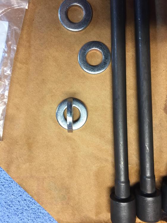

April 28, 20187 yr comment_548154 2 hours ago, siteunseen said: I replaced mine because they had lost the "cup", flattened out. I'd read cupped side down and couldn't tell on the old ones. I was un-aware they were cupped to start with! as you can imagine, I have quite a few laying around and none exhibit any cup-ish-ness. Can't imagine why they would want them to be cupped, I would think that would consume a good part of the torque you're putting on the bolts or some such. I'm confused. again.... Link to comment https://www.classiczcars.com/forums/topic/59852-new-head-install-question/?&page=3#findComment-548154 Share on other sites More sharing options...
May 11, 20187 yr Author comment_549144 On 4/28/2018 at 3:59 AM, siteunseen said: I replaced mine because they had lost the "cup", flattened out. I'd read cupped side down and couldn't tell on the old ones. Attached photo of my new ones from Nissan Link to comment https://www.classiczcars.com/forums/topic/59852-new-head-install-question/?&page=3#findComment-549144 Share on other sites More sharing options...
May 11, 20187 yr Author comment_549145 Finally picked up the parts from the dealer. Link to comment https://www.classiczcars.com/forums/topic/59852-new-head-install-question/?&page=3#findComment-549145 Share on other sites More sharing options...
May 11, 20187 yr comment_549147 Thanks for that. I work on a lot of stuff, make mistakes sometimes. At least I could provide the correct part numbers. Link to comment https://www.classiczcars.com/forums/topic/59852-new-head-install-question/?&page=3#findComment-549147 Share on other sites More sharing options...
May 13, 20187 yr comment_549231 On 5/11/2018 at 2:49 PM, siteunseen said: Thanks for that. I work on a lot of stuff, make mistakes sometimes. At least I could provide the correct part numbers. Cliff, @siteunseen I am sorry to correct you but you are actually correct. The original head bolt washers have a smooth edge on the top side and a sharp edge on the bottom side. Got your back! :) Link to comment https://www.classiczcars.com/forums/topic/59852-new-head-install-question/?&page=3#findComment-549231 Share on other sites More sharing options...
