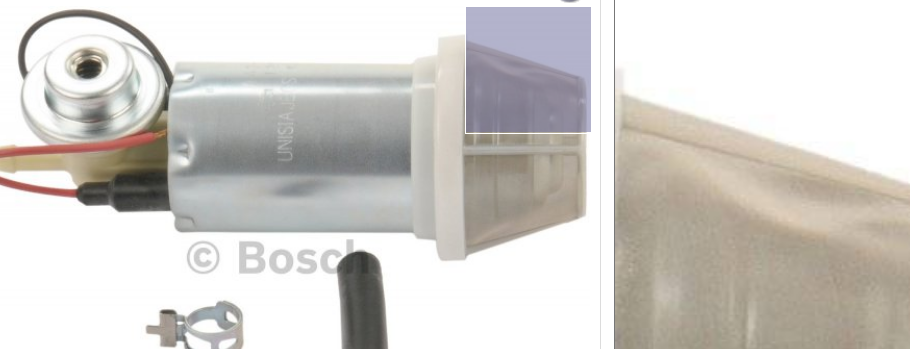

Went out and found a picture of a 1986 300ZX intank pump with the screen encapsulating the pickup area.  https://www.rockauto.com/en/catalog/nissan,1986,300zx,3.0l+v6,1209563,fuel+&+air,fuel+pump,6256
It's what people should try to be replicating, or be trying to replicate (grammar lockup in my brain,) if they poke a hole in their in tank sock.  Don't know the specs but there's a lot of surface area.
