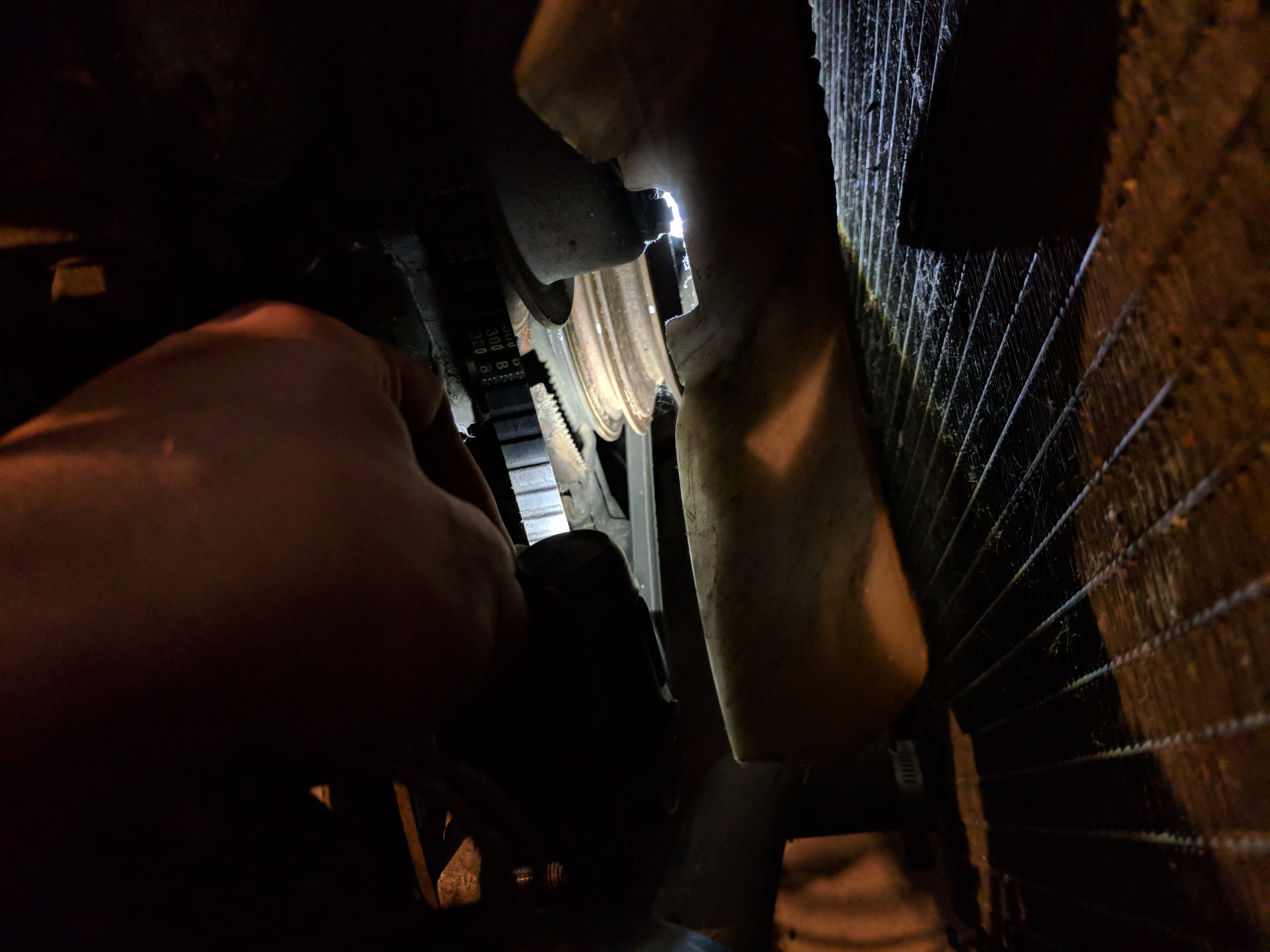

I dug into it a little further and set my #1 cylinder to TDC (utilizing the wife+stick+flashlight method), and then checked the marks on the block and the distributor arm position.  It doesn't seem like things are lining up as they're supposed to.  The mark on the pulley is somewhere in the range of -15deg, when (in my limited understanding) its supposed right around the 0deg mark.  The distributor seems to be past the #1 point, and I was under the impression it should be right at the #1.
I really don't trust anything in this car, so my next inclination is to pull the valve cover and make sure the cams are in the right spot as well for a third check.
Or am I totally missing something obvious here.  Whats the next step?  Picture attached of the notch/marks on the block with the #1 at TDC (marked the pulley with a silver marker at the tick).  Thanks!

Do you have a timing light? It would be easier to crank the engine, check the timing and set it to 5 degree btdc. I say 5 because cranking speed is about 300 rpm and lower than idle speed. You can adjust it properly when it runs.

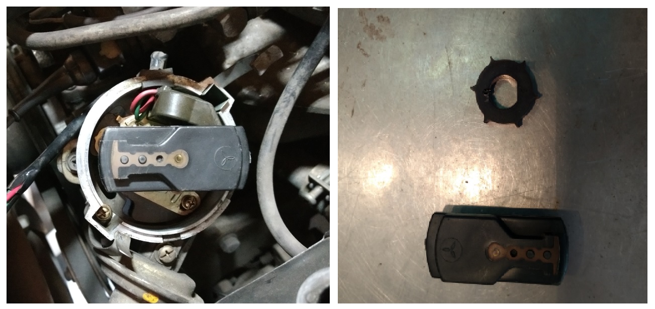

The rotor button gives a reasonable indication that the timing is in the right area, but the pickup coil under the rotor button is the before indication. One of the pointer of the 6 pointer star (reluctor rotor) under the rotor button should line up with the pick up coil or a fraction past it.

What should the indications on the block look like if #1 is TDC?

TDC should be at the top of your timing plate. The plate has timing makes from 0 to 20 degrees btdc. If you crank the engine, adjust the timing to somewhere in the top section of the plate. Once you start the engine, you can adjust if properly.
Just lining up the rotor button is not very acurate. The rotor has a "phasing" function because it has to transfer spark through a wide range of advance (from 8 up to 36 degree of advance).

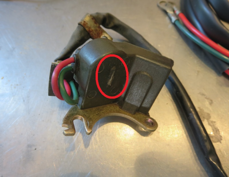

If you do try to manually adjust the distributor (enough to start the engine). Line up the rotor button with number one spark plug terminal, remover the button and then adjust the distributor until the reluctor rotor fractionally passes the reluctor (see red circle in third photo). The metal strip in the reluctor is what you should line up. It is not very acurate, but it will be enough to get it started.

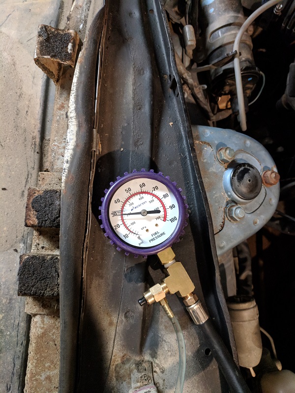

My fuel pressure while at idle when running was only about 28psi (picture below).  That being said, it idled smooth and was responsive and revved fine.  Is the fuel pressure supposed to stay at 38 or so while it is running?

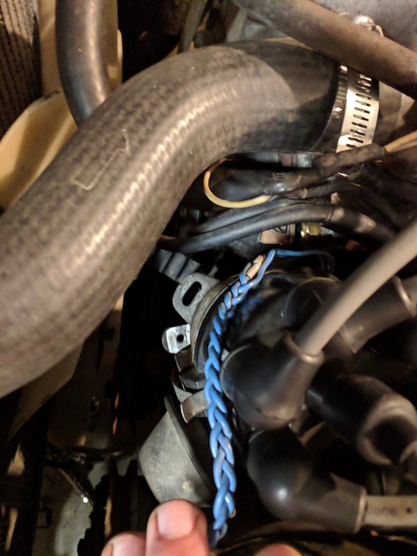

My distributor cap required a significant amount of adjustment (picture below) to get it to run properly.  I'm assuming whoever installed the distributor didn't align it correctly?  I'm thinking if I just advance the spark plug order 1 plug and then grab a timing light I'll be able to get the timing set.

You might be okay with moving the plug wires one over.  Worth a try.  That's pretty far off but it looks close to 60 degrees, which would be one wire spot rotation.

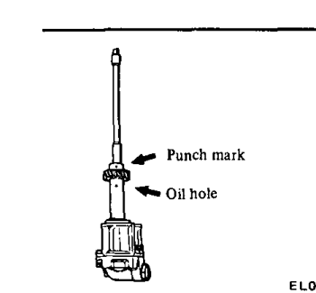

With the Datsuns it's the oil pump and distributor drive quill that is out of adjustment.  Once the oil pump is installed the drive quill, or shaft, is locked in to place on the crankshaft gear that turns both the oil pump and the distributor.  (Never really put the whole picture together before).  The oil pump is below and the distributor above, but they both get their energy from that long spindly shaft.
So what you're really seeing is a function of how many teeth off the the drive quill is, to the crankshaft drive gear.  That's why people use vise-grips or rubber bands to hold it in proper spot , before matching the oil pump to it, to get the distributor right.  The oil pump doesn't care, but the distributor does.  Also why there's no "180 off".  We could count the teeth on the gears and come up with the various points of "off".  I'm surprised we haven't done that yet.
