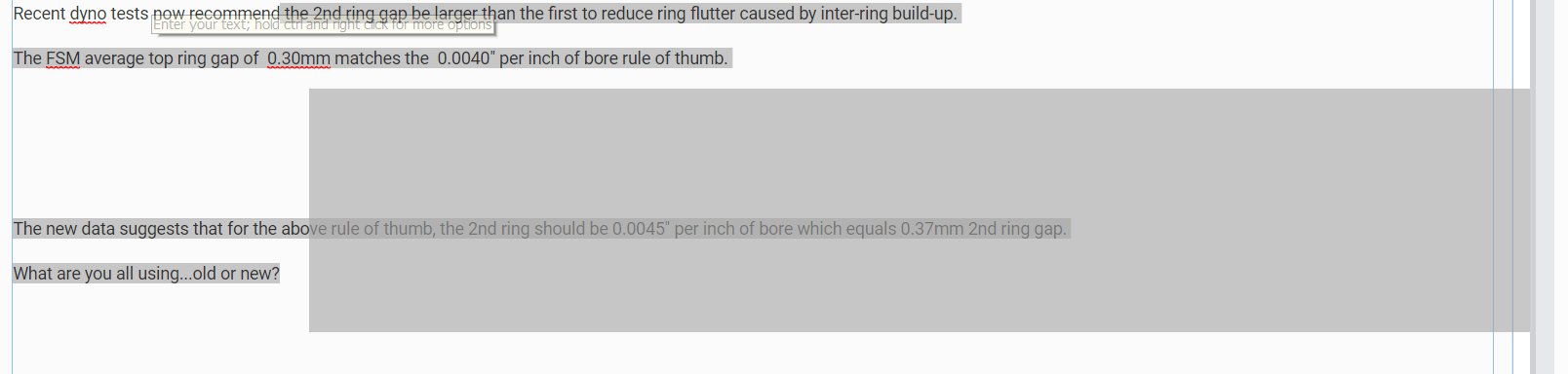

Check out the invisible ad that showed up when I copied some text to delete it.
