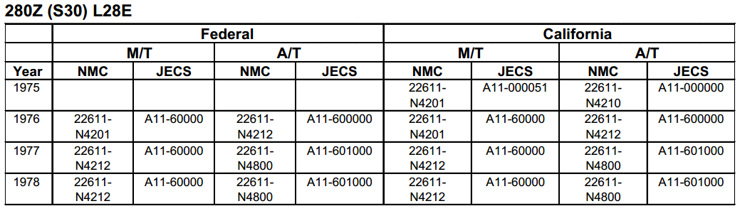

You may want to do some research on part number cross ref to year, and make sure you have the right ECU for your model year. I seem to recall there are differences on pin out.
Great idea Dave!

4 hours ago, 240260280 said:
Great idea Dave!
I do have the A11 600 000 for federal manual 1976 cars
And my injectors are green, so I would guess they are correct
